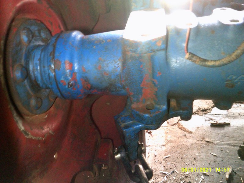

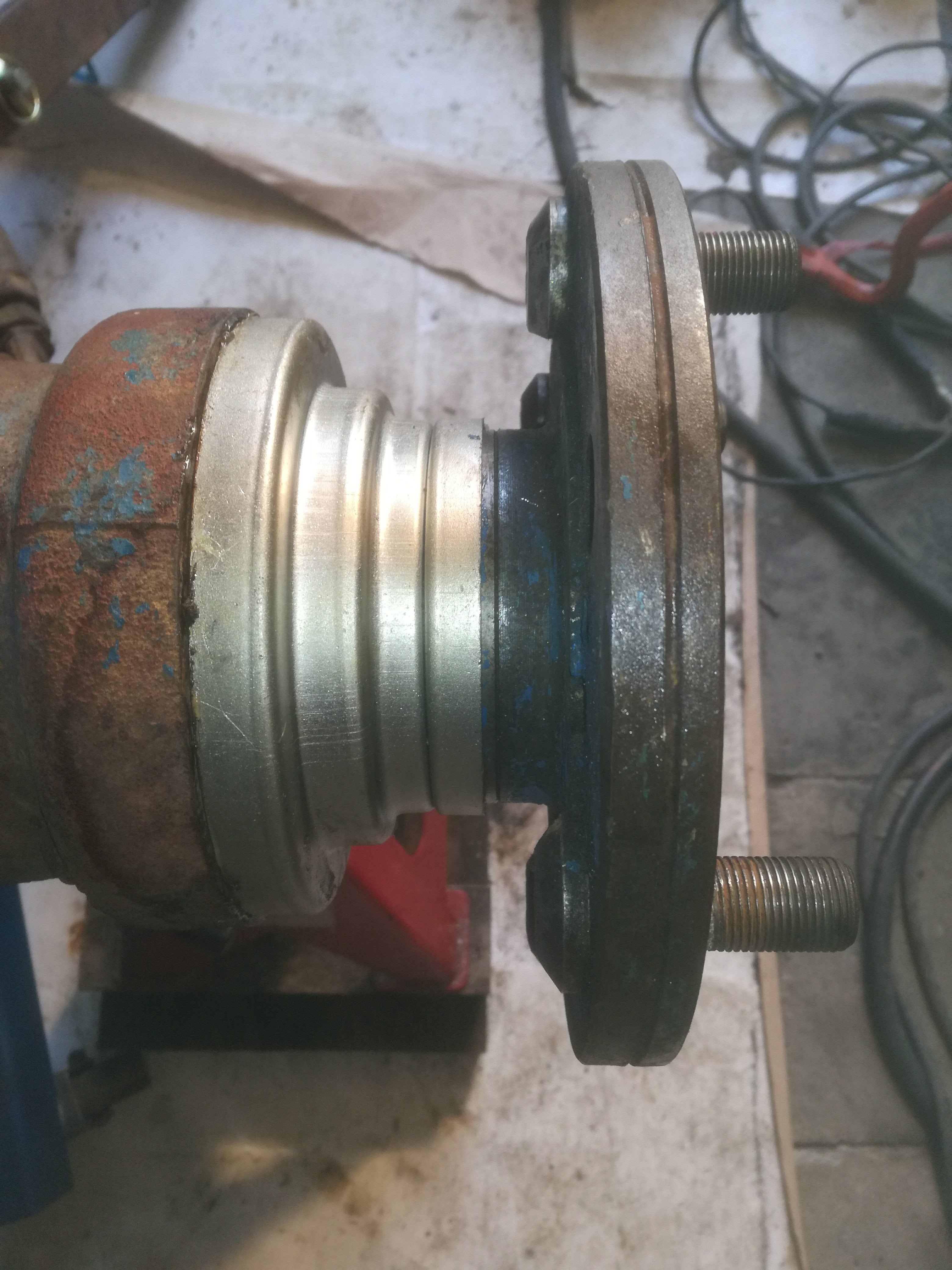

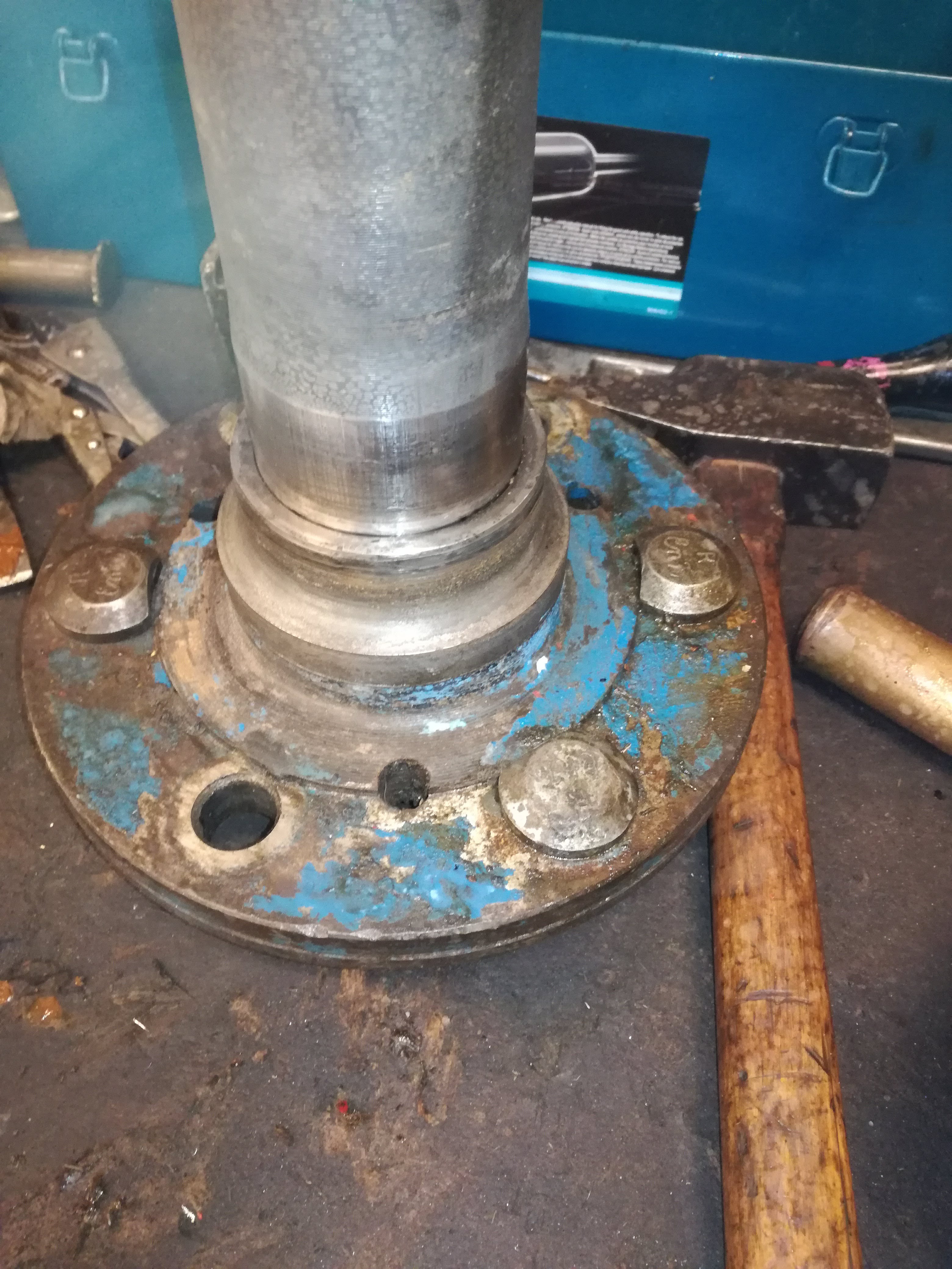

Hi, I’m hoping someone can identify this halfshaft for me, it has a removable collar that the bearing sits against. I’m guessing it could be an industrial? The problem I have is that the new seal and metal retainer it does not sit up the shaft enough compared to the other side. I think I need a different seal and retainer but struggling to find anything or failing that a different halfshaft. Here are the pics attached thanks in advance

Can you make a picture of the other side?
I see the old seal in the background, it looks like a normal seal to me.

That half shaft apperas to have imense wear, there is no separate collar, so I can only think that it's been interfeared with beforehand. Did you remove a tapered roller bearing? If not this collar is probably the old bearing inner race. I'm afraid you now have a very difficult repair to do, unless you find a better half shaft which might well be worth doing. There are often many mistakes with repro parts, but I think the rear axle seals are one if the few they get right, the fitted seal and shaft should look like this:

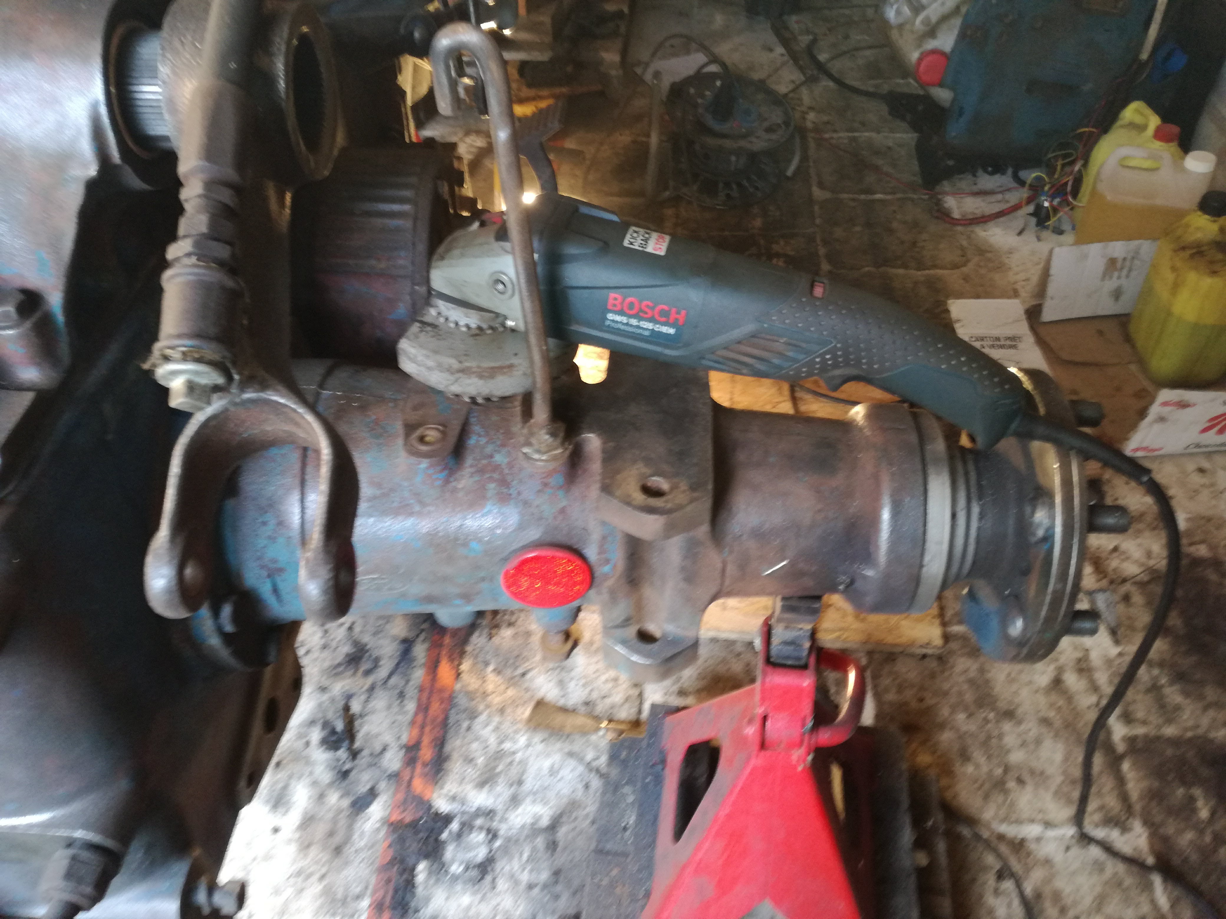

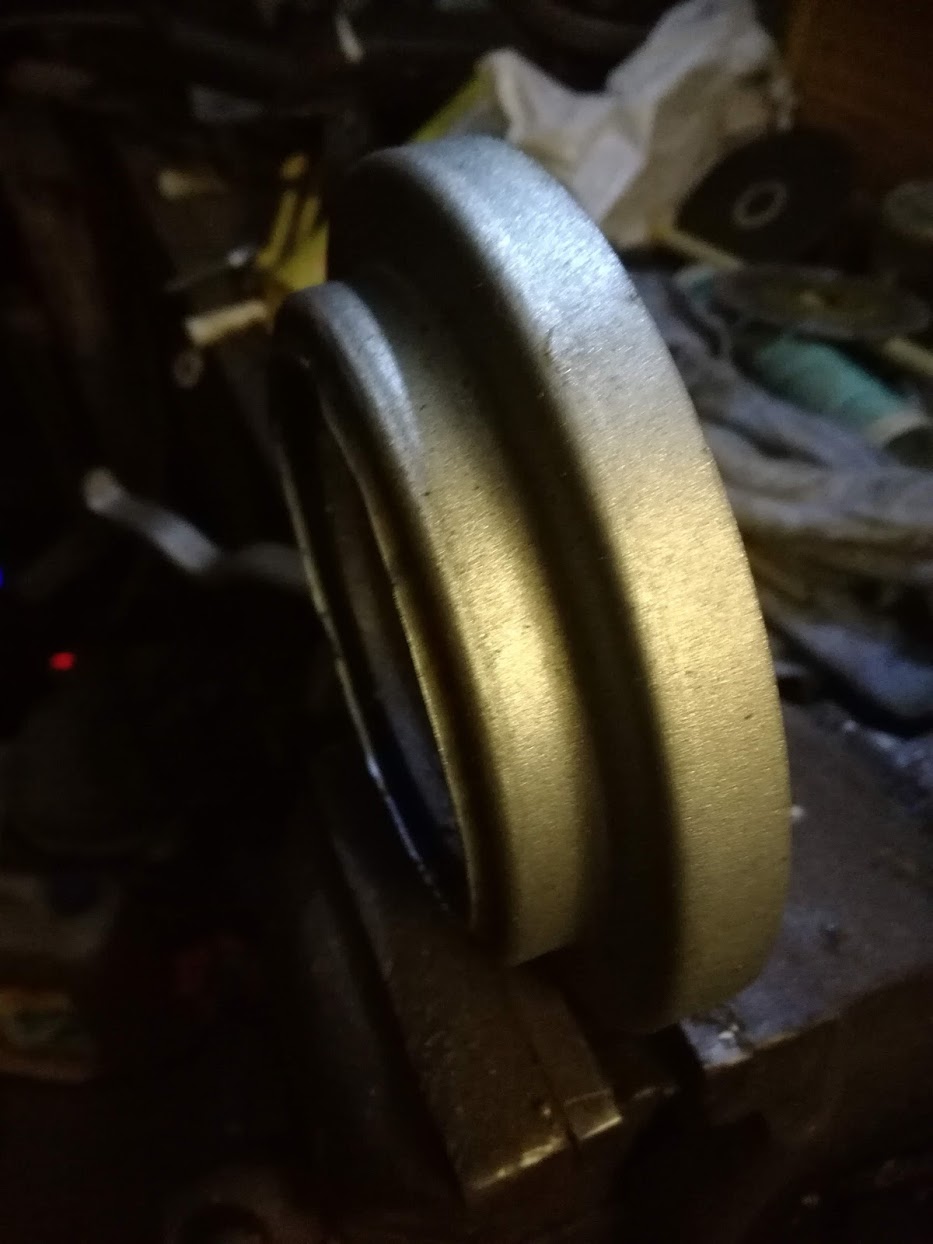

I did need to modify the new seal to fix it
I can not see where the extra collar is used

Thanks for your replies that photo is exactly the same as mine with the collar attached to the shaft. Can I ask how you modified the seal to fit as it won’t go far enough onto the shaft to fit about almost 10mm further out to the other side with the standard super major shaft on.

I did cut off the outer ring. I hope the pictures will make it easier to understand.
the first picture has the complete seal, the second one is how i got it fitted.

Notice that my axle has a little diamond. This might be the not so standard heavy duty axle.
this picture is the one I put on the Super 4

I’ve done some super rear axles in the past where I needed to modify the seal housings due to the exact same problem. Just cut of the exces part and have no further notice. Did work for me and it sealed also.
I assumed it were heavy duty ones as well. Couldn’t get the right type of seal for these ones.

Yep, for standard axles it will fit, the heavy duty ones not.

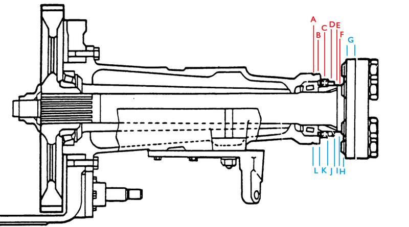

I finally managed to measure Billy and Super Billy, they're both the std. type, the measurements aren't as accurate as I would like because our calliper isn't big enough. The red ones are diameters, the blue ones are between the blue lines parallel to the axle shaft (the diagram is from the parts book and I think it's the heavy duty type).
A 5 1/2"
B 5 3/4"
C 4 5/8"
D 3 29/32"
E 3 31/32"
F 3 3/4"
G 3/4"
H 3/8"
I 1/2"
J 3/8"
K 9/16"
L 9/16"
If anyone has a better chance to get good measurements modify whatever you need to in the post, but do say what type of shaft it is so we can then see what's different between the two types.
As for part numbers both use the same seal (E27N-4245A), but the std. shaft, seal housing and felt (E27N-4235D, E27N-1183 and E27N-1180) are different from the heavy duty parts (E1ADKN-4235, E1ADKN-1183 and E1ADKN-1180). Ford sold the seal and housing separately, so there's no reason for not reusing the original housing if undamaged. The shafts became E27N-4235E and E1ADDN-4235 later on.
