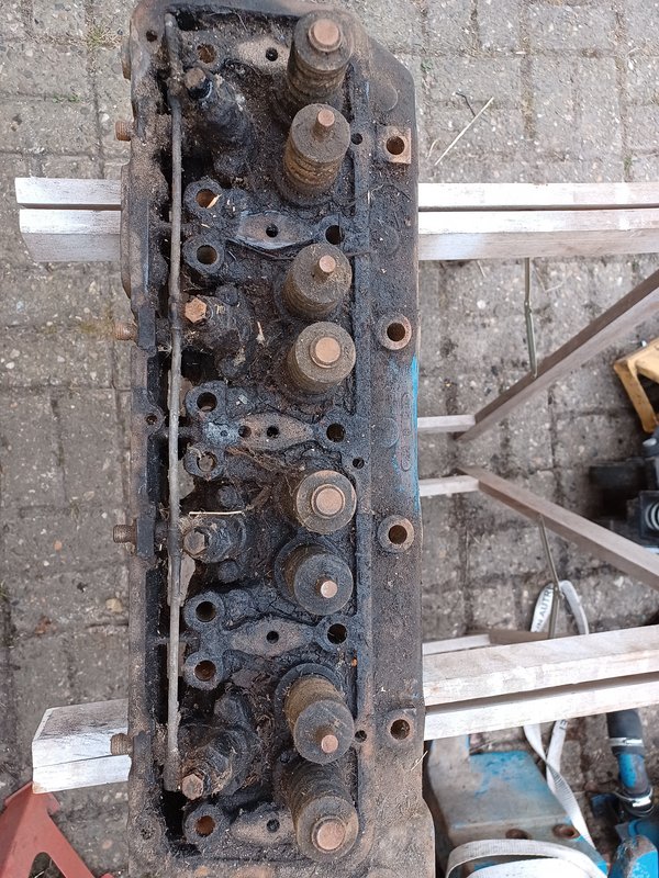

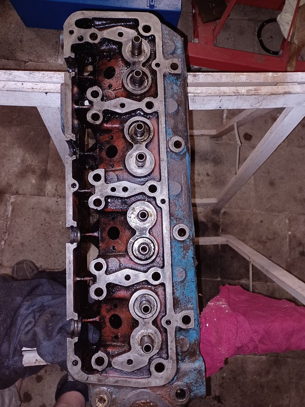

Since there were some frost related cracks in the cilinder head, it was time to get it fixed properly. I used some epoxy metal in the past, but no luck on that.
2 cracks above the manifolds
and one that goes around the bottom of front side
The head itself looks alright. We got the cracks welded and it is now to the shop to get it pressure tested, skimmed and the valves done.
The valve guides where in good shape, so they will be reused. Same for the valves. They are cleaned with the wire brush and smooth sanding paper

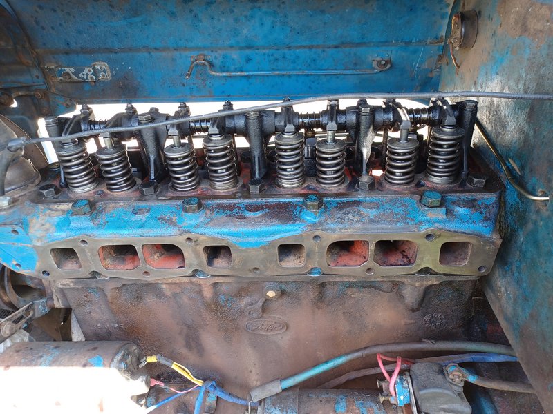

The engine is still in the tractor and could use some cleaning too
All cleaned up, I will juste leave the top of the liners.
Now just waiting to get the head back

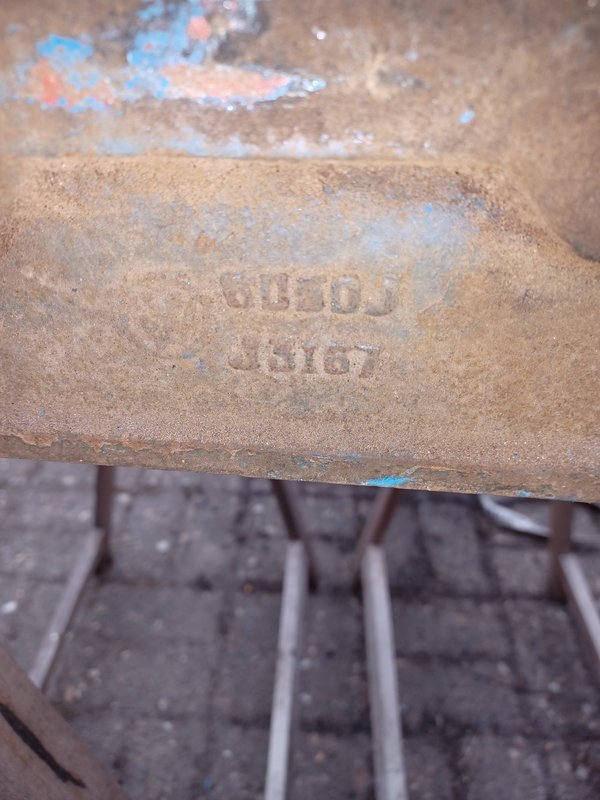

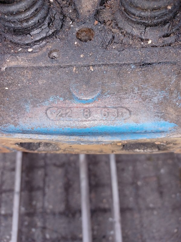

Looking good. Quite an interesting casting code on the head. It's always nice to fix things like that, rather than replace them.

small update: no luck with the head, still leaking according to the machine shop.
Will need to find a period correct FL head.
Re: engine head job
Make sure it's part no. E1ADDN-6052J, as otherwise you'll have a bit less power. A few of the previous head (E1ADDN-6052H) were also marked FL.

Again I'm probably stating the obvious to you but make sure you use the correct valve springs for the camshaft you have in the engine
Re: engine head job
John b wrote:
Fri Jun 23, 2023 8:28 am
John, I will reuse the ones from the original engine

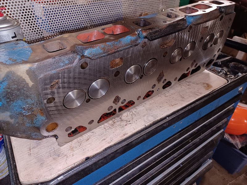

finally got the head back.
skimmed, new valve guides and valves been done also.
I can go on with the job :D

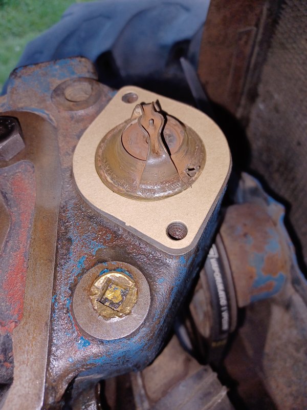

Finished the job today.
There is some oil coming out of the exhaust ports. I guess not much to do about this, unless fitting new liners and pistons.
video of the start
https://photos.app.goo.gl/NEJG2J4dkXtWAWgB9
What do you all think?
Re: engine head job
I think the oil will be from the overhaul, I wouldn't worry about it as it already seemed to clear in the video. I was surprised at how long it took to start, but maybe the injectors weren't fully bled. Everything looks good, I wouldn't have even tried to turn it over without the air filter, nor would I have fitted that thermostat but that's just me. Love seeing such good internal paint! Once running it's sounding pretty good, and it's nice to see the oil where it should be. I would see if you can realign the fan pulley, as it's quite badly off centre.
Re: engine head job
That’s quite a wobble on the fan pulley. Is it seated properly on the water pump?
Re: engine head job
Old Hywel wrote:
Wed Jul 26, 2023 9:38 am
Yeah, will need to look into it. I never touched it so far
