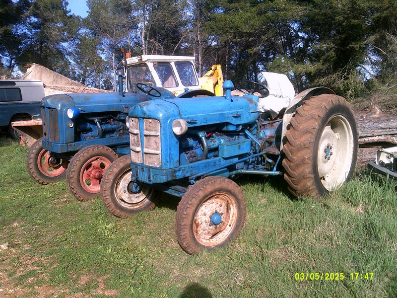

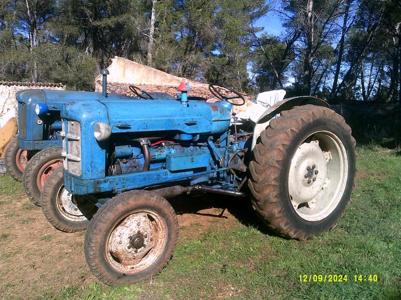

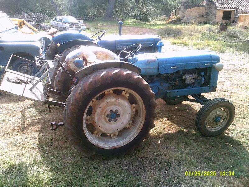

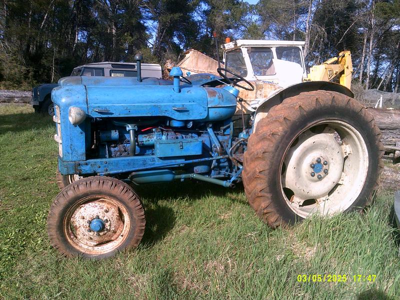

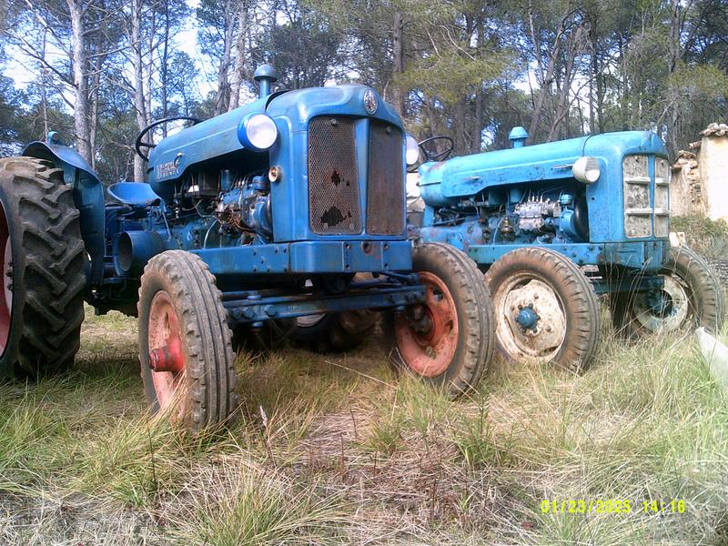

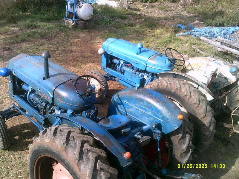

After a long silence on the subject there's a big development: Super Billy is back!
It took a few false starts but were there, more on this soon as pics are not easy to find.

Well done, looking good! Some good pics there

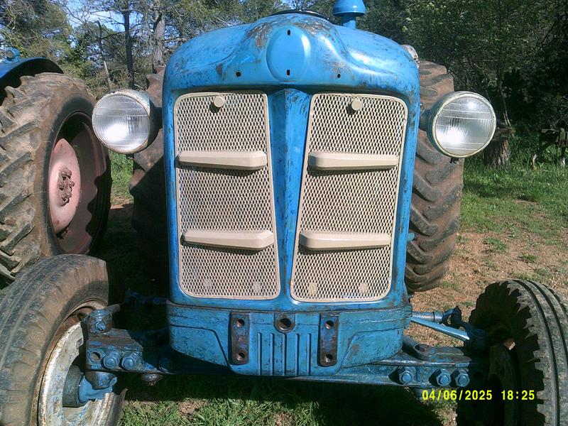

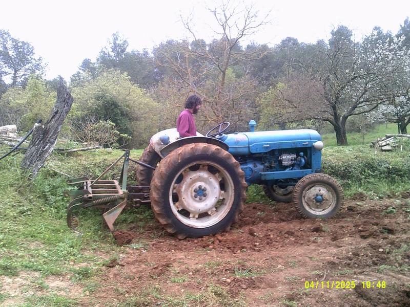

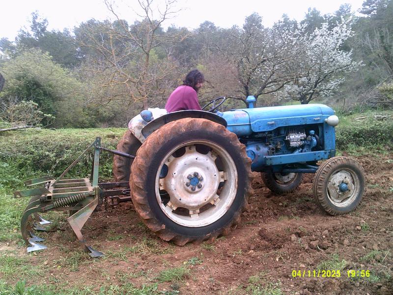

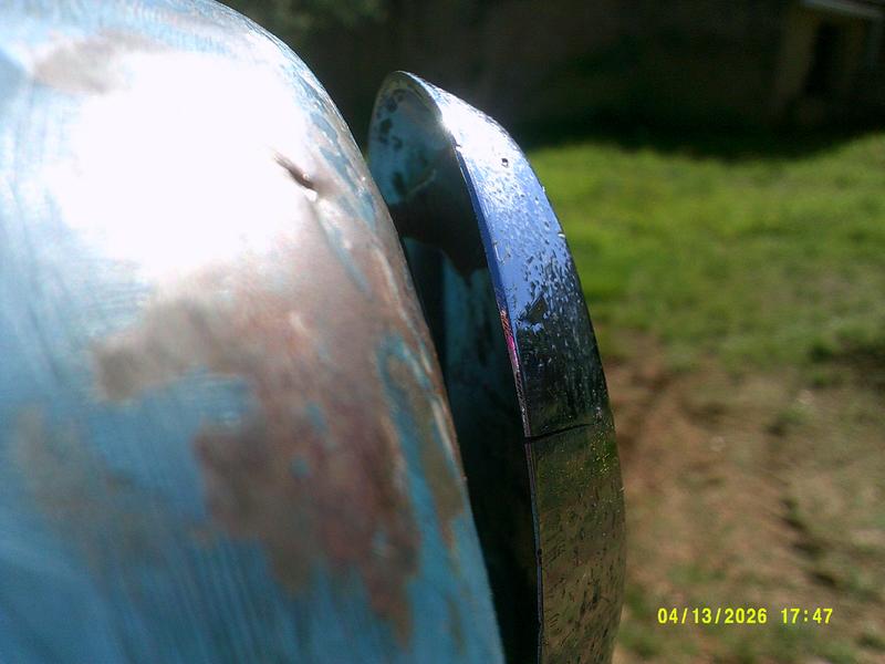

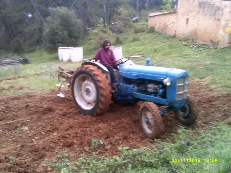

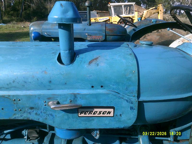

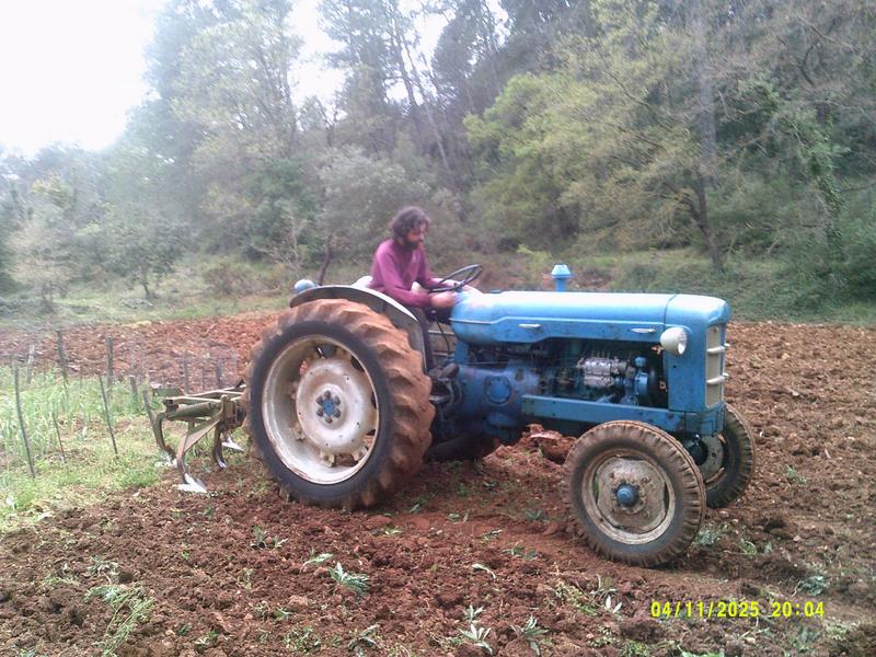

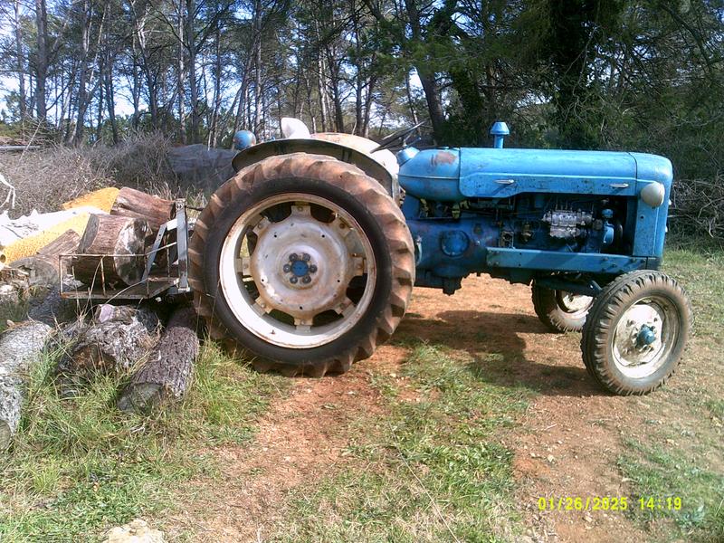

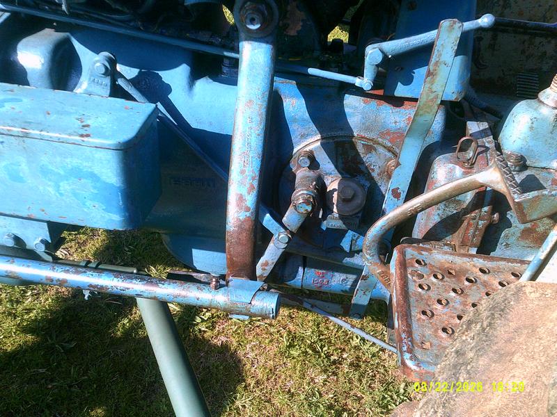

Quick update, just did a bit of ploughing today (as usual Billy did most of it), unfortunately the badge fell off a few days ago when the only stud holding it on broke, fortunately it's otherwise fine. Any ideas on how to fix that without drilling through are welcome, I'm thinking of some epoxy stuff we've got but not too sure if it will work.

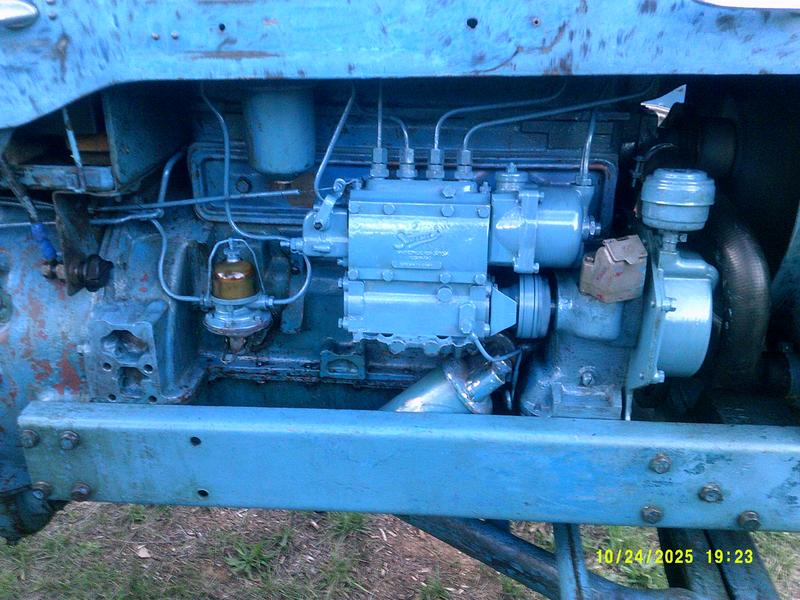

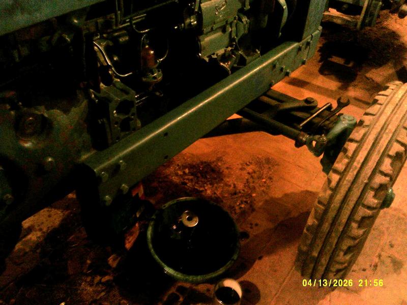

Can't do more for a bit as the first oil change is quite close and we'll redo the head and tappets at the same time. They're surprisingly different to drive, Billy feels pretty powerful and basically drives for you a lot of the time, whereas Super Billy you need to watch out for the seat as it goes all over the shop (it's an Ebro equivalent of the rest o ride but of different design, and a bit too far away from the pedals as the grooves are badly set up for a Super Major), can't say about the power as we need to use the same implement for that. Adrian and Shepp will be intrigued to know that the gearbox sounds much quieter than Adrian's NP, I think Super Billy is very low hours but in very poor hands in the maintenence department. For anyone else with the wrong spindle bushes (as sold by Agriline) you'll need to pre pack the bearing to accelerate proper lubrication, not doing so will mean poor lubrication for the first few hours (even if you get the grease gun onto them more than every hour!).

Hi Sandy, I have fixed one of those badges on a friend's Super Major and it has held so far. Grind what is left of the pin flat but leave as much metal as possible. Drill into the badge as deep as you can without going through (lots of precise measuring needed!) with a 4mm drill (should be 4.2 but 4 is close enough on pot metal). Tap the hole with m5 tap, cut the head off an m5 bolt and screw it into the hole and bond around the base with chemical metal. Used nyloc nuts to hold the badge on so I didn't have to tighten them too much to stop them coming undone. As I said, it has held so far and i did it at least 4 years ago

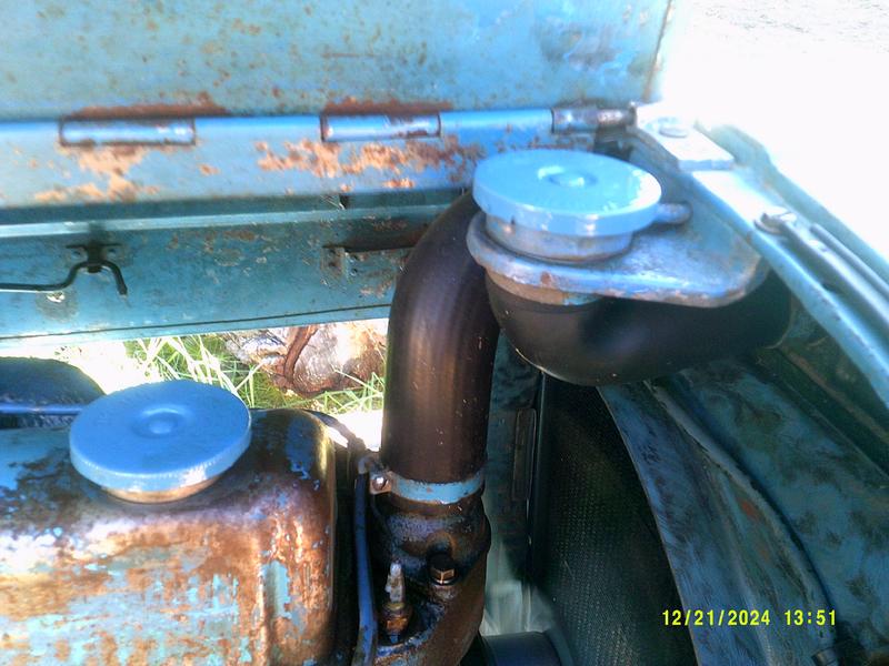

The area is pretty flat as there had been a lot of wear from a previous NP that used this badge. Not too sure we have suitable equipment here for such precision but we'll see, with all the cleaning we're doing now it's probably just as well the badge is off as it avoids extra work. Not sure what exact chemical metal you used, we got some stuff that we used first on our Renault 4's fuel tank and then on Super Billy's original radiator which we need to try some time (I had it full of water for 4 months or so with no leaks but need to try it in Super Billy to see for sure, if it works it'll stay there, probably worth posting some pics anyway, he's using a new one at the moment) it had a hole and damaged solder in the lower tank. Hoping to get the subsoiler back for the first time since Super Billy failed, and that should give a good chance to compare them. When Billy used it he only had 3 digging but Super Billy was managing 5 with the big end issue, quite keen to see if Billy can manage 5 too!

A bit of an update. The badge is fixed and back on, used this epoxy stuff and didn't drill anything. It'll have to come off for doing some painting but we'll wait till the pollen is no longer covering everything.

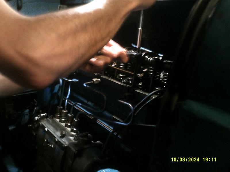

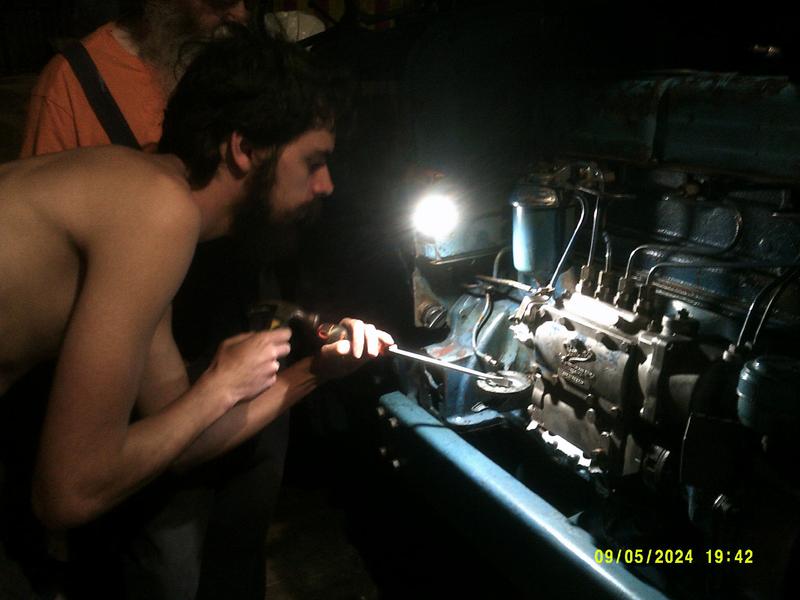

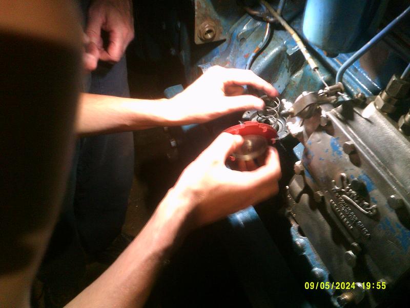

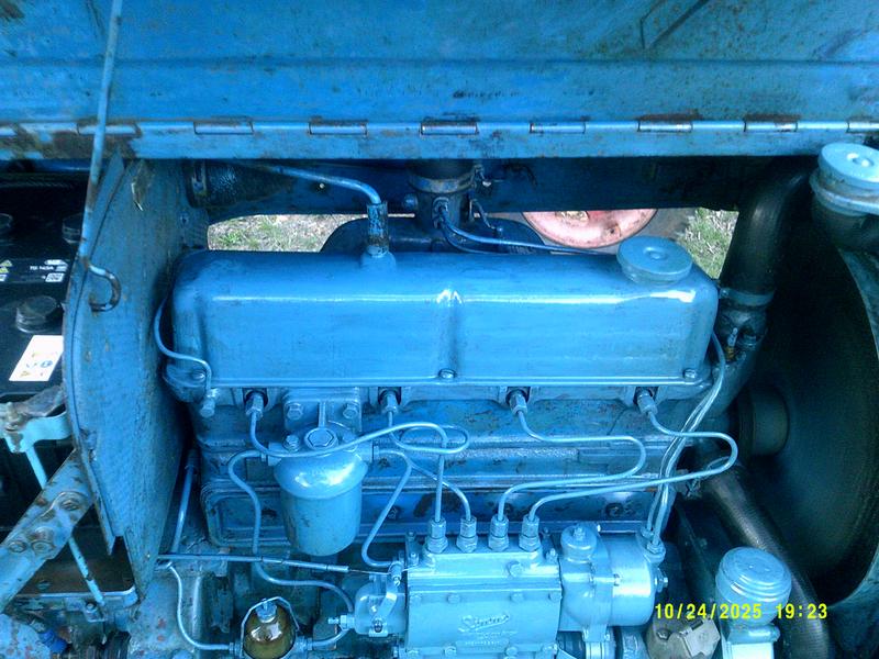

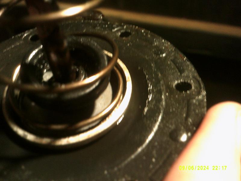

Done head and tappets several times, also changed the oil several times. Replaced the lift pump diaphragm due to a hole in the original one, beware of kits containing wrong parts.

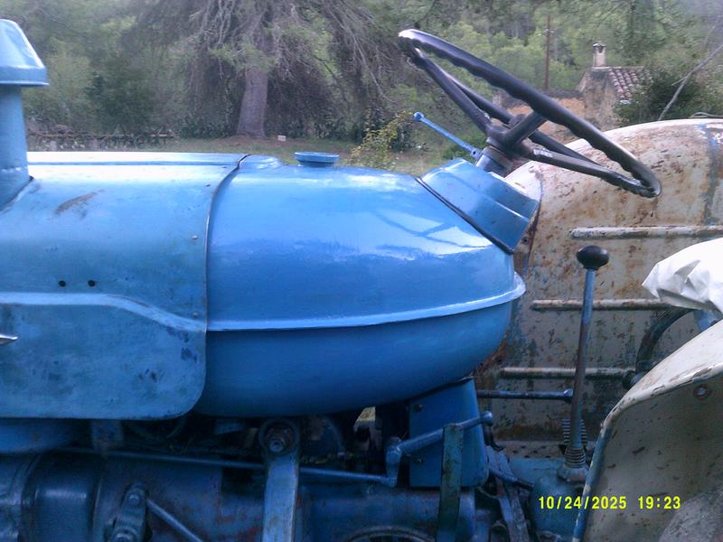

Also done painting in various areas, with major improvements in appearance.
Full story yet to come, but still struggling to find some crucial pics for it. Did more ploughing today but the camera is on its last legs (battery needs changing) and taking pics is not easy.
