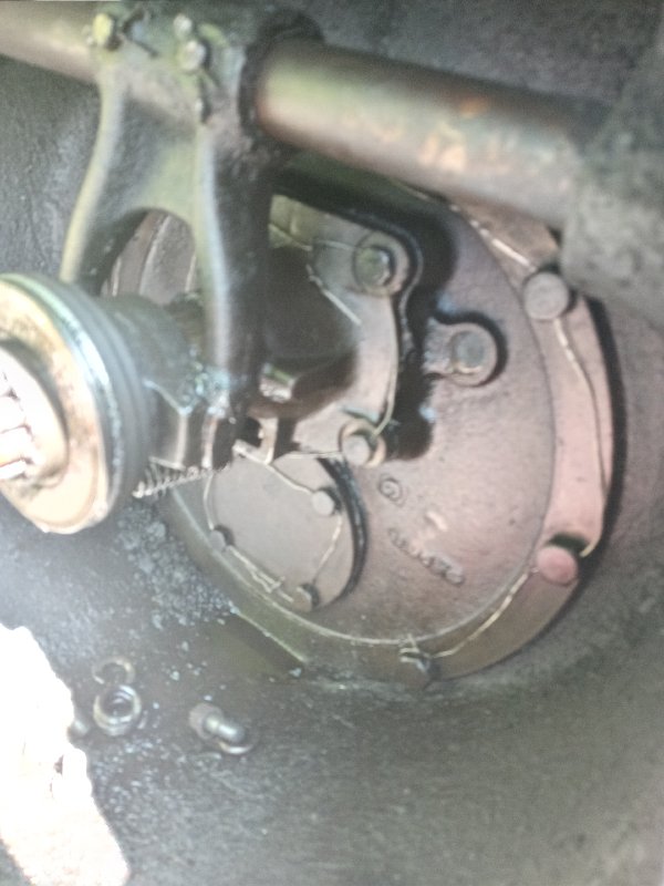

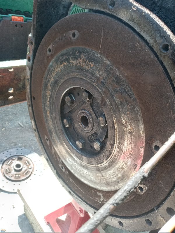

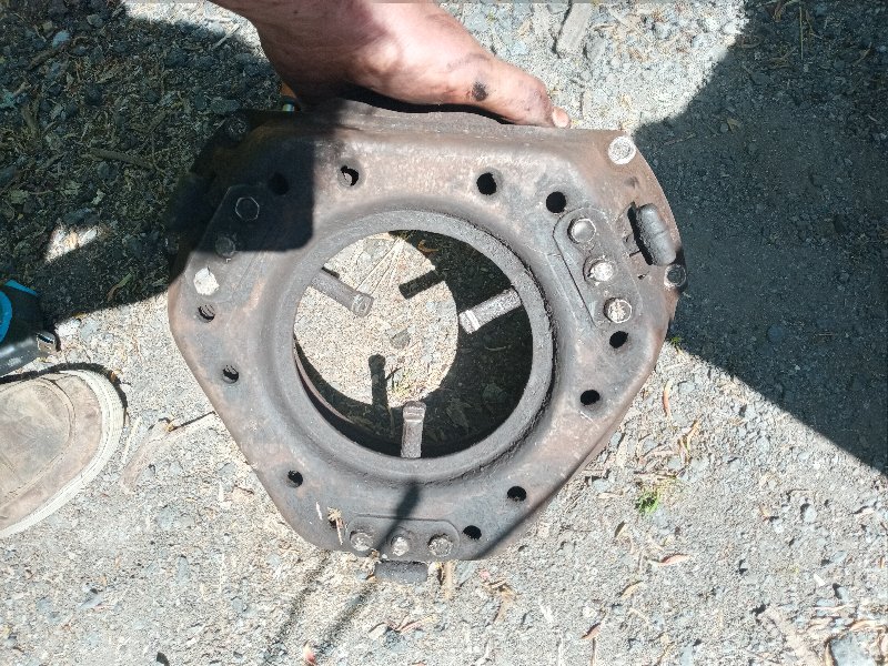

Sorry for all the pics, but does this look like a major clutch, the clutch plate is 12" diameter
Re: My 6 cylinder major
This looks on the photo's like the origial Fordson Major setup. But then it should be an 11" clutch. There was a heavy duty 11" clutch as well on early tractors with a more "black" appearance of the friction material and thicker lining. Then you should have found spacers between the flywheel and the clutch cover.
The 13" clutch is fitted with 8 bolts to a different flywheel, so this certainly is not the later style 13" clutch type.
Can't find any info on a 12" clutch disc in a single clutch. I think I would replace the complete clutch with a new 11" or tried with a new 11" disc first and setting up the old clutch cover. But that usually isnt a really long lasting thing when you intend to use your tractor where it was built for.
rgds
rgds

Here's a update if any one is interested, got the clutch changed and got the tractor back together, it was a standard 12 major clutch plate, but it seems all was not as it seems as I spoke to a man who converted 100s of these tractors to 6 cylinder, seems like the flywheel on the engine is not original to the thrader engine, so I had to reuse the pressure plate, also I took off the crankshaft pulley as it is badly rotten with rust and is badly warped so it was cutting into the timing case, trying to find a pulley now is impossible it seems so I'm at a standstill really till I find a replacement

Just reviving this to clarify what you have here. It's none of the clutches that you all say, it's the std. Thames Trader 6 cylinder clutch, 508E-7563 and 510E-7550A, plus flywheel 510E-6375B. They should be fine, but might not be ideal for hard work. For hard work I think the 12" tractor plate E1ADKN-7550D or E1ADDN-7550C would be better, although I haven't got full details on this yet. This clutch is like the 11" clutches, it has flyweights on the toggle levers to increase pressure on the friction plate at high speed.
