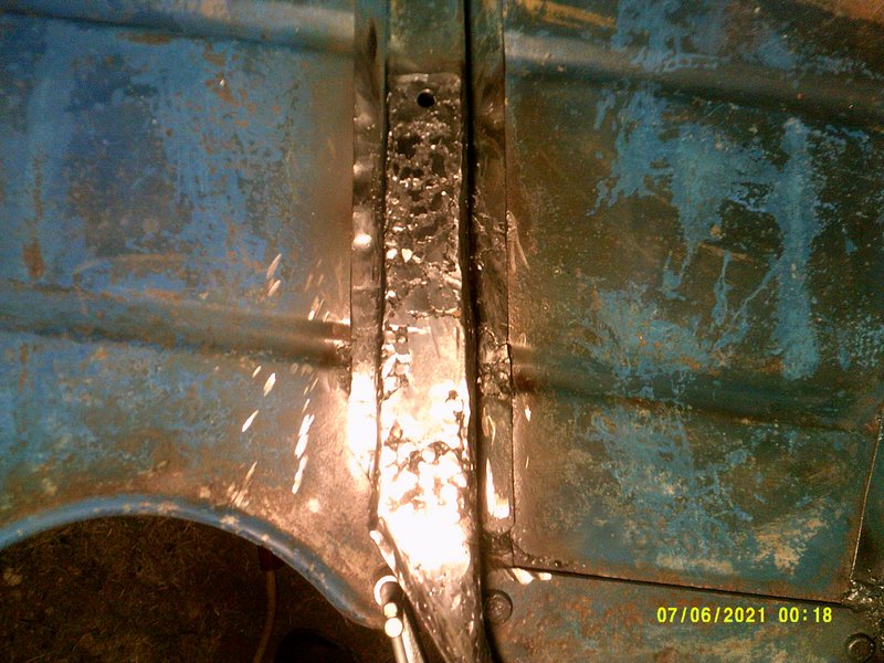

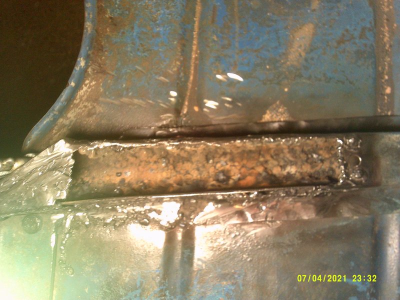

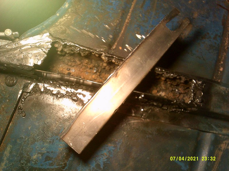

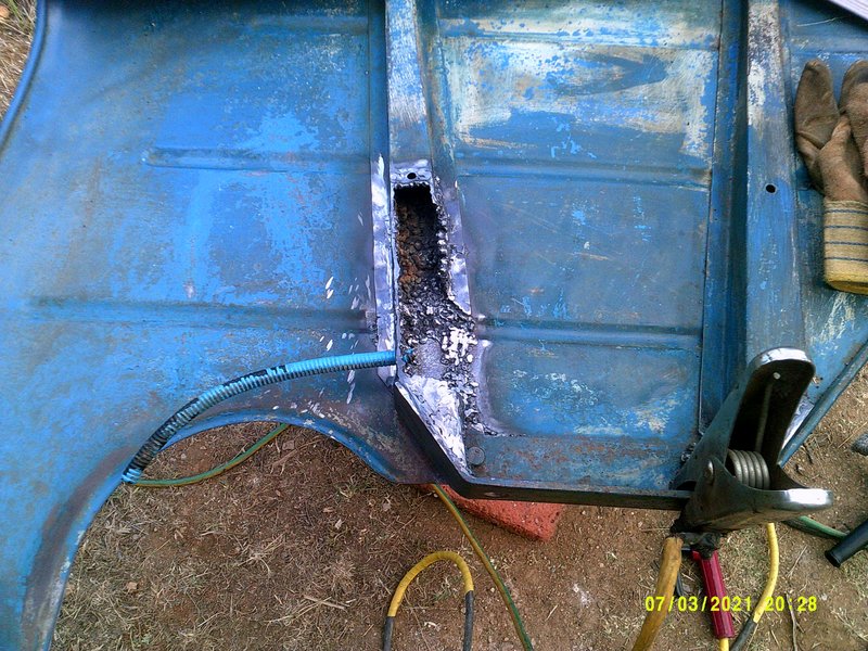

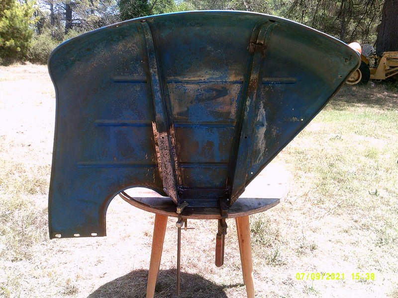

After more work we seem much closer! Some pics of a test bit of conduit in (a spare bit from our half Super Major).

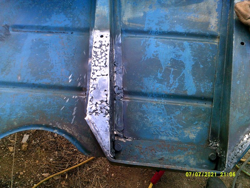

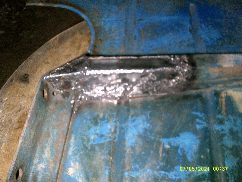

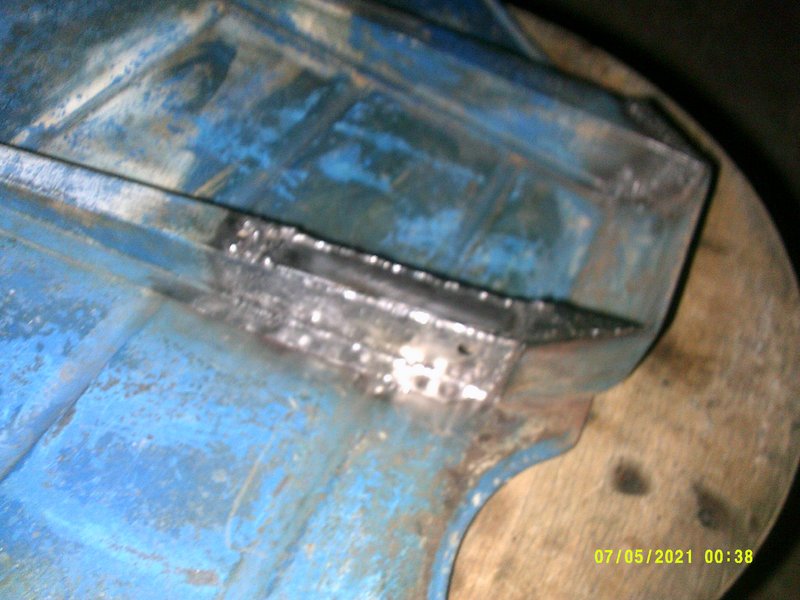

And today we fitted the extra plates. The rear plate fitted.
The LH plate ready
and fitted.
And a general view.
More to come soon.
Posts: 2560
Re: Billy's LH mudguard - Repairing corroded tinwork

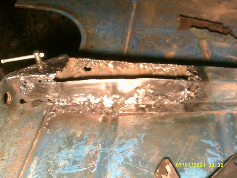

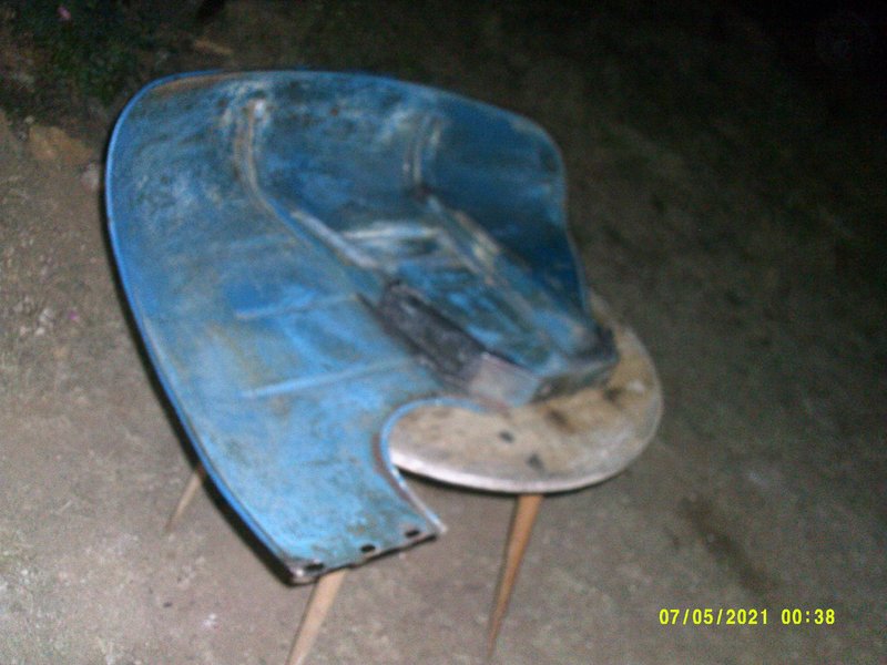

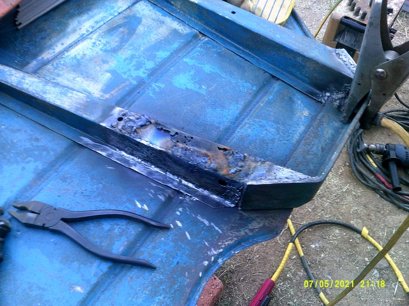

With the new material fitted the bit that fell off ploughing can be refitted
and filled in, although there are lots of holes still there.
More coming soon.
When i repaired the wings on my old major a few years ago i used a parafffin spray gun to spray used engine oil down inside the wing supports once the paint had dried, hopefully it'll slow the rust down in there!
Posts: 2560
We were intending to do the same sort of thing and on all the mudguards. I'll also blow them clean at the same time as I blow the radiator's on a regular basis in order to avoid the buildup of dust inside that caused this in the first place.
Posts: 2560

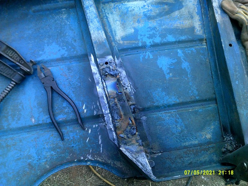

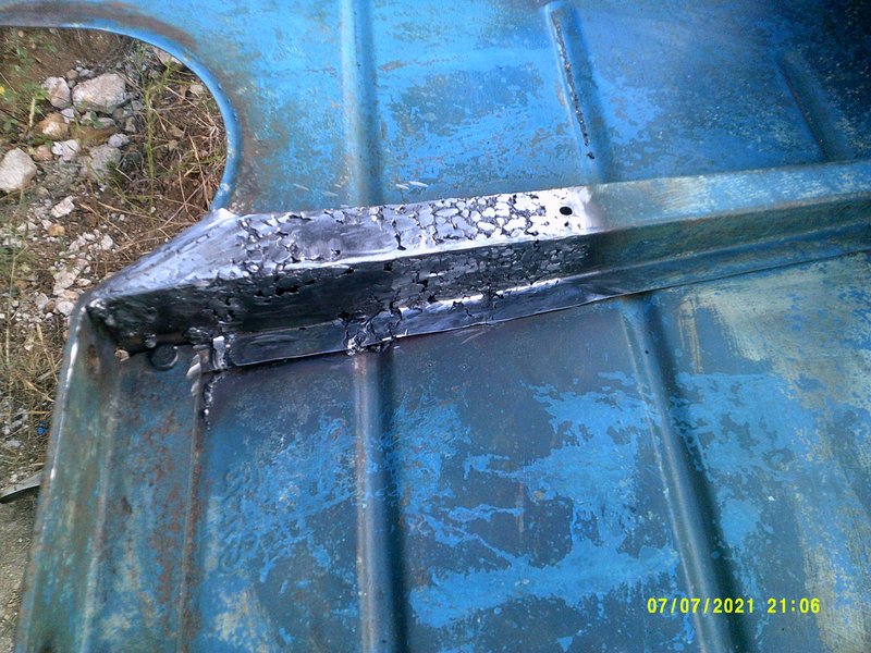

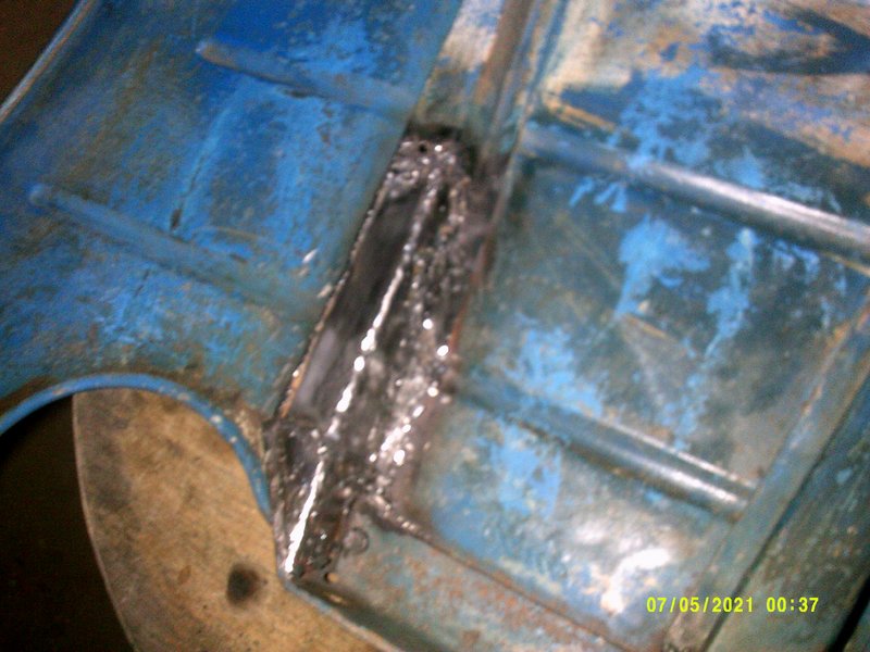

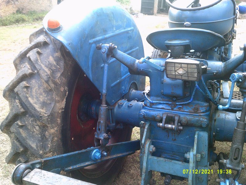

We're done! More welding.
After more welding this is what we ended up with.
We then tried to patch the holes with some filling material, not very successfully.
And then painted two coats of blue as Ford did, the 2011 Agriline pots we had match the original perfectly! (Note the other mudguard, see viewtopic.php?f=2&t=8373.)
While we had the paint out we decided to paint all the new bits and the side lights, so that they're less conspicuous.

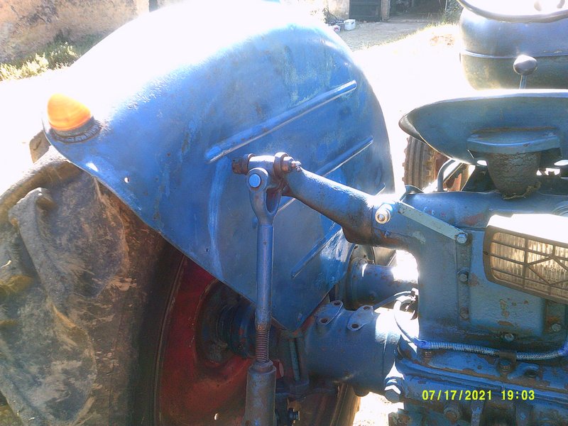

And now back on and ready for a small touch up painting and that's that.
Back in the barn complete for the first time in six weeks.
Now to clean the other axle casting!

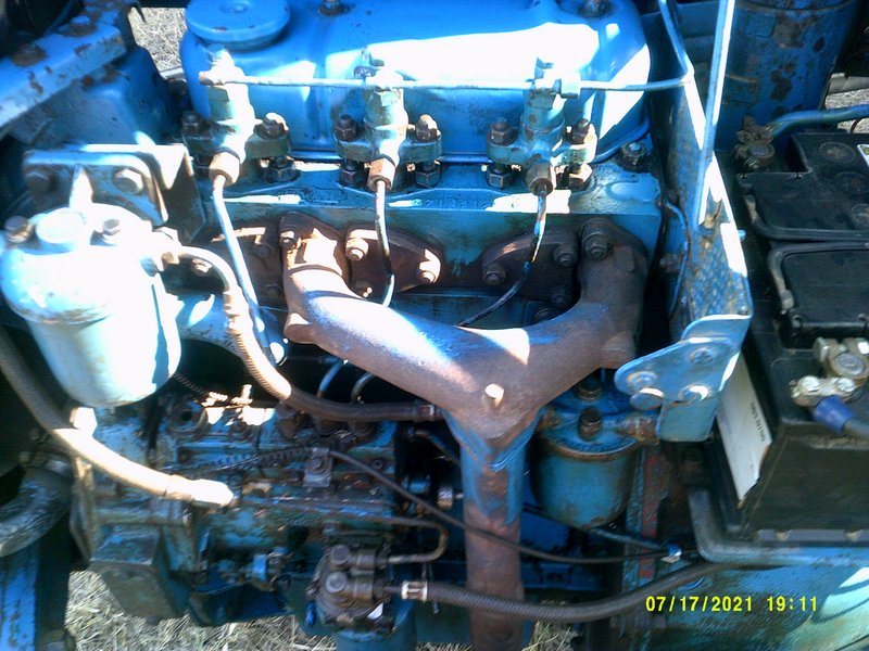

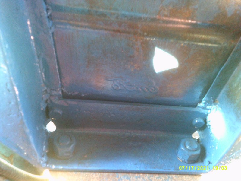

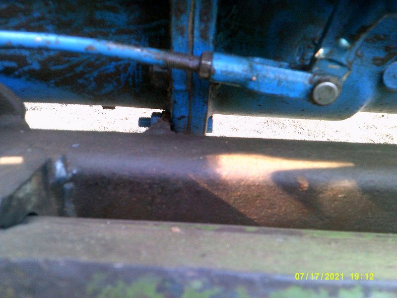

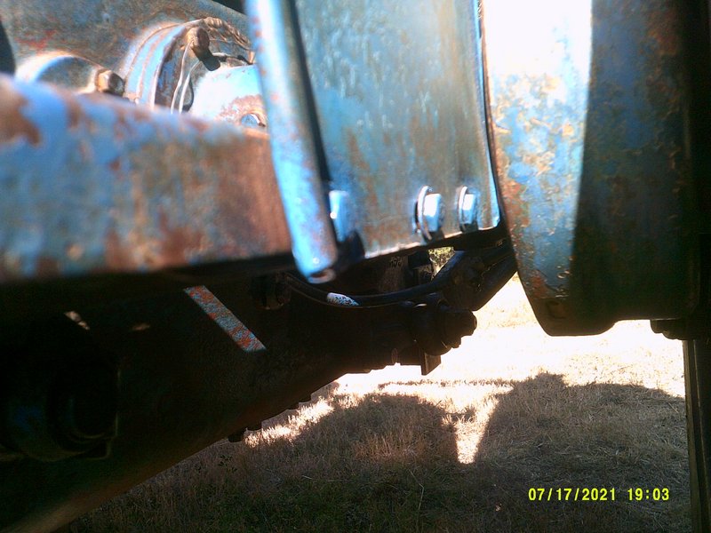

The final painting on the mudguard was done a while ago, but I have some pics today, showing the bits that have been done (also on Davie).
Davie's bits
