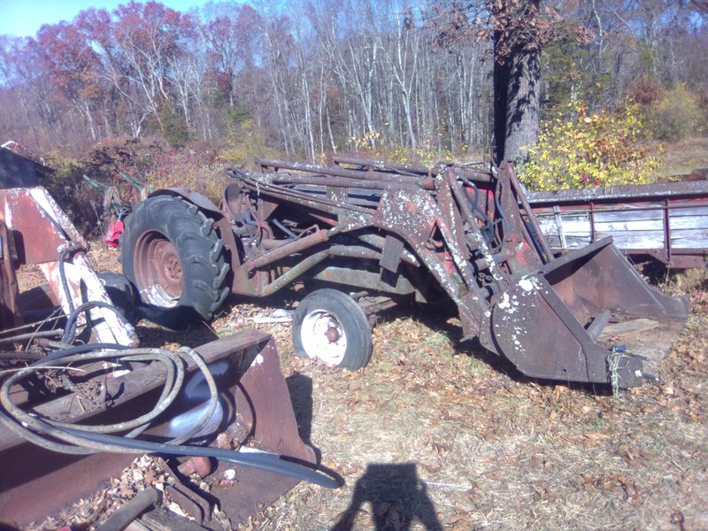

Here is the FMD after getting the tree remains off. I've got pictures of the tree stuck on the leveling arm on my son's phone to post soon. Injector is the Supers.

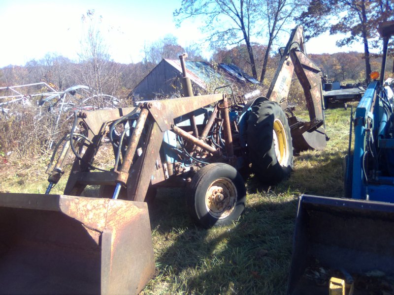

Another picture of the Super:

Have not had time to work on any of our new recues but here is a picture of the tree before I removed it.

That looks quite hard to clear. Glad you've already done it.
