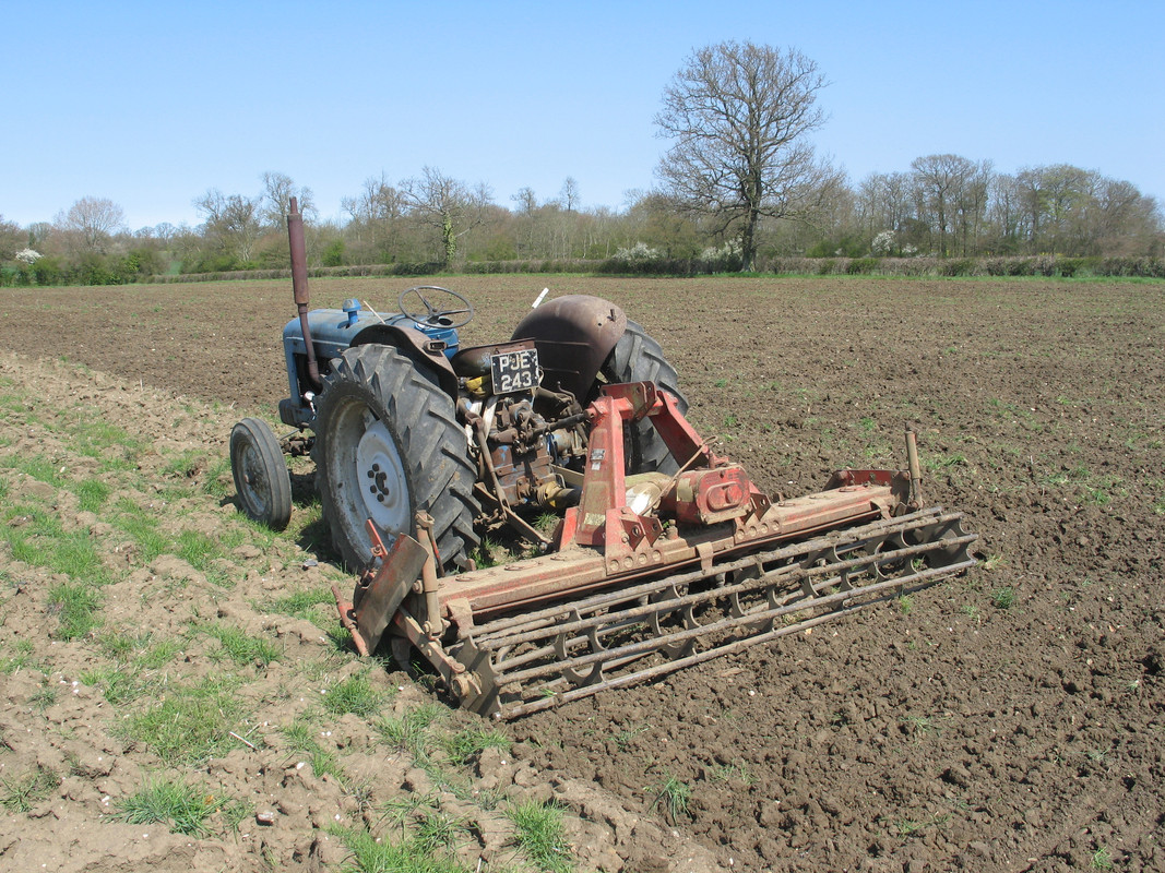

While we’ve all done things we shouldn’t, and cut a few corners occasionally, I can’t believe anyone would film themselves using a machine with an unguarded driveshaft.

Well now you can believe it.

The old girl is doing well there Adrian, no smoke and doesn't sound laboured, although the soil is dry and it's a different story with wet soil! The photograph shows the ground rough ploughed some time ago whereas the video is after the ground has had at least one pass with the harrow or discs, how does the tractor cope on ploughed ground? I use a 3 metre harrow on a 7740 sometimes, it is a handy size for some fields and also for the indoor and outdoor riding surfaces at the equestrian centre, but if the ploughed soil is damp it can make the tractor work! There is a video on YouTube of a standard Major working with a 5 foot Howard Rotavator, no raised PTO, masses of black smoke, poor thing, every time I watch it I keep expecting the "bang" as the PTO gearbox case gives up!
