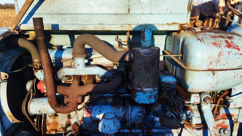

And it will cause excessive revs when correctly adjusted and without the filter in good condition (dry or damaged). I think returning the filter to its original position is quite a big job, and I see no point in replacing the air hose until the filter is moved back, even though it will be damaged by the oil (which should be cleaned up urgently).
Soukup wrote:
Thu Mar 03, 2022 9:55 am
It will be a bigger operation though, there is a bracket welded on the battery platform to allow mounting of the bigger battery. The wall between engine and battery is also cutted. I need to figure out some way of fixing the filter where it bellongs.
Your best bet is probably a second hand replacement battery tray and firewall from eBay or a scrapy.

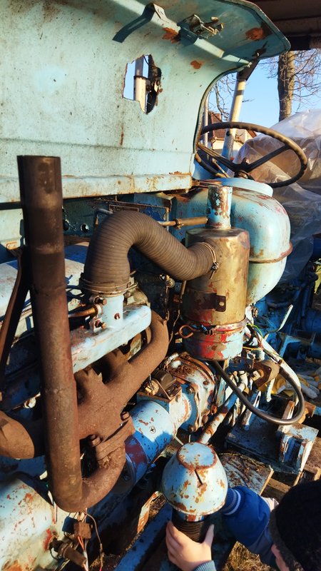

Well, what I managed so far was to move the air cleaner back to where it should be +- 5mm i guess. I fitted new air hose and currently waiting for a new air cleaner (out of stock on agriline).
btw I found a spot on the battery tray where is the original blue color visible.. Much nicer than this weird light blue.
What I noticed when I started was that when i give no throttle the revs drop to 400-500 /min. Could there be some issue, that the whole revs range is moved down? Just a thought I dont know if this is possible.
What I understood is, that the revs would increase even in normal state when the intake hose is removed. (even with no restriction of air in the cleaner) So maybe the problem is in some setting anywhere else?
The air intake setting is turned all the way out though, so I dont know where to look.

I can get only 1500 revs now
SvendH
Posts: 172
Joined: Tue Jan 08, 2019 2:44 pm
Re: Low engine revs + air cleaning issue
Post by SvendH »
500/1500 revs isent too bad,is your rev-counter reading right?
Posts: 2501
Good work, have you got the new mesh back in? If not you should wait for that. Once you have the filter with the correct oil level and complete mesh and pre cleaner on, set the idling screw (lower one) to 550 rpm and the no load max screw (upper one) to 1800 rpm, you might also want to check that the throttle linkage is moving nicely.
