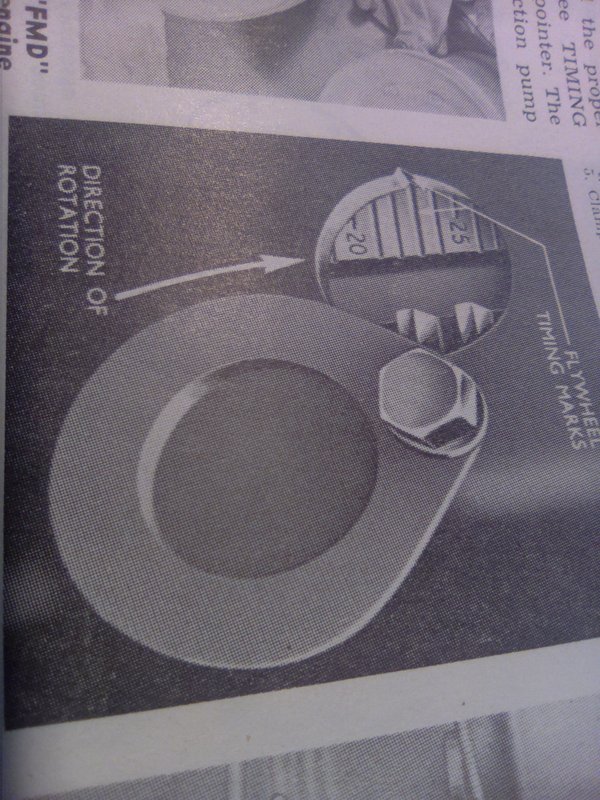

You shouldn't need to mark the pulley as it has the timing notch at 29ºBTDC, I suspect it is time to remove the injectors but try this first. Try moving high and low and also disengage the PTO. The clutch will help but with high and low in "neutral" (there's no hole for the detent retainer but I've often had that lever like that, it is like that on our half Super Major right now) and the PTO disengaged you're only turning the input shaft and primary lower shaft and PTO idler gear. The main gear lever sounds like it needs work, but that I would wait for the engine to run so it can be done in a more convenient place. You can get a fair amount of a turn if it's in gear, depends on the condition of all the parts (and the gear too) as if they're almost new there might be only a quarter turn or less, I very much doubt that this one is as little as that and think it could be in gear. The clutch is a slightly separate item and needs to be tested separately so that you don't suddenly find it's stuck. I certainly wouldn't say the engine is seized if it turns well when it does, I think the problem is either you're in gear or there's a deposit of sorts in a cylinder, the latter I think is unlikely as you do seem to have good movement. It could be possible that it's just dropped a valve as you've moved the engine around but that's unlikely and it's very unlikely you would have these issues with a dropped valve anyway.

I'll look for the timing mark on the pulley too. I'll look in book for the pointer, but so far have not noticed it. Hopefully in another 6 hours, I'll have more news!

The pointer is attached by the same bolts as the dynamo front bracket, the notch will be in the rear of the pulley. The PTO shouldn't stop the engine turning, but it will add a fair amount of drag. I wouldn't bother with the belt pulley cover for now, those levers do occasionally get stiff if not used, Billy's one used to be a real workout to use, but it's now very easy to do one handed. You might still have the early high low lever here but that has a large separate knob so you should be able to tell at a glance, those ones always get play, if it's the later one then make sure the clamp bolt is tight then you should be fine no matter how stiff it is and it should improve as you use it.

I see now in the shop manual where the pointer is.

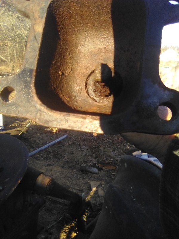

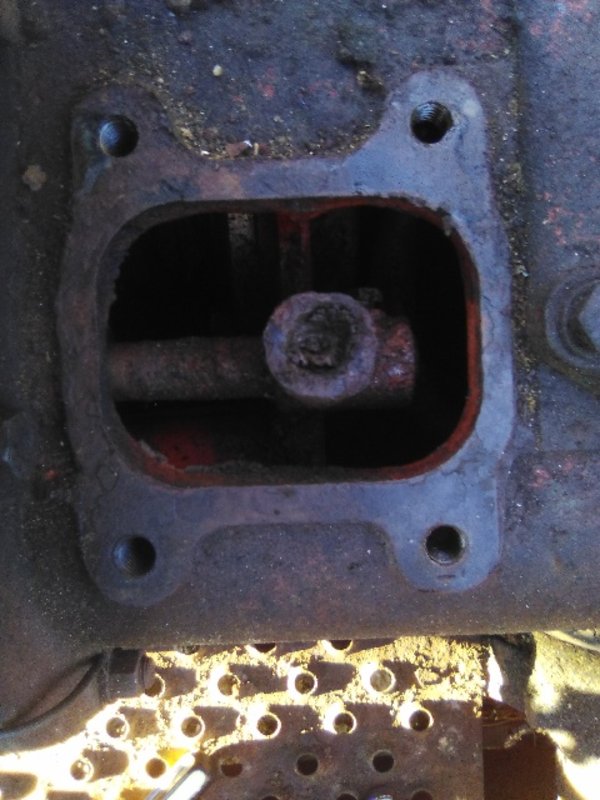

Here a picture into the main transmission and shift lever. Both in poor shape. Still not positive if Daisy is in neutral. Made sure pto was not engaged and tried with clutch pedal down.

That is what I would have expected, the pic in the manual is from the Power Major era. Those don't look great (plenty of cleaning needed) but I would say you are in neutral. The high low neutral is ahead of the main gears and leaves them disconnected. I would do a tappet clearance check to see what you get. Exhaust 0.012", intake 0.015", always use the rule of 9, and make sure the opposite valve is fully open or the measurement will be inaccurate (you'll get too much clearance). This will need to be repeated hot later on. What position is it in when it stops? A pic of that would be great. If the plungers or tappets are stuck they'll normally stick in the up position, but knowing the position the engine is in can help, however if the injector pump were related you would get nearly two turns so I don't think it's that. Is plunger no. 3 moving? After checking these things I would recommend looking at the cylinders through the injector holes and at the injector nozzles. Everything should move just as it does when running but far more slowly. How does the clutch feel? Glad Daisy has a name!

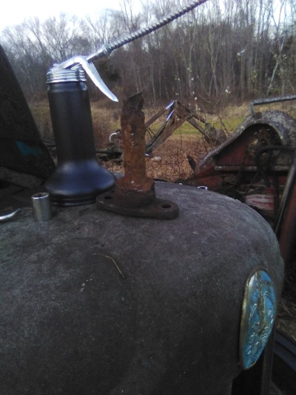

I would recommend an old school oil can, you can then get plenty of oil directly at the side rather than have to fill the combustion chambers first (I would have the piston quite low so some oil goes on the rings in a clean patch first thus giving better lubrication for later). I still think a look before is worth it as you should be able to find which cylinders are worse. The injector nozzles will help with that too as they'll show any potential rust as well. If you use diesel you'll have to change the oil and eventually put clean oil in the cylinders anyway, so that is worth having in mind. Having seen the top I would probably want new oil anyway, and a careful clean would be good too although that is quite a hard job.

Sandy is this the oil can style:
My son bought it to oil cylinders in his IH 504 injector holes. He also bought Marvel Mystery Oil. Popular here in the states, not sure if you've all heard of it.

Never heard of that oil. I would do exactly as you say to keep dirt out, the rear of the rocker cover isn't actually too bad to clean but it can be more fiddly. Be careful to avoid dropping bolts, it'a all too easy, and getting them out again is not. If you have the injector lifting bar (E1ADDN-17098) and the injector spanner (E1ADKN-17108) you'll have a much easier job, it can easily be done without either but it's a bit harder, especially if the injectors are stuck hard. Very handy oil can, that should be excellent as you can point it all the way round. Quite a lot of rust there, glad it's out now.

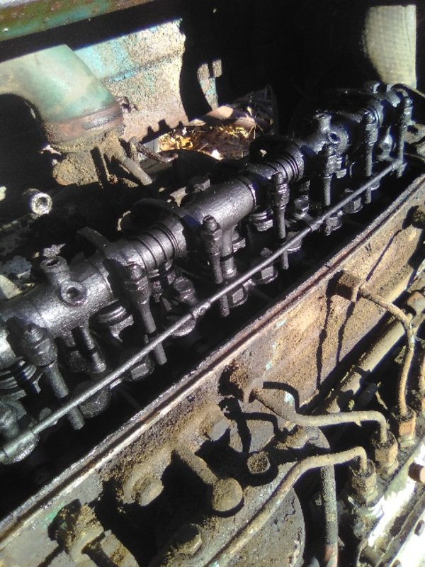

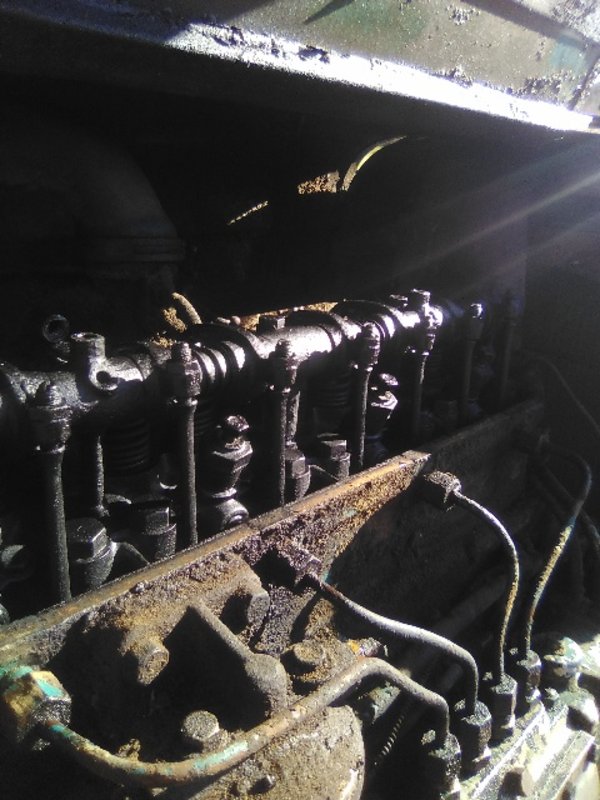

Solo again today so I can't really see what's going on when I turn the motor.
The valve train seems to move some. I cannot find my feeler gauge to check tappet clearance. Terminology: are the push rods on the injector pump side of engine? I seem to remember on Hyacinth that some would have barely any play but others could be moved up and down?

Push rods are indeed on the same side as the injector pump. Some will be loose and some will be tight depending on the position of the engine, but when one valve is fully open, the opposite one corresponding to the rule of 9 should be loose. You won't probably be able to check all of them for now as the camshaft like the injector pump runs at half the speed of the crankshaft. Looks like the leak off line came off fine.

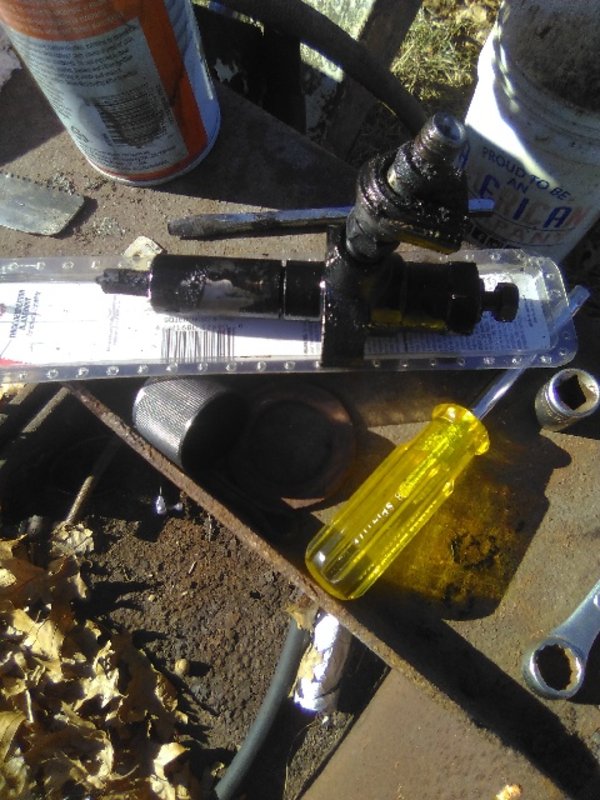

Yes I ended up removing injectors and Daisy is now soaking in a mixture of "PB Blaster" and "Marvel Mystery Oil". I figured if the leak off line came off easy I would keep going. The first injector almost had me give up. But I took that short piece off that passes through that rubber piece and was able to pry it up. The next three went nicely. The last bolt on the last injector almost got away! It happened to be a bit longer and had a washer. Taking those bolts out was nerve wracking but I am glad for the warning. I may not have been as careful. Planned on cleaning her up but felt it would be alright so I went for it. Hope that was not a bad choice, although I feel confident there was no contamination from dirt, or worse, rust from the hood.
The picture is injector # 3, but they all looked the same as did the bores. 2 came out with the brass washer, 2 left them in the bore.
Wasn't sure if I should put it all back together, but decided that would be best. There should also be a picture of the fuel shutoff. I had an old spare so spun one out and quickly spun in the replacement.
What should I do next? I did hand turn the engine a little each way everytime I oiled each cylinder.

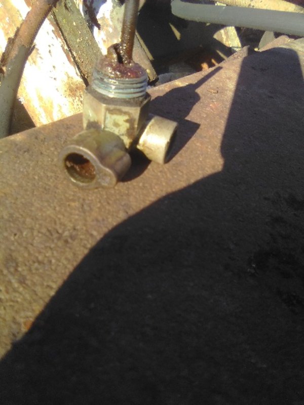

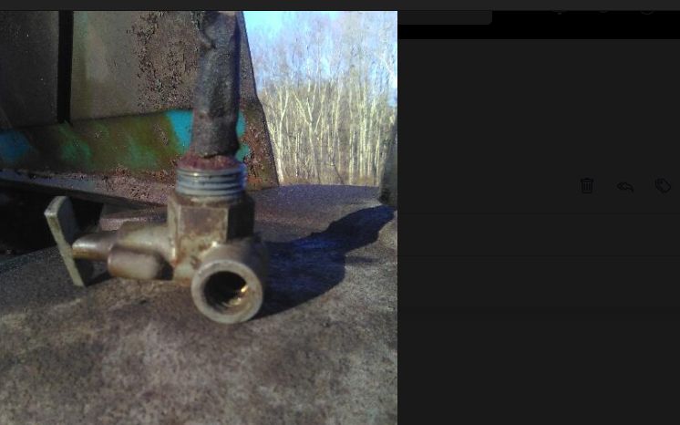

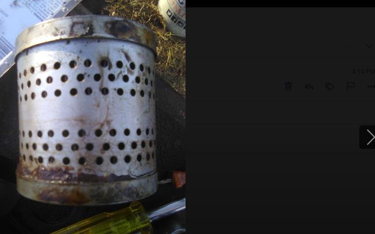

The fuel tap was in bad shape. When I tried to open it that valve came right out and would not thread back in. It was plugged solid. There was a screen on it but it easily fell off.

I'll get more pictures of the tap this morning. Believe it had "AC" stamped on, which I guessed was AC Delco?

Here's a better picture of the AC fuel tap Sandy. There is a part number if you have any interest, didn't get that side in the picture. AC lift pump like you said. Filthy, as was the fuel filter. Lots of clear water came out bottom.

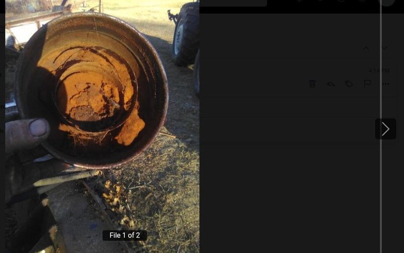

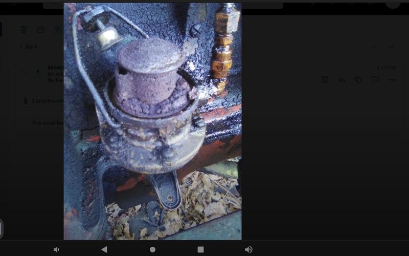

Hopefully this was to be expected? Air cleaner bottom is in bad shape as you can see. I had to work this morning so did not get as much done as I hoped. Taking it slow is probably best. Will need new fuel line from tank to lift pump. I have a new lift pump. I have a new fuel filter as well. I hate to steal lines from the Super, but I might. The fuel tank looks clean and I opened tap and drained until fuel was clean. We will drain the rest and start with fresh fuel.

Most of that needs a clean but little more, I think you'll find most of them will clean fine (I find new lift pumps don't look quite right and prefer to fix original ones, kits are available but be careful as they're often not quite right). The air filter bowl could be a bit trickier but that you'll only find out when you fill it with oil. Probably will need replacing (these were made by AC and Burgess, Billy's one is an AC one, If Daisy's one looks quite different it will be a Burgess one, parts are not interchangeable, only the complete air filter and only for certain periods),
that and the fuel lines would be best found in a scrapy or other second hand source as new ones are not great. The tap filter does look a bit like the parts book illustration, looks much better there nice and complete with the mesh and valve. The part no. on the tap it the AC one, not the Ford one (quite curious to see if it's the same as Billy's one). Glad you got good looking coolant coming out, the block drain tap should't really be a problem to open, they're made of brass and should free up with a little persuation. If oil mixture has come out I think that's good, can you now turn over with the decompressor closed? I don't recommend mixing pipes as only one is actually the same (the filter to injector pump one), all the rest are different and not interchangeable. Don't replace the water pump seal until you see it leak, you might be surprised. To change the seal you'll need a puller and press to remove and refit the impeller, which has to end up at 0.030" from the pump body. I don't recommend new pump bodies as they're wrong and normally for later engines anyway. What's the matter with the dynamo? A similar check as the starter should do the job, there's also the regulator in the dash buit it's normally well shielded in there and survives quite well. If you're getting new fuel in the tank I strongly recommend you use the old fuel to help you clean the tank, (the bit behind the steering column it the worst both for dirt and access, and it's worse on the later tanks as the hole is twice the size to accomodate the wiring, tachometer cable and throttle shaft) it works quite well and keeps the inside on the stuff it was made for, then you can use that diesel on rusty bolts and so on. Even if the inside looks reasonable you should shift some dirt by doing this. The water in the fuel is not great but as long as it's not in the injector pump or engine oil you should be fine with a good clean.
