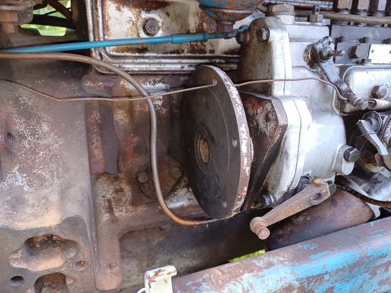

Hi guys I know it's been a while but I finally got round to post some more information. I know we said it was and Ebro engine but I cannot find Ebro marked on the block.
To answer this question from shepp
On the top of the cylinder head adjacent to the exhaust manifold, are there 3 numbers (such as 7 9 63) cast into the head? If so what are they?
My numbers are 76 30 12 6050-j m4
The only other markings I can find these which sit behind the dynamo DDN-6015-f
And a number 2 stamped in the block above where the injector pump is

Well I found the Ebro mark it is on the side plate you remove to see the push rods in the engine. The plate was so dirty and it was upside down I couldn't see it. So yes it's an Ebro engine. Does anyone know how I can tell what age it is. Now I've cleaned all off it has 9 12 76 on the block and as I've said 76 30 12 6050-j m4 on top. Does that mean the engine was made in 1976?

I think so. What number does it have on the back RH side of the block? It's supposed to be an engine number.

Mine has EBRO on the starter side of the block.
I guess also the rockers do have ebro on them.
Re: Tractor serial number begin and end with star
The block, cyl. head, rocker cover, tappet cover, sump... are stamped EBRO. Only the head and block have dates.

Thanks for all the info and help I appreciate it. I can't find anything else on the block. I know the rest of the tractor is a 1963 new performance super major fomoco and enfo stamps everywhere. Do you think it's a detriment to the tractor having had a replacement 1976 Ebro 55 engine in it?

Having a bit more information now I can confirm that the block was cast on 9 December 76 and the head on 30 December 76. The engine number 209485 fits for early 77. See what there is under injector no. 4 and what type of injector pump you have, as that will help too.
