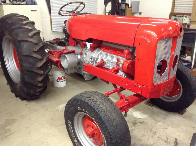

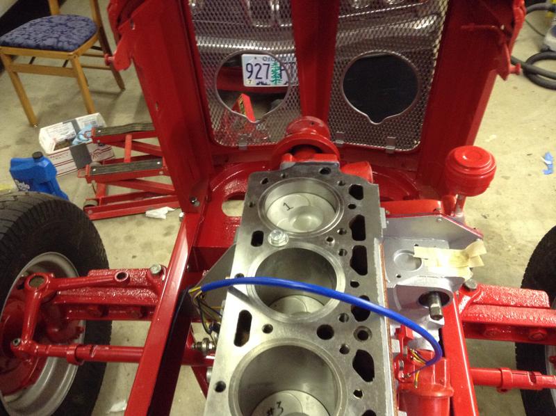

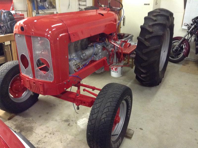

1su9pm6aj4
- Posts: 94
- Joined: Sat Jun 29, 2013 7:42 am
Re: stuck in gear
Mathias1, good info on hi/low, of course I should have known that, ill check that out. J C and Adrian, Ill also check the brakes. I am not based in Los Angeles, I got the injector pump rebuilt by Dumas because I was working down there for a spell and took my pump with me from Oregon. The owner of Dumas in Long Beach CA. was very familiar with these injector pumps although he had not seen one for a long while, he said they were used in lots of boat engines with the Perkins Diesel, he being in a port town should have had plenty of business back in the day.
I bought my Fordson from a guy in Stayton Oregon, it had the badge of Ford 5000 on its side. He sold it for the price he paid for the new back tires (8oo dollars), it did not run, had a blown head gasket. He tried to pull start it a few times and that is why I think the cam gear teeth were bent out of whack. I also couldn't believe how non existent most of the cam gear lobes were when I disassembled the engine, he did say it ran well before the lock up, go figure!. I hope the new cam shaft I bought is made with better metal.
One interesting bit of info about this tractor, I went into a New Holland dealer in the next town over (close by) for parts and dealt with a salesman that thinks he was the original salesman on my tractor. He told me was the sole dealer in the sixties for Majors on the west side of the mountains which would have included Stayton Oregon.
As far as posting pics I will have to get my nephew over here to guide me through it. At least I have a smart phone now so it should be easier. Looking forward to seeing yours also.Kerry
1su9pm6aj4
- Posts: 94
JC
- Posts: 1092
- Joined: Thu Apr 17, 2008 3:48 am

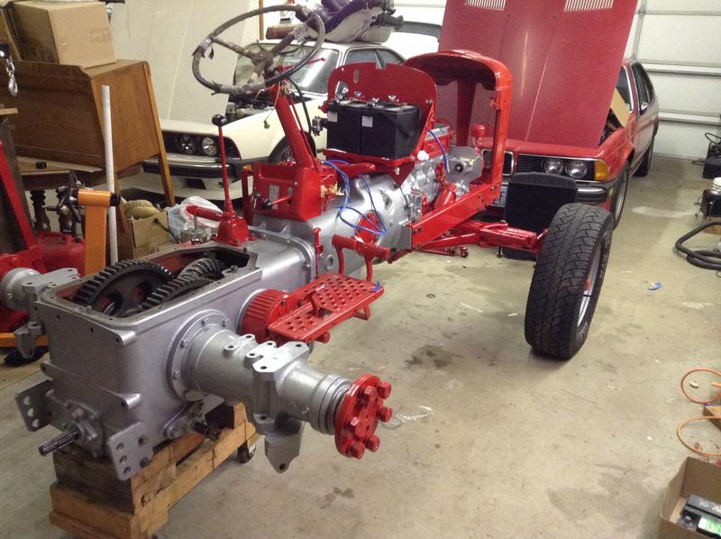

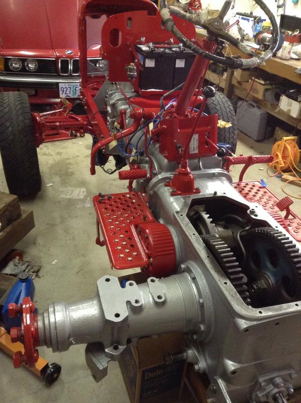

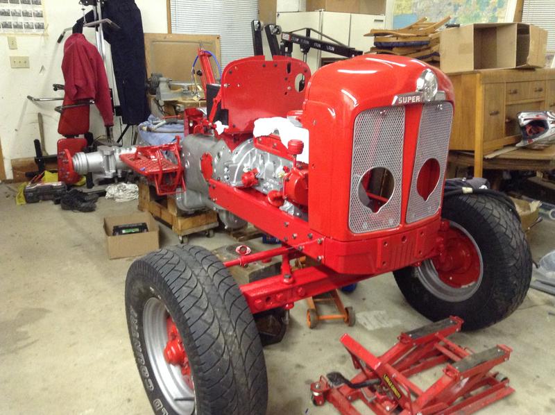

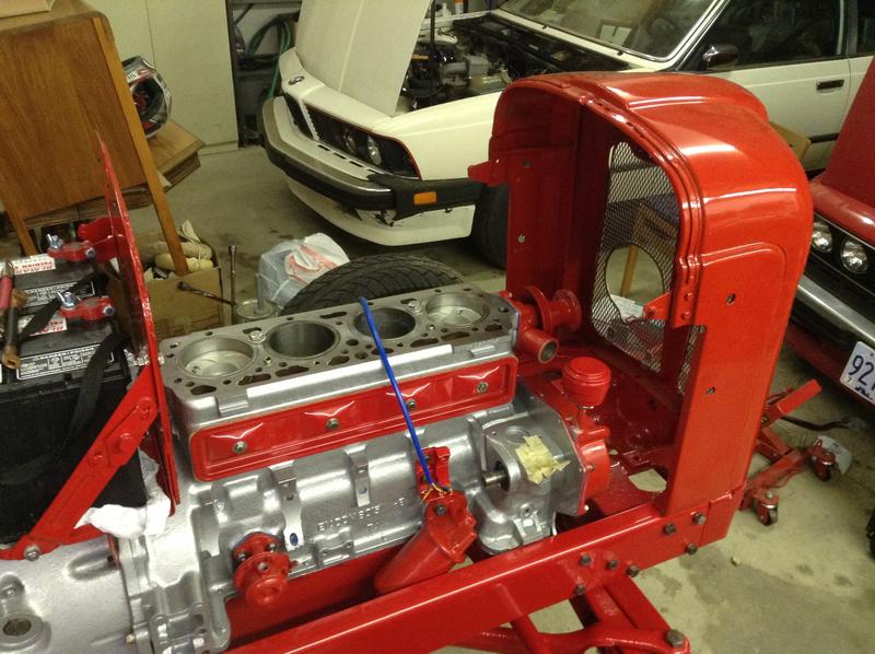

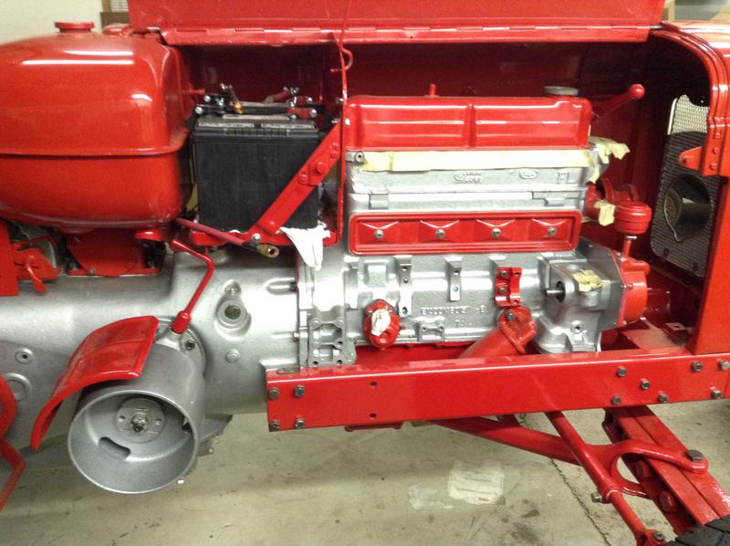

- Location: Montague Calif. USA
Re: stuck in gear
That looks really sharp! It looks like you have put a lot of time into that tractor.

Re: stuck in gear
Dispite of the colour, great looking tractor and yes what a neet job.
You have to turn the belt pulley one hole back to get it in the right position.

Re: stuck in gear
thanks JC and Henk, yea lots of time into it for the first few years, Hope I can "close the deal" soon. Ill remember to move the pulley counterclockwise one hole when I put it back on, thanks for that. Cheers Kerry

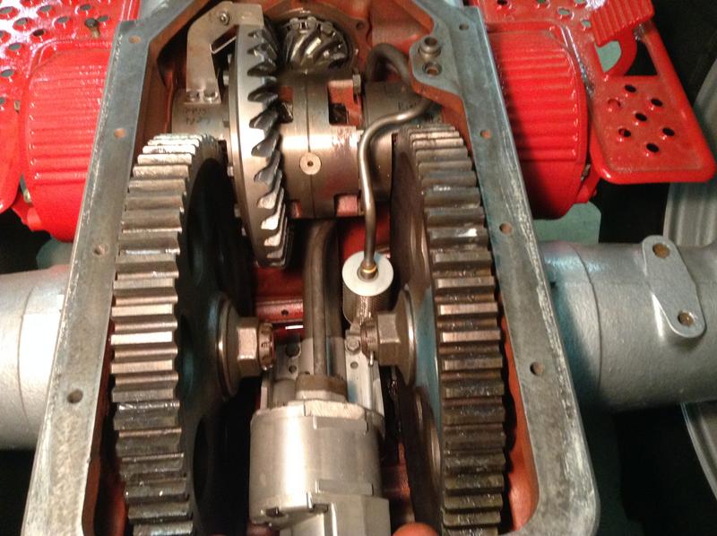

Kerry, if you work it, you'll love it!
Look at the gears in the rear axle housing. This is a Sherman tank!
The engine needs heavy work so as not to glaze up. After everything you have done, it would be a shame not to let the revitalised (by you) machine do what the Ford engineers designed it to do.
