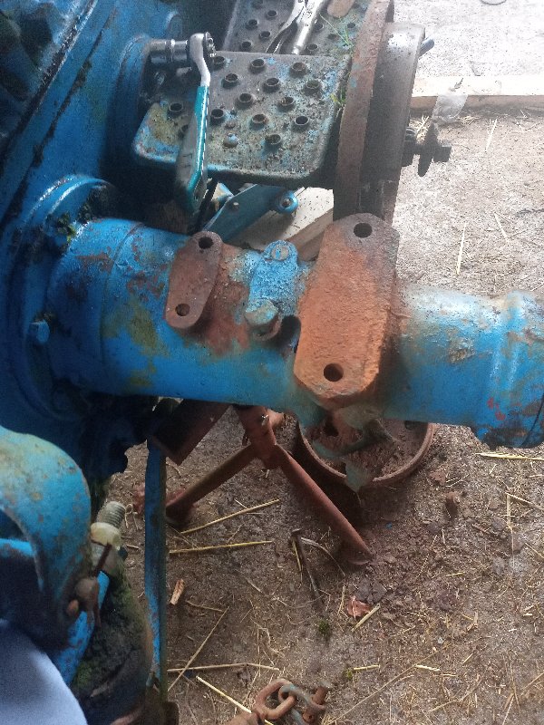

Well my parts never arrived from agriline, but I cracked on with the front axle, the axle casing is quite worn I think but not sure, there was only two bolts holding it on with the rest sheared off Image

Image gonna try drill and tap these, or would I be better off trying to find a better second hand unit, can I have your opinion please
