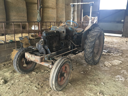

Current progress is stripped old tractor and engine down ready to be removed:

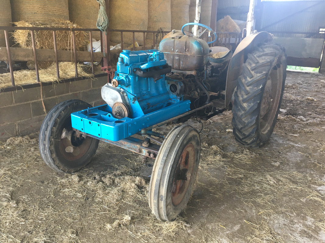

Checked new engine and all seems fine inside, so cleaned and gave some paint:
Fitted new oil and fuel filters... now for some lifting equipment.

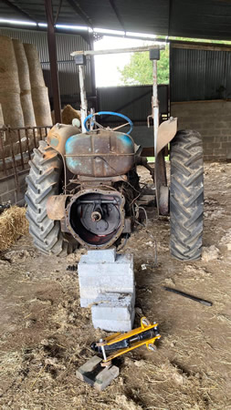

Busy day today, got the front axel off:
Then, got the old engine off:

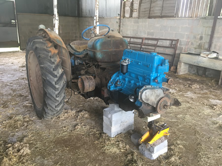

Then got the new engine on, yay:

It's ok, wheel back on now.

Dave's concern was not the absence of wheel but the stack of building blocks supporting the weight, if you have not actually seen a stack of these under minimal load suddenly disintegrate without warning you will not appreciate the warning - timber or steel is safer :)
