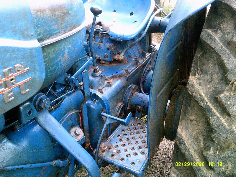

Hi I have a 1959 power Major.
It currently has a rubber hose that comes out the valve and bends round under the seat.
I would rather have a metal pipe coming out the valve and going straight out the back.
I believe that I should be a metal pipe?
I have attached some images of the current setup.
Where would you source the metal piping? Can I use galvanised water pipe fittings or can you get something that is made for the job?
Thanks in advance all

Hi Will
Yes there is a proper metal tipping pipe for the major, they do come up for sale on ebay occasionally. The only new ones i have seen for sale (agriline) are for the super major and they are different. As for using galanised pipe, i have seen it done but personally i wouldn't want to be sitting anywhere near one if they decide to go bang! Proper hydraulic pipe is seamless, galvanised pipe isn't and is only designed for water pressure

Re: Hydraulic remote valves for trailers - Metal piping to replace the rubber
Hi Sandy, is that a super major pipe fitted to Billy? Both my power majors and the old diesel major have the pipes running under the cross shaft
