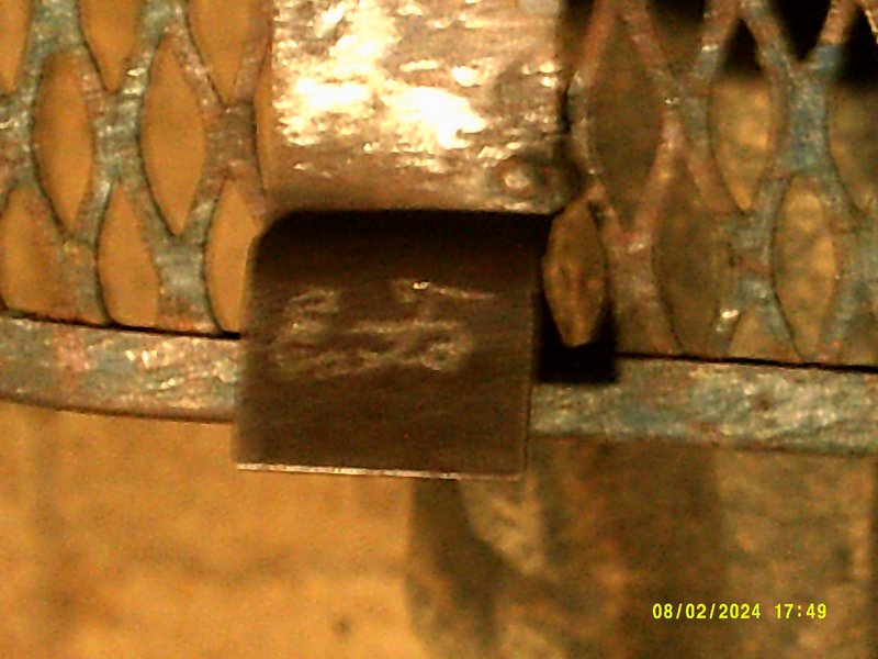

Can anyone with a 1955 Major with original grills confirm if both lower supports were stamped EnFo?
If not did the other one have something else (a part number perhaps). Billy lost his outer support (nearer the side of the front cowling) on the LH grill ages ago (well before we got here) and we're hoping to make a replacement one that doesn't stand out as non original.

Hi Sandy
got a couple of old pairs of grilles, from an early diesel major and a later power major. Both pairs have 'enfo' stamped on both bottom supports

Just a thought, but i believe some of the old enfo spanners had the logo in raised letters on them, if you had one with the right size logo you could maybe use it to stamp enfo on a new grille support?

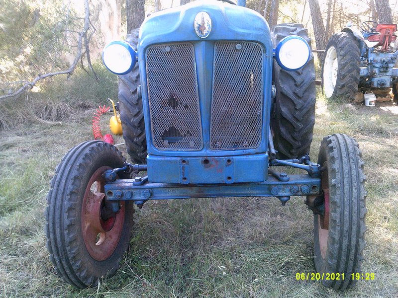

I used a modelling knife, just to mark it (no pic of it yet), a friend has the right tool for doing it manually, and as I'm hoping to sign paint our JCB Mr. MacGregor and patches on the badges that are bare; this is a good challenge too (although quite different in many ways). There's also the serial number to do on the new serial plate, I'm hoping to do both at once. Here's how the front looks now (notice Super Billy in the background):
Unfortunately we're lacking on Ford tools, the closest being an injector spanner (not stamped, but it fits perfectly).
Re: Grill markings
Is super billy a Fordson or Ebro 55?
Re: Grill markings
Super Billy is (I think) mainly a Super 55, but he has many Ford bits, and he's (hopefully) going to look like a NP Super Major sold by Ebro (with slightly different cosmetic features). We'll get there when we finish the engine and front axle.

Just got these done definitively now. The grills still need proper fixing.
