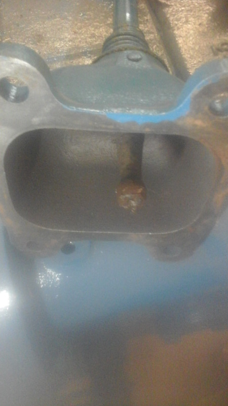

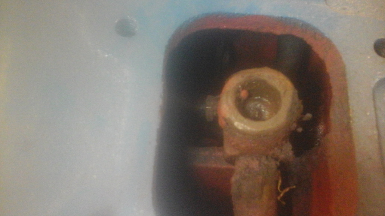

G'Day All, I am posting some photos of the broken part, is it possible to tell whether it is gear?, I can move the selector in the gearbox side to side quite easily, so I think it is neutral. and I would like to know what the selector and the part that is rusted into it is supposed to look like. I have had a look at the parts drawings and cant quite make it out, so if anyone had some photos that would be most appreciated. Also , any clues as to how to remove the broken ball end, I guess I will need heat??
Thanx again for your help
TrailB
PS Sorry to ask so many questions :D
Posts: 2560
Re: Transmission stuck on parked Major
That does look like neutral, that gear lever is very worn by corrosion, you'll be better to remove the socket, held on by a sqare headed bolt with locking wire. Then look for a good second hand gear lever and socket.
