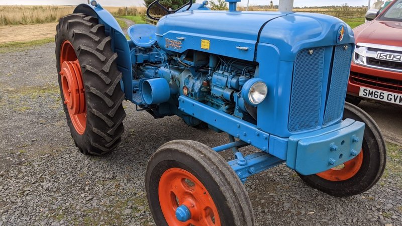

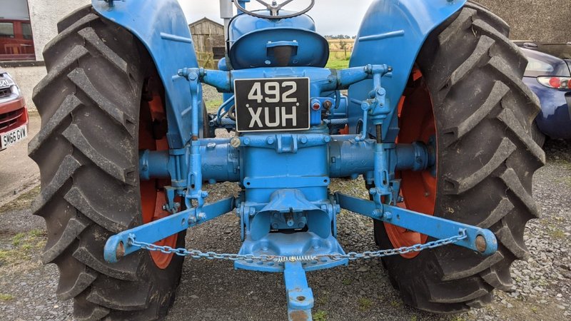

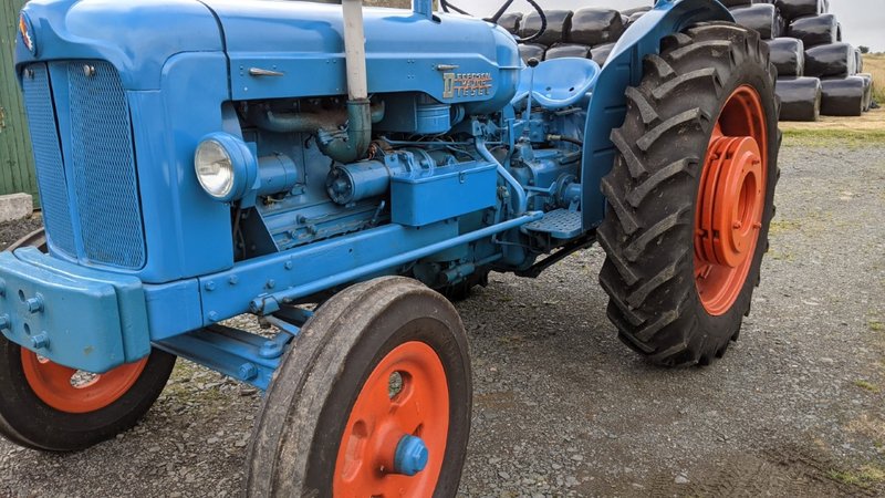

However, I have bought a Major.
Reg no. 492 XUH; ser no. 1316624
Seems all in good order, starts instantly.
I'll have to work out the way to post images. I believe that I need to register on another site first.
Kevin
