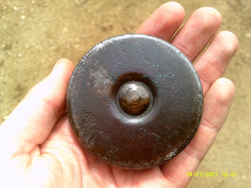

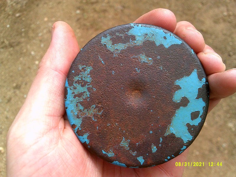

Posts: 2559
Re: Fuel tank breather
Here are the pics.
This is the early cap (Billy's one), used on early Major's,
this one (Davie's one) is the late one, you can see the valve in the centre.
And just in case, here's the Ebro version of the second cap, as used by Super Billy.

AC made the later type cap, as you can see in the pic.
Tue Aug 31, 2021 11:01 am
