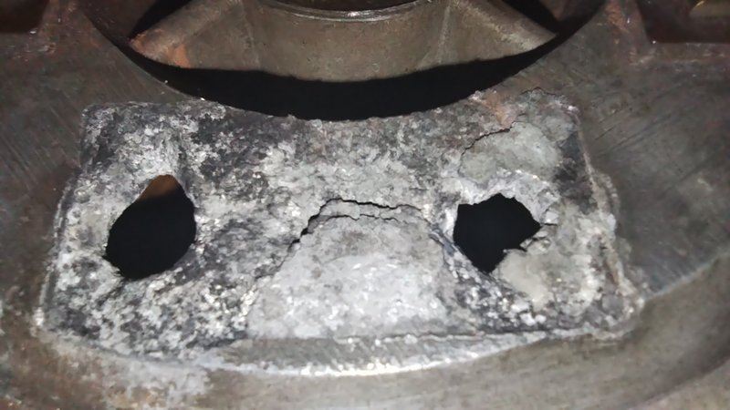

Well I pulled apart the starter motor to inspect of I can see anything. A lot of aluminium balls rolled out of the housing when I dissassembled it. Then I noticed, that behing the brushes that are connected to the comutator end and not to the coils there is melted surface like there was some arcing. This would also explain the smoke coming from the comutator end when I tried to start.
Does anyone know what could cause this? And what could I do to fix it?
The brushes themselves seem OK, they still have a lot of material on them.

That doesn't sound good. Inspect the commutator end plate and commutator for damage, it sounds like the commutator end plate has melted. Some pics will help to see what's happened.

I disassembled the starter completelly and I found that one of the brushes was actually worn. It was this one, that had the surface melted underneath.
I changed the brush and now Iam wondering about the backplate. What could I do to repair it. I thought about making a plate with threads to mount the brush housing and placing it from the outside of the backplate. This backplate should be then connected to the earth?

You could try filling the melted surface of the backplate with JB Weld or similar, file it back flat and very accurately re-drill the holes. Re-fit the brush holder with an added plate on the back as you describe for extra strength. If it is fitted in the correct place i can't see any reason that it wouldn't work

Looks like the brush being worn went unnoticed, a bit like someone held the starter lever down with a poor battery (poor enough for the starter not to turn), eventually causing overheating and melting stuff as a result. John's solution sounds good.
