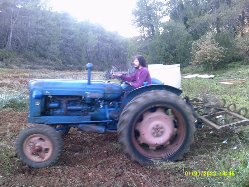

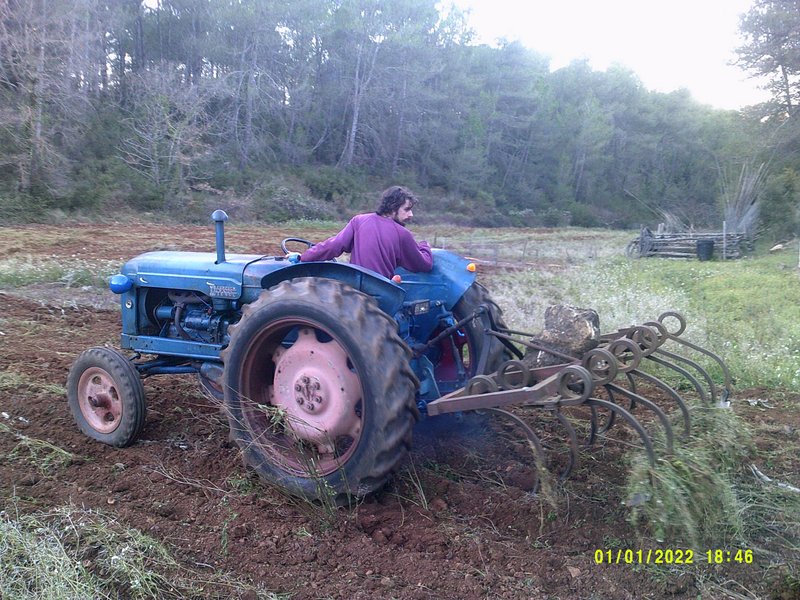

Hi Sandy, slightly off topic, what type of rear tyre is that? We used to have semi industrial rears on our diggers with a 'J' lug on them but I've not seen a 'T' lug like that before.
If it works, leave it alone.
Re: Servicing and finding new unusual features
I have to say our camera is very bad for focus and you often spend ages trying to get a good one. Any pic in the barn is likely to be on the dark side as the lighting in the barn is pretty bad even for just doing things, and when you try to light up something you end up with a worse pic (one patch far too bright and the rest still too dark). I should also say that I'm not very good at photography anyway, so I should probably try to improve a bit too.
The T lug is a Firestone type that was very common here, but these particular tyres are actually retreads of General tyres with this tread, we got these nearly 20 years ago very cheap as the guy we got them from was trying to get rid of them and they've been really good as they show very little wear for the use they've had.
