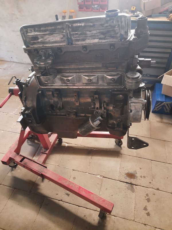

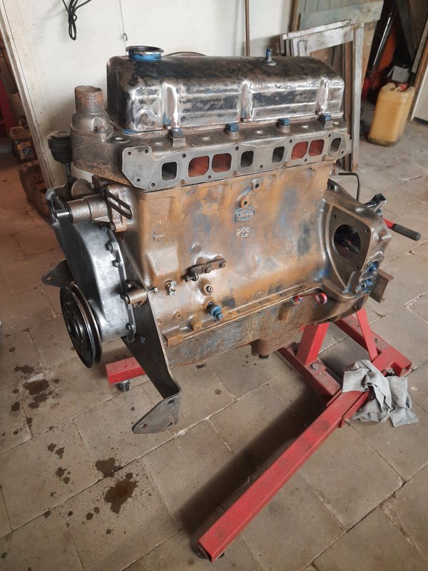

Well,
a little update on this: viewtopic.php?f=2&t=7733&hilit=engine+rebuild
Due to other duties I haven't been doing a lot on the tractors and same for the rebuild engine.
It's still sitting in the garage, so the plan is to continue and swap the engine in the super major. It's time to get the job done.
Just wondering if I should give it some paint before install, or after?
Any ideas on renewing the clutch while going through the process? It has the heavy 13" single clutch
Re: engine rebuild
Paint it before you fit it and touch up any chips/scratches once it's in. I've tried both ways and it's definitely easier to paint it on the stand! Put an acid etch primer on all the aluminium/alloy bits first or the paint wont stick properly
