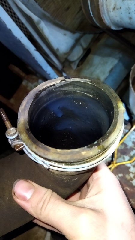

On my Power Major I can not achieve more than 1400 revs. Even when im stationary without any load. Based on informations here I tried to disconnect the air hose from the air inlet. Then I managed to get 2000 revs no problem. Then I inspected the air cleaning unit and found the steel filter completely clogged with gunk. I soaked the filter in petrol for night, cleaned thoroughly. I then reassembled the air hose to the air cleaner and tried to start without the oil bath and filters. Again 2000 revs. So I was happy that the reason might be only the clogged filter restricting air flow. Im assuming now that the air hose should be ok, when it worked with it.
Today I reassembled everything, topped the oil to the line and again only 1400.. I needed to take some wood from the forest with the tractor and after coming back I dissassembled the whole thing again and found aprox. 1,5cm of oil gone and found oil in the air hose. So the engine is sucking the oil through filters.
I noticed that the air filter has only one layer of the steel filter(the removable), the rest to the top is "chiseled out" there are only some very sharp remains.
Did someone had something similar? What could be the issue?

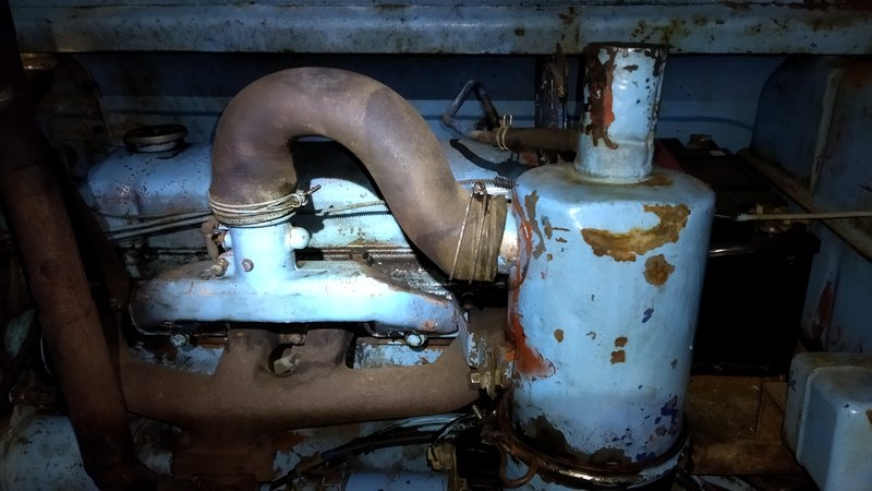

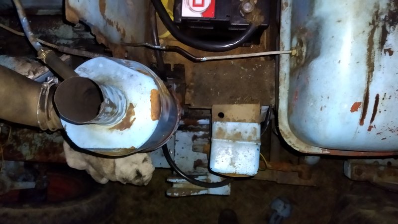

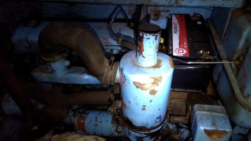

Well the situation is even more complicated by the fact, that previous owner wanted to use some bigger battery, so he moved the whole air cleaner unit closer to the intake and shortened the hose. Dont know if that could make some difference.
The air cleaner look like this:
I have never seen the inside before, the amount of gunk is quite alarming.
I will probably order new air cleaner. The thing is that i dont know if how this affects the loss of power/ unability to rev. the engine higher than 1400.

I think you have 2 problems here, the wire mesh has been removed from the filter so there is nothing stopping the oil being sucked into the engine, but also the filter is far too close to the engine. The oil in the filter is not meant to get hot, but being so close to the engine it is heating up and getting thinner making it even more prone to being sucked in. It's hard to see on the pic but you should have a solid bulkhead between the engine and the filter that prevents the heat getting to the filter and battery. The gunk is from the engine breather coming from the rocker cover, this is just oily fumes coming from the engine, another reason not to let the filter get hot, the heat is baking the oily fumes into tar. If it runs ok with the pipe off, then a new filter put back where it's meant to be should sort all your problems
Re: Low engine revs + air cleaning issue
The position of the filter shouldn't be relevant (think about the Dexta John, the filter is not really sheltered yet there's no trouble with heat, and Billy's air hose has lots of condensation on it after ploughing showing just how cold it is to spite being an inch or so from the hot exhaust manifold), it is recoverable but you will need new mesh. Have you adjusted the high rev throttle screw on the manifold? You shouldn't really run above 1600 rpm, although you need to set the no load speed at 1800 rpm with the air filter fitted and in good condition. What does the bowl look like? The dirt in there is quite normal, although you are right to want it clean.
The Dexta filter is closer but the engine breather doesn't go into the filter (at least i don't think it does). I think the combination of no gauze, hotter thinner oil and oily fumes being dried out by the heat is the problem. You are probably correct Sandy that if the gauze was intact it wouldn't happen, but i think the heat drying out the engine fumes and clogging the gauze was probably the reason it was removed, so if a new filter is fitted in the same place then the engine breather needs removing from it and just running to the floor, same as the Dexta

Looking at the pic again i still think the filter is way too close, it's touching the exhaust manifold. The oil in the filter must be nearly boiling, if nothing else the engine is drawing in hot air, not ideal for combustion and efficiency.
I don't see it touching the manifold, I would say it's about 1" away from it. I still think that there's no problem for the filter being there as it has a high flow of cold air going through it that won't notice the exhaust temperature much at all. Having said that I would move it back anyway so it fitted in properly, but if Soukup needs his Power Major back at work urgently it should be fine where it is for now.

The pipe looks a little bit suspect at the manifold end (or is it just my failing eyesight!) maybe it's collapsing in causing a restriction? Something is partially blocking the airflow to the engine when its all connected
I can't see the pipe collapsing but it's definitely something to look out for as well, as it's well known for causing slow running.

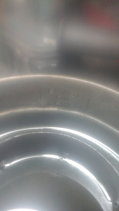

Well, when i got the tractor, I cleaned the bowl completely and filled with oil. It was nearly empty and very dirty. Now it looks like this.
I will order the air cleaner. I already have new air hose. It will be a bigger operation though, there is a bracket welded on the battery platform to allow mounting of the bigger battery. The wall between engine and battery is also cutted. I need to figure out some way of fixing the filter where it bellongs.
Still im not really convinced that it will solve the revs problem. But it is a first step.

There seems to be a 2 views on the oil level in the bowl. Some say the air should pass through the oil in the bowl, while i was always taught that the level should be just below the bottom of the intake pipe so the air turns 180° over the top of it as Shepp describes. I have always filled the bowl to the level of the 6 holes between the 2 chambers, but looking at 3 different Major filters bowls, one is clearly marked 'oil level' with arrows to the line in the side. This level definitely puts the oil above the bottom of pipe which seems wrong to me, surely this adds restriction to the air flow and increases the risk of oil being sucked into the engine. Maybe i was taught wrong, but i have spoken to alot of others who agree with me, and some who don't. Be interesting to hear other views on it, if the level marked is too high, it could explain some of the problems Soukup is having
Looking at an old Ferguson manual it says the bottom of the tube should be immersed in the oil, so maybe i am completely wrong, the older i get the easier i get confused!
As there are several kinds of filter (two main groups made by AC and Burgess) it's quite possible that parts have been mixed up and the level is wrong. Having said that, the bowl and removable mesh that Soukup has are the same as Billy's ones which work fine. I think the oil level should be below the pipe but only just, to catch all the dirt.
As for returning the filter to its original position I had already thought that it would be a big job as there has been a major change to the firewall and battery tray, the air hose would also need to be replaced when you get there. I would start by getting the replacement mesh for the filter body, then seeing if that sorts the oil being sucked in, when that's sorted you can try to reset the high rev throttle screw on the manifold.
