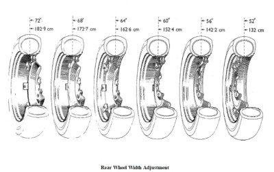

If you have the adjustable wheels like Sandy says, these are the possible wheel track:
72" 182,9cm
68" 172,7cm
64" 162,6cm
60" 152,4cm
56" 142,2cm
52" 132 cm
Posts: 2323
Re: Super Major rear wheel adjustment
I meant to find this diagram but I couldn't remember where I had it. I see you're using attachments Mathias.

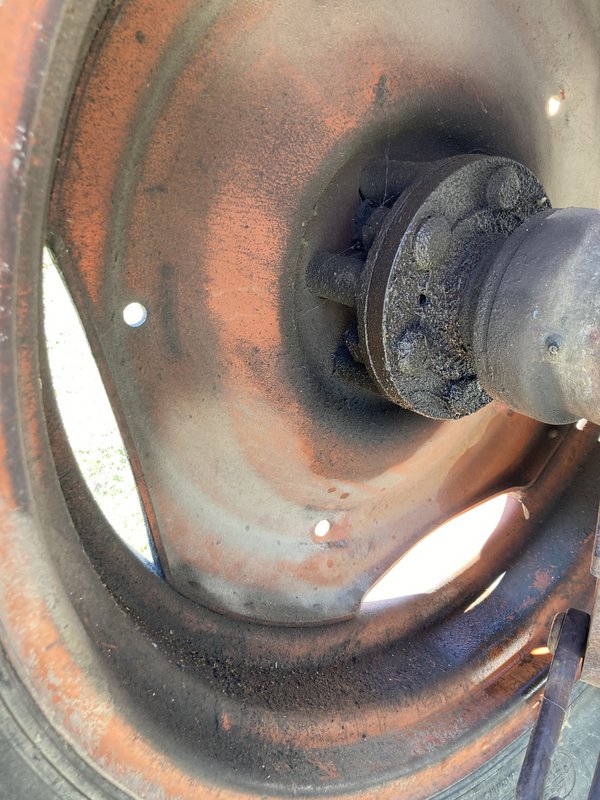

Tractor has solid (non-adjustable unlike those in diaggram) steel wheels (orange so I think they're stock wheels) and 16x36 tires.
Posts: 2323
Sounds like you have odd wheels, could you post a pic please? 16-36 is huge.

Posts: 812
I have these style of wheels on my county, but they are also reinforced. JCB did have them too.
You can see they put a spacer between the axle and the wheel. You can try to install the wheel without them.
Posts: 2323

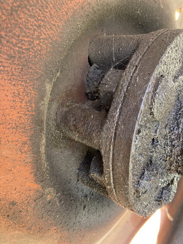

These are the usual 14-30 wheels (which are not std but a factory option for heavier work), the spacer is a non std extra and might help in setting the correct wheel track.
Keep an eye on those rear axle seals!
Posts: 563
Looks like the grease nipple is snapped on the back axle, a good greasing will very often stop the seal leaking
Posts: 2323
I think the nipple is ok, but if it isn't, it looks like it's the knock-in type. Heavy greasing should keep the leak under control as you say John.
