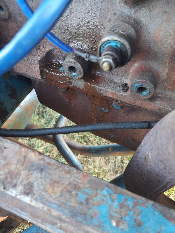

Yesterday I did a test run with the selene.
she got some leaks around the sump.
This should be an easy one: copper washer
This scares me a bit:

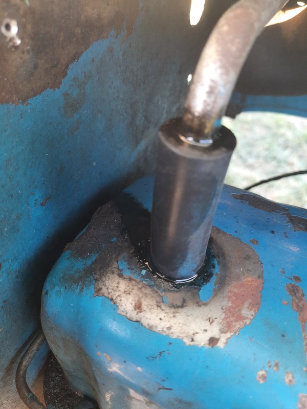

I must say there is also oil coming from the inlet manifold, maybe the oil level in the air filter is a bit high.

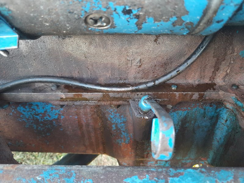

And also a strange spot (I forgot to take a picture) on top of the flange between gearbox and rear end. I noticed the oil level is there also higher then normal. Will need to check the gearbox I guess.

I think the oil on the sump is spilt from the manifold and breather pipe, give everything a good clean and run the engine seeing where there are leaks and how the oil comes out. Check the tightness of the bolts near the relevant leaks, it will save a lot of work if that stops the leaks. The breather pipe rubbers might need inspecting too. It does sound like the gearbox to rear axle seals might not be good, but try to see if the two levels are the same or not so you can replace the right seal (unless you want to do them all anyway).
Re: some oil leaks
Rear axle. Start with pto seals before taking it down completely

I'd have thought a fibre washer would be better on the valve chest. The pipe to tank leak looks like there's been some force on it by the way the paint is off all around the joint. A bit of brazing on both joints could be all it needs.
I don't think we know what has leaked, but if it does seem to be the PTO seal it should mean the oil is at the same level. If it's not it's the main seal (the oil wil be just below it in the gearbox).
It's one of these copper washers that gets crushed when you tighten the bolt, it could just be a loose bolt.
Hair Bear wrote:
Sat Aug 06, 2022 1:23 pm
That's actually the breather pipe to the air filter, and it fits on with rubbers, they often get cracked and leak, Dunlop Tractor Spares had new ones.

Emiel wrote:
Sat Aug 06, 2022 12:55 pm
I'm afraid it will be the seal from hell (the upper one). I checked and the oil level really dropped a lot in the gearbox. And I almost did not use the pto, only a few minutes to try the winch.

"That's actually the breather pipe to the air filter, and it fits on with rubbers, they often get cracked and leak, Dunlop Tractor Spares had new ones."
Doh! I can see it is now. :oops: Why I couldn't identify that earlier I have no idea.
Yes it's the breather pipe, didn't know it would suck that much oil?
good point, will measure those levels. Anyway, when all the oil has to come out, it's almost half way the job.
I still have a spare double lip seal that can be used here.
And this one does not have a hydraulic top, so not possible to pump it out using the tipping pipe.

mathias1 wrote:
Sat Aug 06, 2022 11:29 pm
Billy leaked a bit like that in the area, I managed to seal it off a while back (Billy has a different system), it's the mist from the spray in the crankcase, and because there's the breather, it gets sucked out by the powerful vacuum in the air filter (or an even higher vacuum in the intake manifold like Billy), unless the rings are bad.
mathias1 wrote:
Sat Aug 06, 2022 11:34 pm
That's a bit inconvenient, but if it is the PTO seal there's much less work, particularly with the Selene axle.

I replaced the rubbers on the breather pipe and so far so good.
And for the gearbox seals. I did manage to replace the PTO seal in the gearbox, but same result. This means it's splitting time. I've done this already on my other 2 tractors, but now just lacking time to do so.
