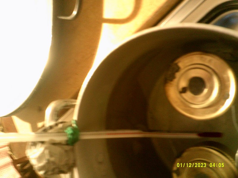

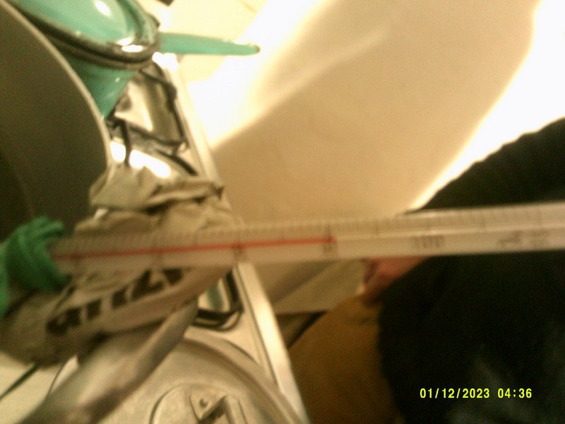

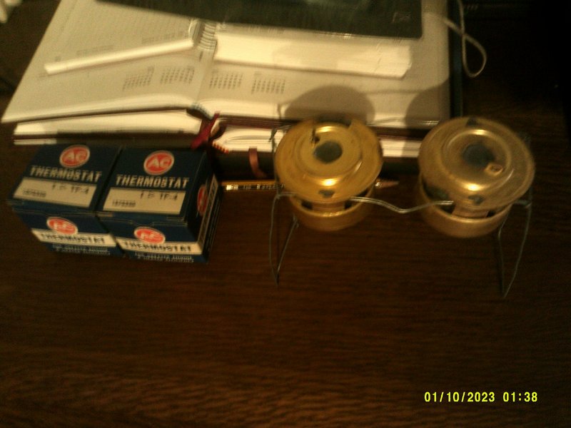

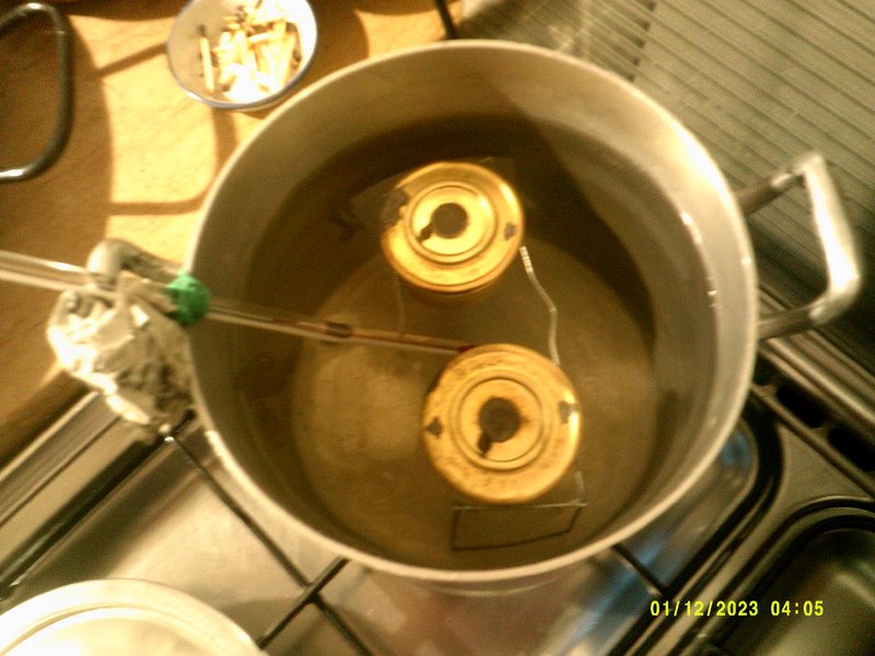

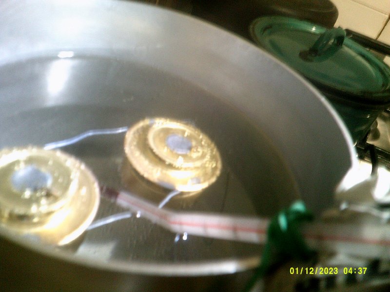

Well in the end we brought them, to be honest my biggest concern was actually security because of the motor fluid but we were very lucky, but it is worth having that in mind. They actually flew twice on pretty empty flights so they would have got as much stress as they would get from a normal flight. Once back we tested them, and here are some pics (and as usual they're not great):
As you might or might not see the thermostats did open, one at 185ºF and the other at 189ºF. This made it quite easy to decide which one for each tractor, the cooler one is now in Super Billy, to spite the engine not yet being fitted. The hotter one is for Billy as and when he needs it.
