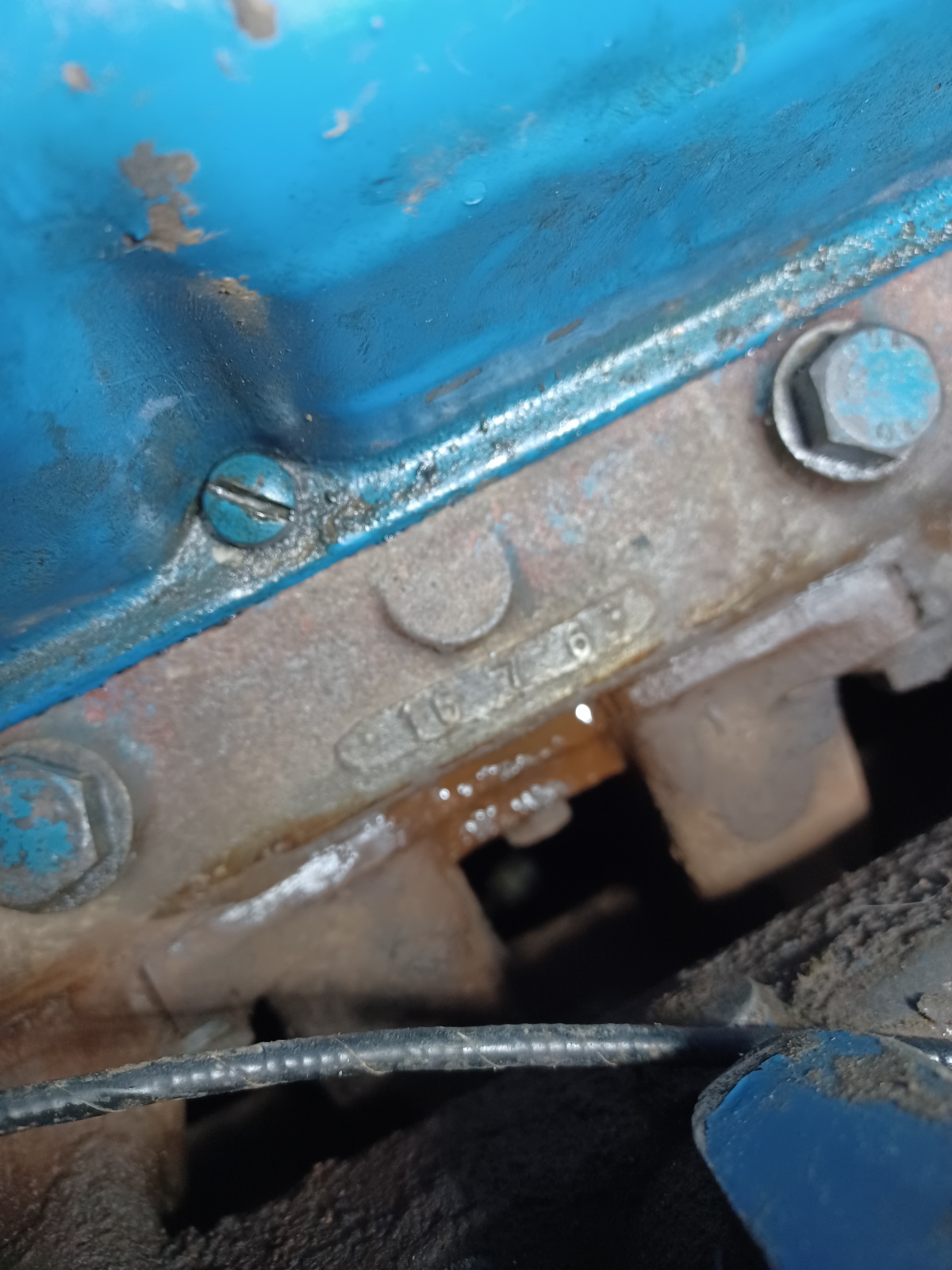

I did take another look at this today, as i have aroad run tomorrow (last one for this year). First i Did retorque all head bolts. Then i found out there is a crack just above the inlet manifold. There was some water dripping out.
Just wondering if it is possible to weld or I need to look for another head.
I'm also wondering this is the original head. I did take a picture of the casting code

That looks like an Ebro code, I would have a go at welding it but be ready to get another head just in case.
