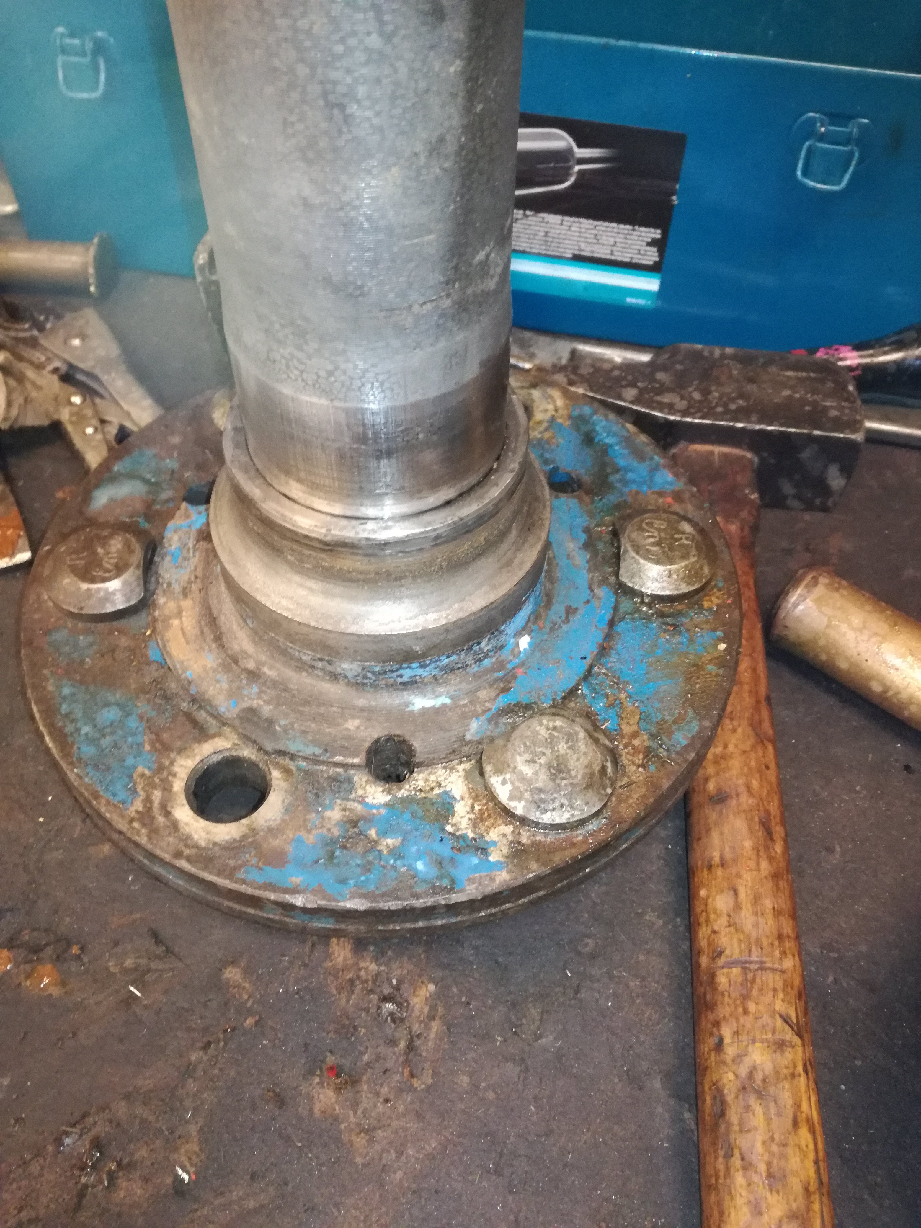

Hi, I’m hoping someone can identify this halfshaft for me, it has a removable collar that the bearing sits against. I’m guessing it could be an industrial? The problem I have is that the new seal and metal retainer it does not sit up the shaft enough compared to the other side. I think I need a different seal and retainer but struggling to find anything or failing that a different halfshaft. Here are the pics attached thanks in advance

That half shaft apperas to have imense wear, there is no separate collar, so I can only think that it's been interfeared with beforehand. Did you remove a tapered roller bearing? If not this collar is probably the old bearing inner race. I'm afraid you now have a very difficult repair to do, unless you find a better half shaft which might well be worth doing. There are often many mistakes with repro parts, but I think the rear axle seals are one if the few they get right, the fitted seal and shaft should look like this:

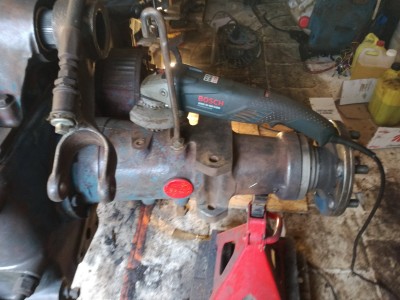

Picture of one of my tractors.
I did need to modify the new seal to fix it

Thanks for your replies that photo is exactly the same as mine with the collar attached to the shaft. Can I ask how you modified the seal to fit as it won’t go far enough onto the shaft to fit about almost 10mm further out to the other side with the standard super major shaft on.

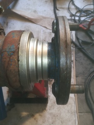

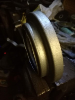

I did cut off the outer ring. I hope the pictures will make it easier to understand.EdWaters wrote: ↑Mon Nov 07, 2022 8:21 pmThanks for your replies that photo is exactly the same as mine with the collar attached to the shaft. Can I ask how you modified the seal to fit as it won’t go far enough onto the shaft to fit about almost 10mm further out to the other side with the standard super major shaft on.
the first picture has the complete seal, the second one is how i got it fitted.

Notice that my axle has a little diamond. This might be the not so standard heavy duty axle.
this picture is the one I put on the Super 4

I’ve done some super rear axles in the past where I needed to modify the seal housings due to the exact same problem. Just cut of the exces part and have no further notice. Did work for me and it sealed also.
