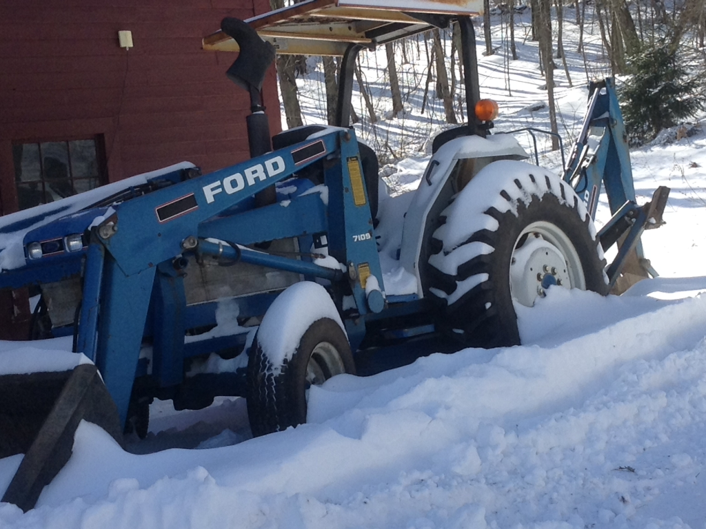

A picture of Phil from last winter:
url=https://postimages.org/]Image[/url]
Re: Toolbox mounting
Looks good, but I'm not surprised you needed a heater!

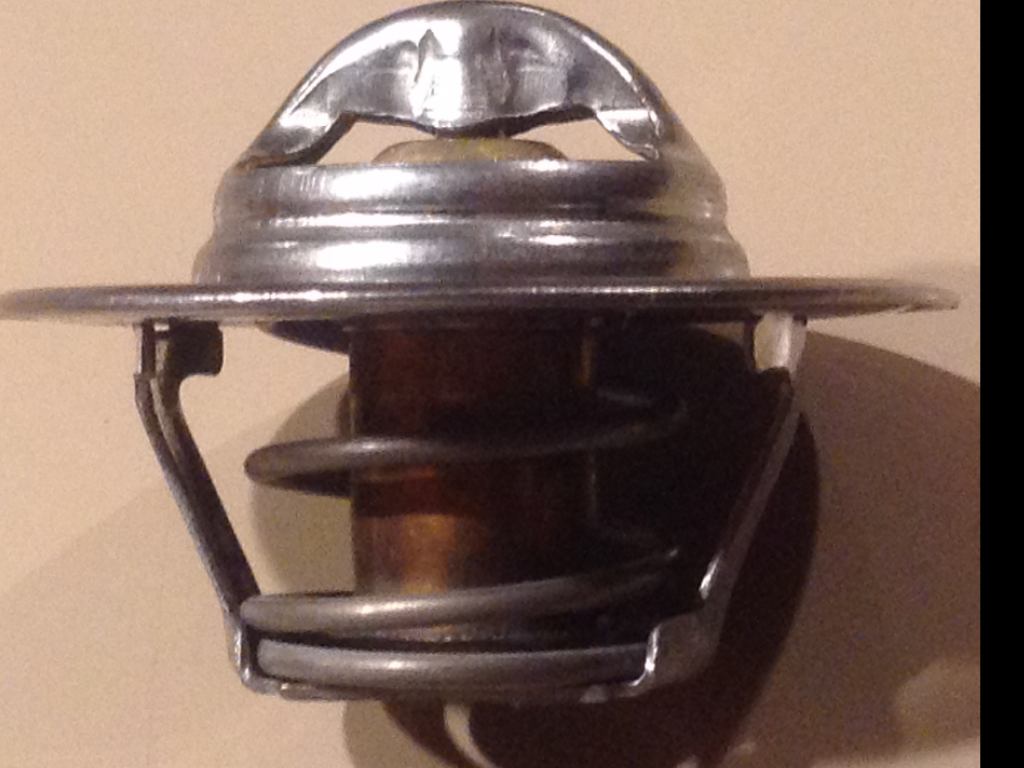

Sandy here is a picture of one, but the one in it is identical. I took one from an old Ford truck engine, and it looks the same as well.
I think I was installing thermostat in wrong order. I was putting the 'stat in the head, then the gasket, then the connection.
Parts book shows gasket first, then 'stat, then connection.
Sound correct? I only got to run Hyacinth for a quick loop in the woods with just me on her. Only got up to just under 170F.
Hopefully I'll have time tomorrow to work her a little harder.
Stand by for picture....
Thanks for the pic. The parts book is wrong, the repair manual says thermostat, gasket and outlet casting. I think you do want a shim in there, if you could post a pic of the head and outlet too as I don't know if they're in good condition (like our half Super Major) or badly corroded (like Super Billy). It might also be worth seeing if the thermostat actually opens at the set temperature.

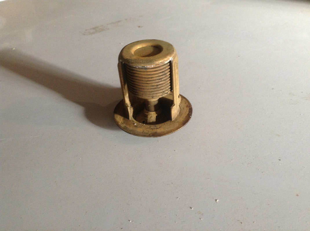

While scavenging around looking for thermostats I found an old interesting one from a Volvo Duet. Smaller than Hyacinths.
Not sure if this is a shrouded thermostat.
url=https://postimg.cc/RqDj3nQL][img]https://i.postimg.cc/yY1BbmDt/image.jpg[/i
That's a nice thermostat! It's not a shrouded thermostat but it is a bellows thermostat, Hyacinth would have started out with an AC TC2 (or similar) which looks almost identical. That seems a bit cool, but it might just be you need to work a bit harder to see. Definitely worth seeing if the temp gauge is accurate.
