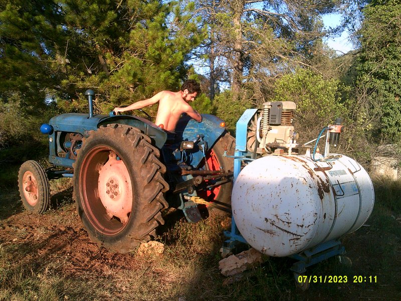

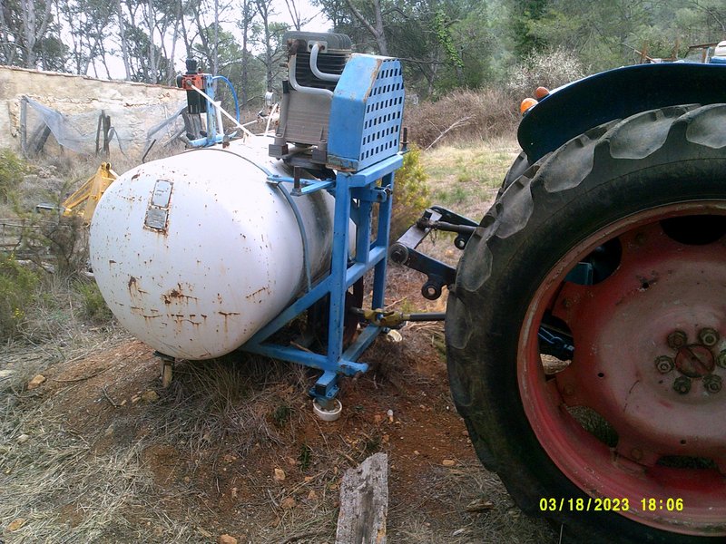

We recently got this compressor that Davie has been charging marvellously (we also got a cultivator and mounted box), but we're hoping Billy can do it so he uses his PTO (it's also rather heavy for Davie to carry around).
Having read about all the stories about PTO castings suffering from running at 1200 rpm I was hoping to see what whoever is used to using their Major's PTO thinks about it.
Thanks very much.

In your case with the compressor, the horsepower needed should not be particularly high, and the load should be fairly constant and when it does change it will be gradual. Many industrial tractors were fitted with rear mounted compressor setups, such as the Holman Tractaire, and I don't think that there were any particular issues with them. If the tractor does not appear to struggle with the compressor then all should be well I would think.

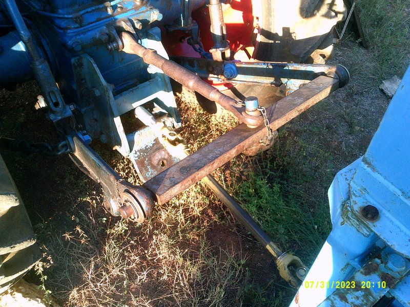

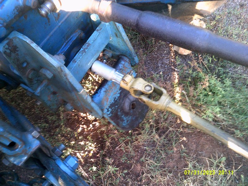

The intercep (see here: viewtopic.php?p=60364#p60364) is the same, and usually once a year as far as having to replace it. The compressor shouldn't cause hunting as it runs pretty fast compared to the PTO shaft, but it's worth knowing this. I'm not sure how we could find a yoke with the bolt to fit on the PTO shaft (the shaft we're using isn't actually very big), having said that we've got another much bigger shaft that needs a new yoke, but that is something we need to look around for.

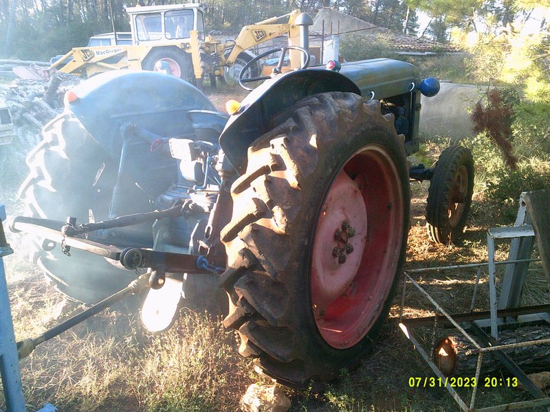

We've now tried it and we seem to be fine.
A bit smokey as we're so dry that we can't really plough much as it's loose dust and it just ends up just as solid as before, and it's not that much of a load for Billy anyway.
