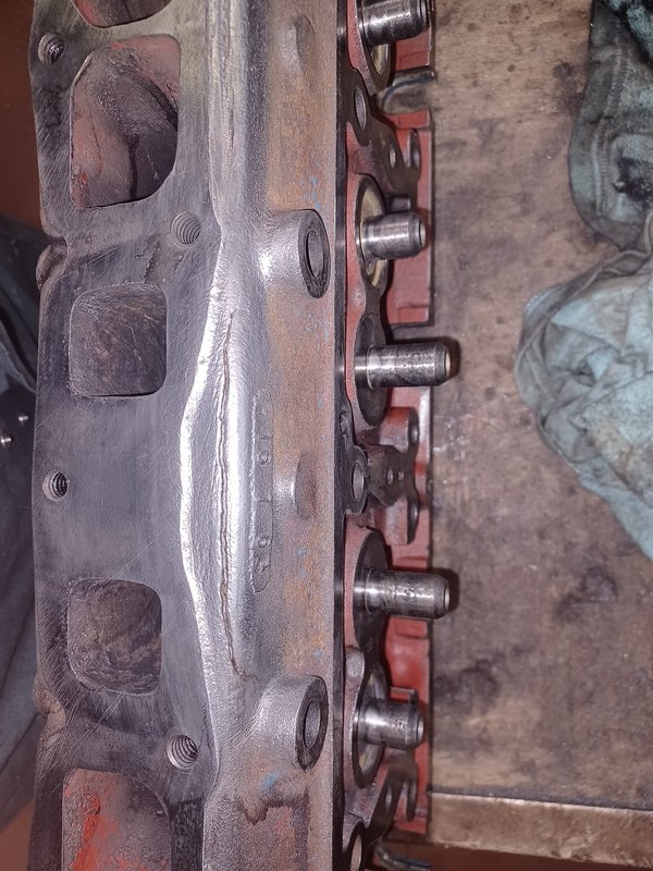

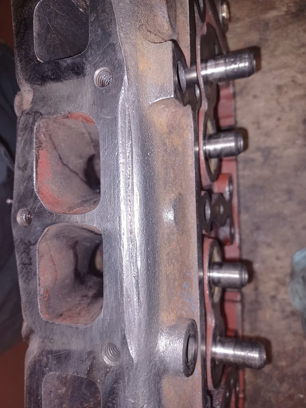

Since there were some frost related cracks in the cilinder head, it was time to get it fixed properly. I used some epoxy metal in the past, but no luck on that.
2 cracks above the manifolds
and one that goes around the bottom of front side
The head itself looks alright. We got the cracks welded and it is now to the shop to get it pressure tested, skimmed and the valves done.

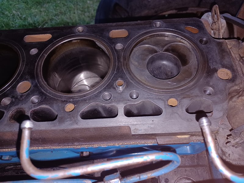

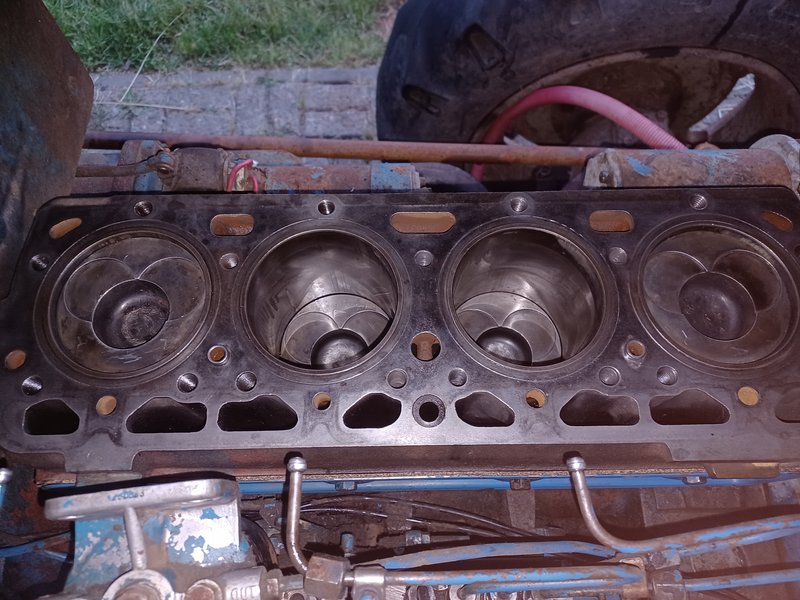

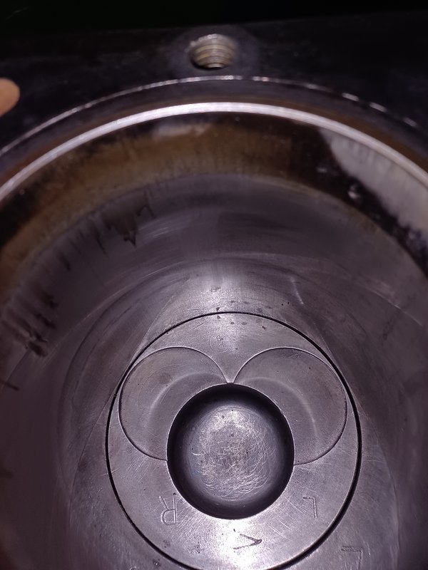

The engine is still in the tractor and could use some cleaning too
All cleaned up, I will juste leave the top of the liners.

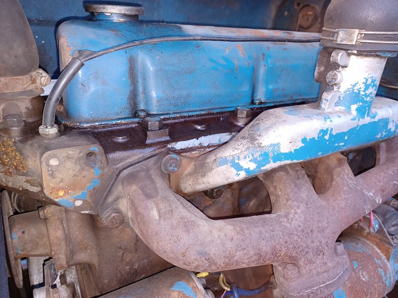

Re: engine head job
Finished the job today.
There is some oil coming out of the exhaust ports. I guess not much to do about this, unless fitting new liners and pistons.
video of the start
https://photos.app.goo.gl/NEJG2J4dkXtWAWgB9
What do you all think?
Posts: 2322
Re: engine head job
I think the oil will be from the overhaul, I wouldn't worry about it as it already seemed to clear in the video. I was surprised at how long it took to start, but maybe the injectors weren't fully bled. Everything looks good, I wouldn't have even tried to turn it over without the air filter, nor would I have fitted that thermostat but that's just me. Love seeing such good internal paint! Once running it's sounding pretty good, and it's nice to see the oil where it should be. I would see if you can realign the fan pulley, as it's quite badly off centre.
