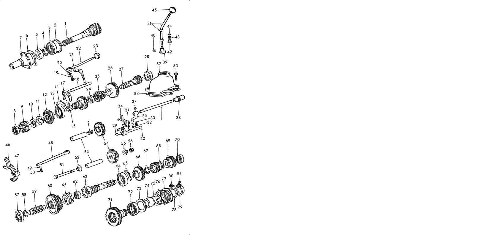

what number has the bearing on the drawing?
Re: Bearings for primary transmission
Sorry for the delay in getting back to you. I am using a different parts diagram, but the part numbers and bearing description I am looking for are:
R&M MRJA25 25X62X17mm Diagram Ref #9 Part Number - N 7118 D Qty = 2
3DC/V 25X?X17 Diagram Ref#68 Part Number - E1ADKN-7118-A Qty = 1
These are straight roller bearings with a single lip on the outer race.
I am trying to figure out how to attach the parts diagram image like Mathias did?
I think I'm using the same parts book as you (the 52-57 one in the FFCN) and as far as I can tell there are 3 N-7118D and 1 E1ADKN-7118A. Are you sure the measurements are actually metric? If so N-7118D is modern code N 305, as for E1ADKN-7118A I can't find it without the OD so see what you can find. The code on your N-7118D matches the sizes of the modern one, but I can't find anything for E1ADKN-7118A.
