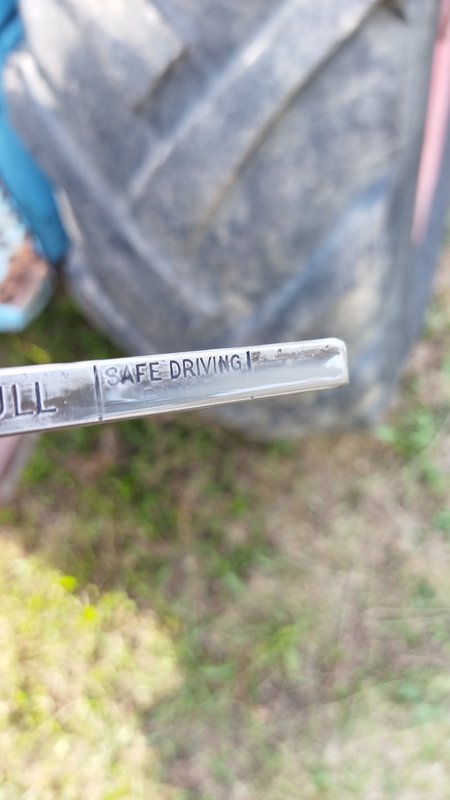

I had to move the tractor from the shed early in the spring because of roof replacement, since then it was sitting out under a tarp. Yesterday I checked the oil level in the engine after a short ride and i saw this:
It searched a little and it seems that coolant got into the engine oil? What would you recomend to do other than replace the oil and drain the coolant when not using the tractor?

I had a milky white dipstick when the tractor sat around for a long time without use and only started occasionally.
Drained the oil (well) and changed it, filter etc.
Not returned since.

The milky effect is water, but I see no coolant colour in there, so it might well just be water from outside has got in, if so inspect all seals (Billy was out in the open long before 2005 and he never got milky engine oil as far as I can and have seen) to avoid any allowing water in. If after that there is still milky effect and perhaps coolant colour in the mix check for the head gasket, liner o-rings and for cracks. Hopefully not any of the last two as that's a big job to fix. In all cases replace the oil, refilling with some intermediate stage (approximately 120-170 hours out of the 200 you would normally use it for to avoid throwing away new stuff, although it will be a better result with new oil) non watery oil for a flush of a few minutes running only (but only use the right kind of oil and never any that is from running-in or has other nasy stuff in it) before draining that out and filling with new. The reason I suggest a flush is that water is about the worst thing you can have in engine oil apart from dirt. In both stages allow at least overnight for draining. Running-in dirt is not desirable at any time, hence low hours on oil in rebuilt or new engines early stages.
