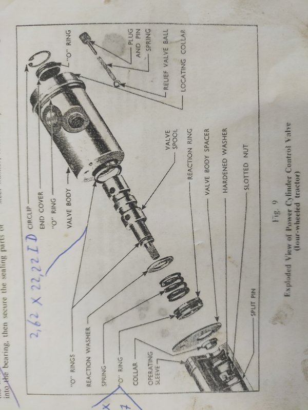

Top picture: topic is the O-ring next to the valve body, with metric size written by me in mm with blue pencil.
Second picture: where is the O-ring visible in the cross section?

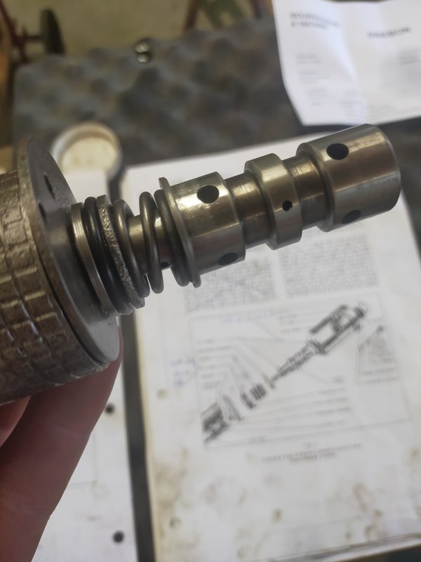

Third picture: valve spool with new O-ring (this is of course not the O-ring where this topic is about)

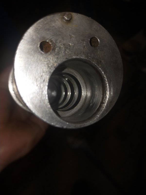

Last picture: bore of valve body.
Where should the O-ring be installed?

Hello,
I already replaced the O ring between reaction ring and the spool valve shaft where the reaction ring is zitting. I mean the O ring where my blue writing is on the first picture: where to put this o-ring?

I can't really see all that well, but there does seem to be a groove for the o-ring, a pic from the ram end of the valve body would be handy for that.
Sjors
Posts: 64
Joined: Tue Jan 28, 2020 2:46 pm
Re: question about O-ring power steeering cylinder
Post by Sjors »
Hello Sandy,
the ram-end of the valve housing consists of a circlip followed by the end cover incl O-ring to seal this cover.
According to the exploded-view drawing, the O-ring (the O-ring where this topic is about) should be installed through the bore end of the valve housing, not the ram-end of the valve housing. I can be possible the O-ring should be installed via the ram-end, but I never removed the end cover so if there should be an O-ring I never removed it.
The steering system worked fine before disassembly.
I'm not sure if you've read the whole section but it's well worth it, and this o-ring is meant to be removed from the ram end. The reason for showing it at the valve end of the diagram is to show what the o-ring seals, not the end to remove it from.

Hello Sandy,
so you think it is this O-ring?
I do indeed, if you don't have a spare o-ring for the end cover be really careful with it till you know you can get one just in case it's not available.
this is the inside of the valve body:
I see what you mean, it is strange though that you both have that on units supposedly made after the manual supplement from 59. An original manual on the power steering when first introduced would confirm this, as the wording in the I&T and in the 59 supplement suggest the o-ring was fitted to all valve bodies. Whatever the actual moment this change occurred at, if there is a slot there should be an o-ring in it, if not then look around for an earlier manual to confirm.
