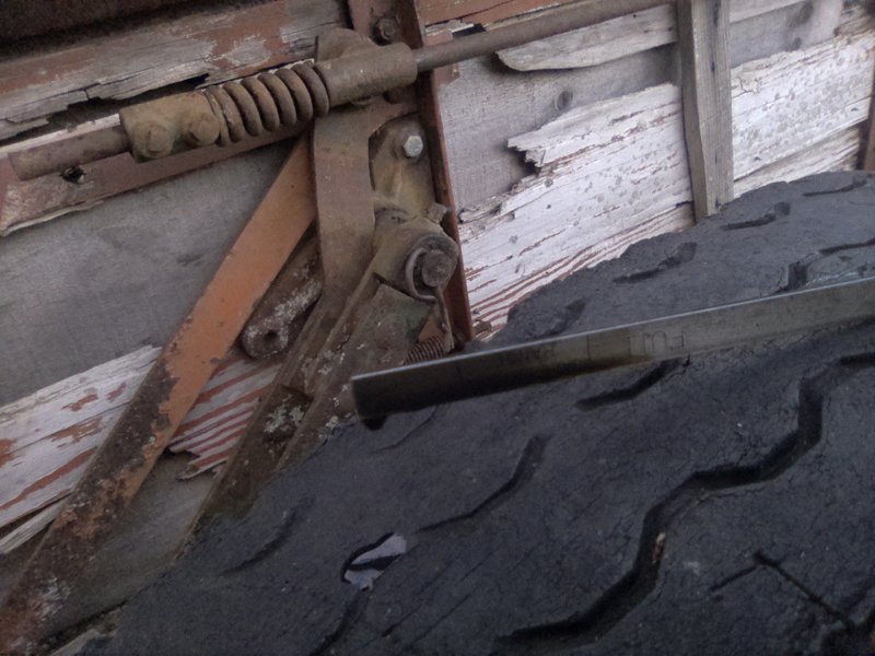

While puttering around on it I aired up the tires. I was surprised they held air. Then I heard a slight leak and the left rear tire popped and gushed out the calcium! Rinsed off tractor as best I could without running water.

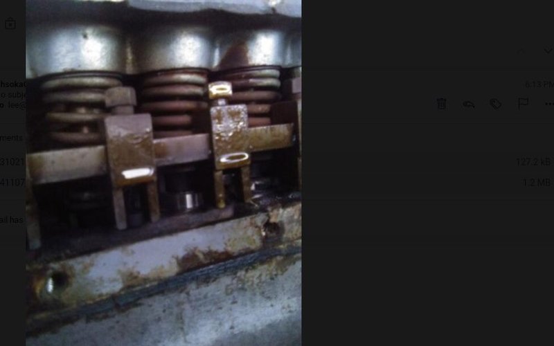

. I cracked drain plugs and there was no water in motor oil. I took side cover of injector and it was surprisingly clean and the rack now moves as it should.

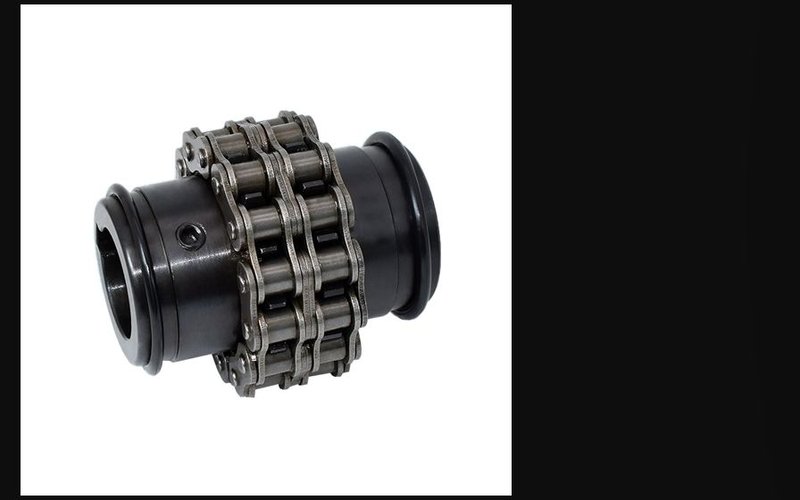

Then I ran out of daylight. I will get better pictures this weekend. This loader is definitely coming off. The coupling is two roller chains side by side and is very rusty.Hopefully valve train inspection this weekend..
The second picture is the coupling for the loaders front hydraulic post. Edit: too blurry.

I wouldn't be too bothered about that, I've seen others like it. As for the injector pump get a good bit of engine oil in there before you refit the oil and pig tail, therefore lubricating the pump. Diesel will bleed through but that's nothing to worry about. The pic is fine, I can see the chain and the wide pulley.

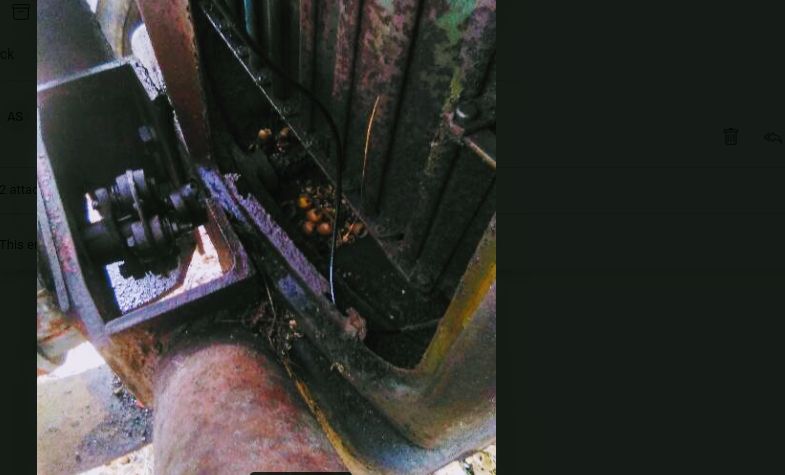

While down there I decided to isolate front pump from tractor.Seperated at the coupler and the hydraulic pump spins freely by hand.
The shaft that comes through tractor is rusted hard in hole of tractor frame. I'm trying to seperate it from crank side, just two bolts, but that piece is stuck on. Going out for some more penetrating oil.

That was a very sound decision. I've seen too many not taking such precautions with expensive results. Good to know that the pump turns well, diesel and oil could help a lot too for the drive shaft. Maybe that's what's holding the engine! The two bolts you mention are for the crank pulley remover, these became three further out with the narrow pulleys, and were also for mounting drives for hydraulic pumps and similar things as you have here.
Re: Next move for our 1954 Fordson Major Diesel
For some reason this Major has two couplings used. The roller chain on the radiator side, and the one with 4 bolts on the pump side.
I disconnected it on the pump side. It has soaked overnight, will see if I can slide shaft and hub forward away from pulley. It is really built up with rust around that shaft. I think with patience and lubricant we will get it. May be a sawzall involved too.

I don't think this picture shows how bad this shaft is rusted. Did not do much with the shaft. Spent time removing fenders and started removing loader.

I can't really see the rust, like the look of those radiator shutters. Those mudguards need serious work, and I can say from experience that you definitely want them. Repro ones are really bad and hellish expensive, and not having them is not great. Lots of welding there, it took us two months to fix Billy's one (posted about it at the time, viewtopic.php?f=2&t=8339).
Here is a better picture of the rusted shaft.
I'll be cutting it out and removing loader this weekend if all goes well. The drain hole by that shaft had been plugged up and I assume was what caused the shaft to rust so much. It is solid in the hole it passes through.

Sounds like a relief, pitty that shaft has had it but if that's all it's a very good find. Many shutters were removed and of those that weren't most are seized solid or badly corroded. Welding thin metal is difficult for experts, and as you see I can't claim to be one, hopefully your friend can help you if you decide to have a go yourself.
So I cut that shaft off and while trying to pry the hub off the pulley I got some movement! So I ended up prying on that chain coupler and got it moving a little bit in both directions. Was able to do same with fan blade. Slight concern that it felt no different with decompression lever up or down. Maybe a stuck valve? I think I'll get the valve cover off tomorrow. Started getting loader off today.
