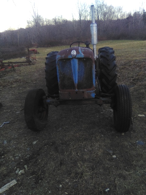

I've got some work on Daisy's spindle so "borrowed" her front wheel to replace the awful dual wheel that was on Hyacinth. I cannot believe how much better she steers and fits in the barn!

Great to see, I see the mudguards are still not there, I can assure you you'll find Daisy very different once her ones are fixed. I think you need better tyres on the front (of the sort on the wheel that came on Daisy's RH side, all of them would be better like that remember they're 7.50-16). I see the bolts for the extensions are not quite in the right place

Good eye to see the bolts on the extension are not correct. Good rainy day project.
Yes on the 7.50x16. Not sure if I posted it but somehow Daisy's front tires were swapped with the front tires on the IH 504 that we also bought. They were parked nearby to each other. My son noticed the two capscrews for Daisy's rocker cover were both stamped with the IH marker as well.
I'd like to find mudguards for Hyacinth but I have not been able to search any out locally.

You did post about the front wheels being swapped (that's why I referred to the tyres the way I did), I didn't know the rocker cover bolts were too. The reason I brought up the tyres is that your current ones will have far less grip making you have to use more steering brakes. The front axle bolts are quite hard work if they've not been moved for a bit so worth putting diesel and oil on them.

Front axle bolts are correct on one side of Daisy, but not other side. Bothe sides are correctly positioned on the Super. "Nora" or"Rose" are two names we have come up with.
