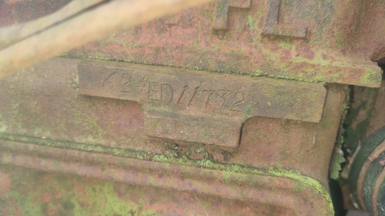

Wasn't planning on chopping 2 tractors into one just thinking id maybe rebuild the super major that is in better condition. Its engine may have been rebuilt as it is red oxide colour and has EDS stamped in middle of serial number.maybe a rebuilder mark. There is a few things in the way before I can get either out. There's a Bedford tl, a ford 4600, a landrover 109 and a few majors lying in the way!

Ive tried downloading image of serial number of super major hope it works!
Maybe someone can decipher serial number ?

Pic worked fine, it's a replacement 1964 engine. It came from a Thames Trader NC, the 624E being that it's a 4 cylinder diesel, the D being 1964 and then the number 11732 tells you how many 4 cylinder engines have been made up to this one for NC Thames Trader's, introduced in May 62 to replace the then ageing 500E/502E models (introduced in March 54 to replace the V8 and P6 variants of the same lorry, the ET6 and ET7). These lorries had the minimec from new, rather like the Super Dexta. The only difference between 502E, 530E and 624E engines of contemporary time is the front mounting plate, apart from the fact that all 502E were fitted with a pneumatic governor and all 624E had a minimec. Unfotrunately I don't yet have a monthly list for any lorries after November 61, so can't really tell you the month yet. Keep the pics coming, especially if you have other mixed up tractors.
