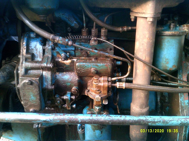

Folks,
Just wondering if any of you could provide photos or advise on the clamp the holds the stop cable in place at the fuel pump. Correct me if I'm wrong, but I believe it screws on between the pipes leading up to the injectors and prevents the stop cable from moving about and prevent stopping the engine efficiently when pulling the stop switch. Also, was a spring at the far end of the stop cable, also attached to the fuel pump in order to reset the pull to stop to engine running mode, standard issue or a later adaption?
Do you know where I would get the stop cable clamp for a 1964 Super, if that's the proper name for it?

Hi Andy,
Here's a pic of the original setup (minus spring; need to remove it).
There was some legislation specifying that the stop control when operated remained in stop position unless the operator returned it to the running position. Many people have subsequently fitted springs.

Thanks Sandy. Do you know where I could get such a part or if it's actually called the stop cable clamp? Can't seem to find it in any of the parts diagrams or lists 🤔
Re: Stop Cable Clamp
Your best bet is probably a breaker.
As for part numbers here they are from this parts book, minimec page.
http://www.lutje-ford.nl/wp-content/upl ... anual-.pdf
Bracket E782-CL-9
Clip EOTA-9792
A small bolt is also needed although hopefully the whole assembly should be on a scrap pump.
