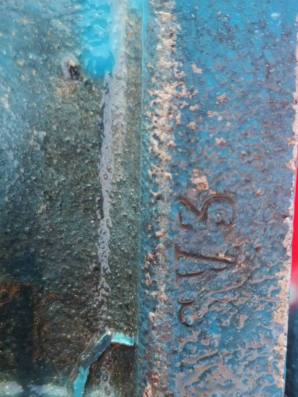

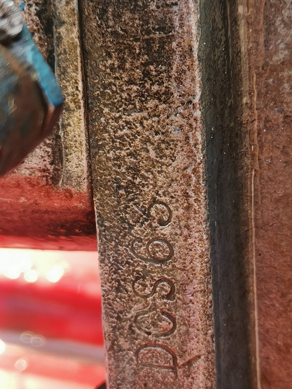

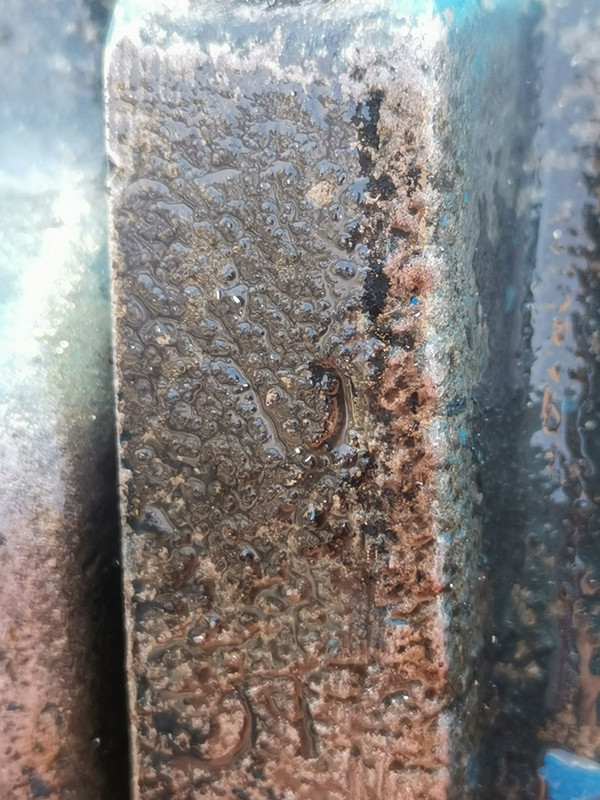

I found numbers engraved on the back of the pump. Not sure if that helps. I did not know to look at the inspection cover for number. My understanding hat been that there were two types, with gov. and minimec. I will look for that number. Meanwhile this is what i found on the back.

Changing delivery valves requires calibration, so better do it now if you're changing plungers already. Those two numbers I gave you are for pneumatically governed pumps, there are also two minimecs, P4588 for Dexta's (9.2 cc) and early Super Dexta's (11 cc) under Ford part no 957E-993101D, and P4696 for NP Super Dexta's (12 cc) under Ford part no 960E-993101. I've observed many stamped numbers on injector pumps but apart from pump serial numbers I haven't yet found out whart they are. Would like the pump serial numbers (on the cambox ahead of the lift pump flange) too. The outer races will be very tight too.

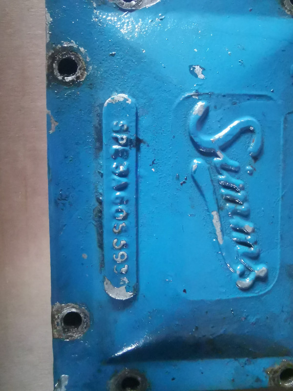

I found the number.

Sounds good. Did you see the markings on the governor springs? If they're long gone the free length and load at 50 mm and 43 mm would identify them too. I think most Dexta's have the 593, but don't yet know if the difference with the 402 is the governor spring or something else.
