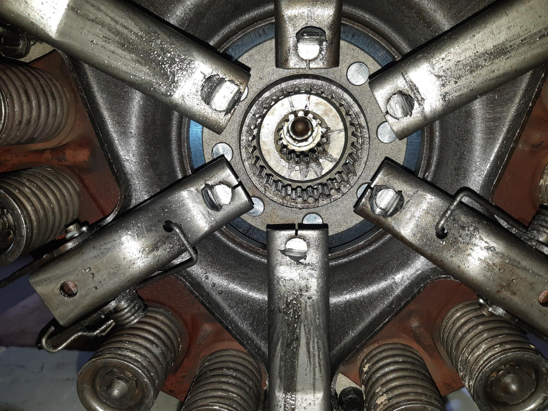

Great pics Illka! Shows the results of using the wrong parts

The post has vanished! There were 2 pics of a destroyed thrust bearing and adjuster bolts in a dexta clutch that lasted 2 hours after fitting the wrong bearing

Sandy, here are the pics Illka posted of the release bearing
Re: Length of Fordson Dexta clutch adjustment rod
Wow. That’s not good.
New lever screws needed too. What a disastrous bearing, it shouldn't be that difficult for them to make the correct bearing.
