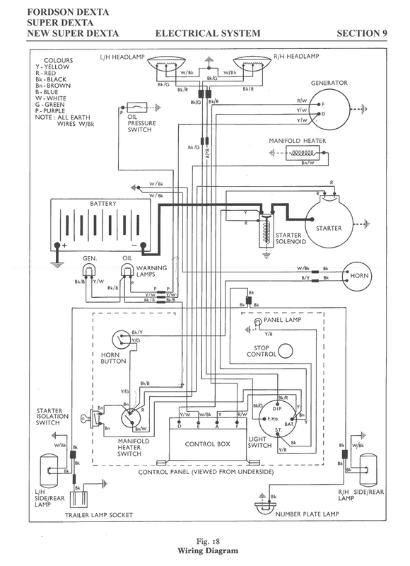

Re: Buying a Dexta special? in france
Great to hear that it runs again!
Here's the Ford wiring diagram:
It could have actually been dirt in the dash, I would definitely give it a clean but I wouldn't fiddle with anything now that it's working again, but by all means have a look. I don't remember a minimec hunting but it's probably best if you post a video like you did a few weeks ago. The other type of pump is prone to bad hunting as it has no damping valve like the Major does. A good service is always worth it, so after you do that see what happens with the hunting as well as running in general. 12.73V is a bit high for a battery (12.6 is ideal), but when charging it should be at 13.5-14V depending on the charger, even higher when the engine is running as the regulator is set to 16V roughly.

thanks for the diagram there, very useful.

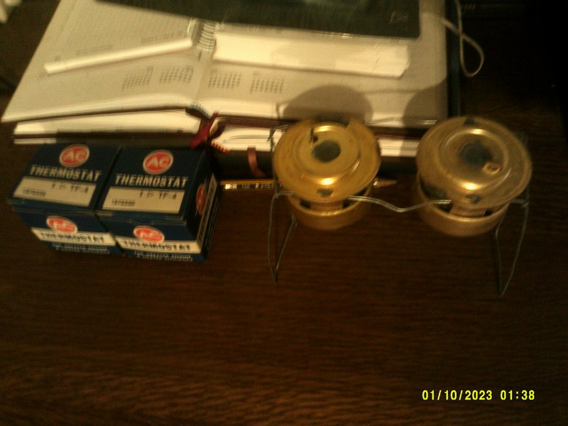

those AC TF3 thermostats are hard to find it seems. I see emiel posted one for 90 pounds from moss company.
I found a tf2 on ebay but that is 80c i think.
there is a good blog on these thermostats here: http://www.bobine.nl/jaguar/02-engine/t ... 0-and-150/ for anybody interested.
I assume it can only be the stuck open position that causes this. The thermometer was accurate to about 5c. hard to tell with laser thermometer because it can be inaccurate and can vary a bit depending on the colour of the surface you read from etc
Could I try putting some cardboard over the grill to see if it heats up? I feel this would be an easy test to do to see if the needle moves.

if you remember the new thermostat i put on it seemed faulty (weirdly working in water but not when placed onto the dexta)
highest temps i got on the housing was around 130F and around 220 - 230 on the engine block (hottest point being on the engine block under the middle injector)

The coolant gets to the engine at the lowest temperature, it then gets hotter as it goes through the block and then the head, being as hot as it will get at the thermostat and gauge bulb before beginning to cool from there till it gets into the engine again. I don't know what's the matter with the temp gauge, as it seems to be doing very odd things.

1st issue around starter: Tightened connection on top of solenoid. The connection that goes to the positive terminal of the battery (mine is neg ground/earth) worked loose. Probably because the battery is not strapped down and moves about a bit. I have some straps I can put around it which I will do to ensure that is minimised. Looking at the old starter solenoid it was the same pole/terminal which had become loose so I am guessing that is something to watch out for if your battery can move about and a point of possible failure. The old solenoid terminal moves if you wobble it. This lucas one needed the bolt tightening to remedy the play.
Another issue of the cranking cutting out after engagement seems to be this Lucas solenoid has a sort of spade connector rather than bolt for the 3rd smaller connection and the the throttle linkage that passes by that area could make contact with that connection depending on which position the throttle lever was in. As a solution I bent down that spade connector to ensure it would not come close enough to contact it and placed some electrical tape around the metal connector and a little around the throttle linkage/bar where the solenoid is. I went around tightening all the connections from battery to starter. Cranking become more reliable and sounded better.

And yes the temp probe is puzzling, need to get that sorted. I presume as long as the laser thermometer reading around thermostat housing near to the where the thermometer probe is bolted on should never read above 160 - 170 F if all is well. The reason I check around the injectors is because I worry that the somehow there could be a chance that the cooled water is not flowing through the engine block as it should and is mainly circulating through the radiator, water pump and back into the radiator, therefore not doing the job of cooling the engine block as it should. I think it's unlikely looking at how it's all plumbed but without knowing accurately what the water temps are it is hard to tell. Either way having to use the laser thermometer and checking it every 20-30 minutes is tedious and it needs sorting for peace of mind. Thats high on the to do list and will look at it ASAP.
