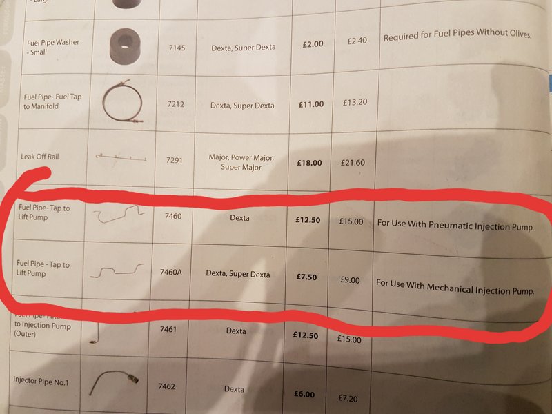

Re: fuel line???
Post by Scoobynorm »
How do i know which one i require,
Posts: 2502
Re: Lever on injector pump
You have a pneumatic governor.
