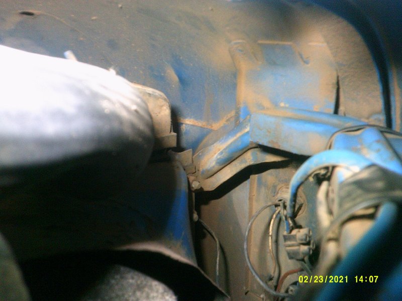

Hi Buzzer,
Firstly I must say that my nose cone had a transplant, the top section is of the original Super Dexta and the bottom section is of the Dexta. A bit of a messy job but serves my needs
Hence my pictures and hope they are clear to you, I am not sure if the radiator support brackets are meant to be bolted onto the two extensions from the top of the thermostat housing, I'm also doubtful of the fixings to the radiator. Hopefully someone can correct me. My other queriy is does the nosecone bolt on with the same radiator brackets. Whilst I am at this point I thought we may both learn something from the clever guys.
Regards
Mervyn.

Re: Super Dexta 1963 radiator support help
Hi Bazzer, absolute pleasure.
I did have my nose cone on the tractor the other week but with out the little brackets that bolt onto the radiatora. I could for some reason not work out how they fitted. What I did was to slip the two bolts that can be seen in the pic of the nose cone into the slots of the two brackets on the themo housing and fastend them up.T he nose cone was very secure and the radiator filler held the radiator very firm. I will be attempting to bolt the nose cone, radiator support brackets to the brackets on the themo housing and see what success I have. If there is a correct way please can we be educated.
Regards Mervyn.
My earlier pics show it fitted. If your donor Dexta section is after April 1962, it should be a straight swap as Ford tried to have as many common parts as possible.
Unfortunately my Super Dexta section is off a 1963 tractor and the bottom section off a 1961 tractor. I appreciate your pics you posted, I cant quite identify the fixing arrangement and wondered if you could possible take a pic of the actual nose cone and radiator attachment to the brackets off the themo housing. As I mentioned in my first post the transplant was a bit of a mess.
Mervyn.
Okay Sandy, having studied your pics again I think my idea of fixing all the components togetheris similar to what you have done. Once my nosecone is fixed I will take some pics and post.
