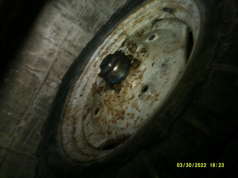

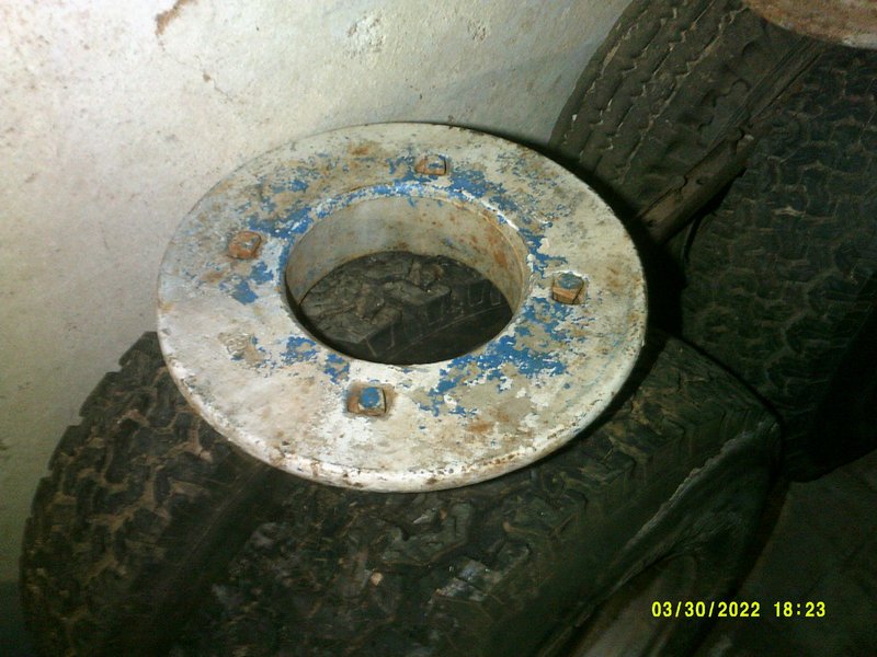

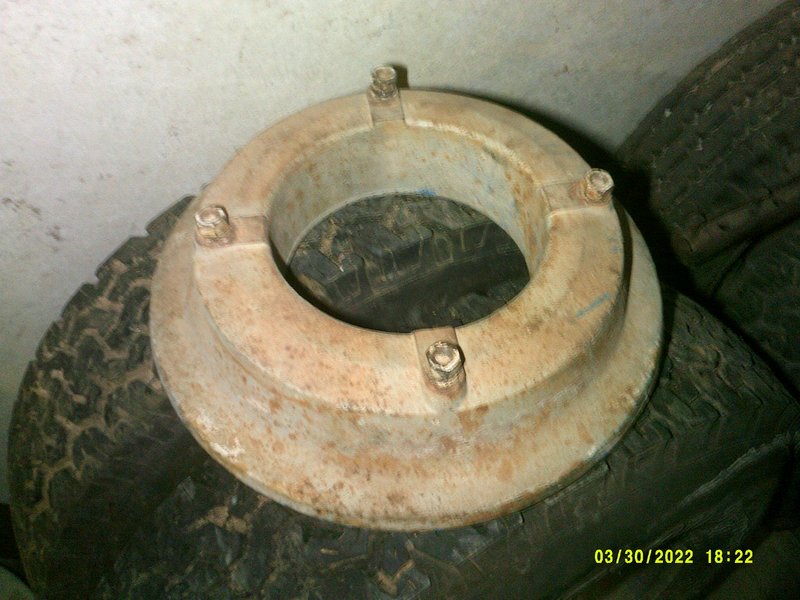

This is Super Billy, but it's the same for a Dexta. I'm afraid I can't find a pic of them fitted, but if you look for the Ford film in which the Super Dexta was introduced you'll see the weights in place. You can use any bolt for mounting them, but the original ones will ensure the best fit.

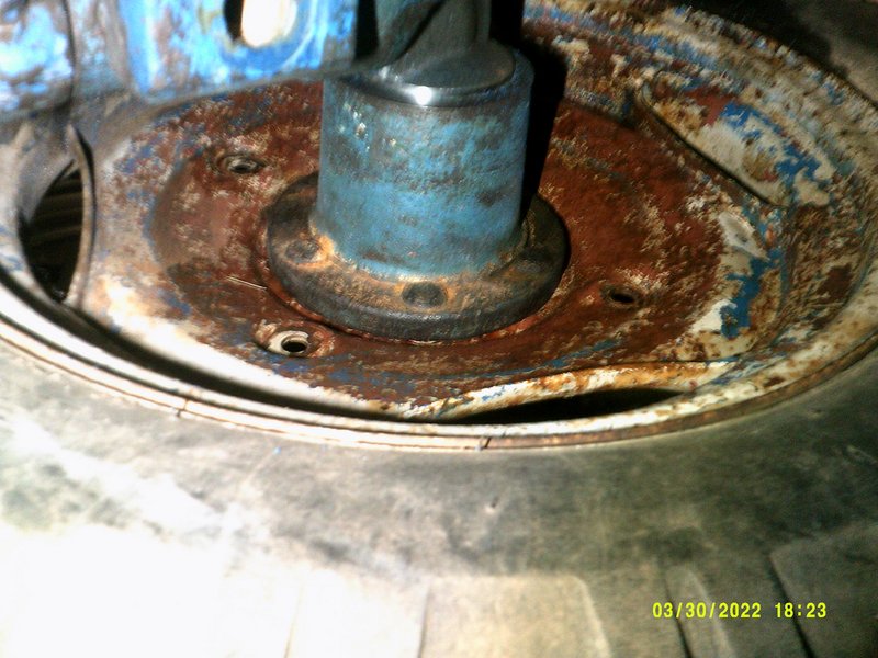

Thanks for the Pics, much appreciated. My main query is when the wheel centre has four square fixing holes and the weights have tapered square recesses how will the bolt be tightened. Can only assume the bolt head is a tapered square and the squares in the wheel centre are not functional/relevant?

The bolts are part no. 23108-S43 for weight part no. E21-HA-9. I would say they're sqare headed bolts 1/2"-13 size like Super Billy's ones. I don't know why there are square holes in Dexta wheels and also the 7.50-16 Major wheels.

The reason for the square holes is that carriage bolts were traditionally used for wheel weights, the holes are 1/2 inch square, same as the square section under the head of a carriage bolt so they can be tightened without the need to hold the other end
