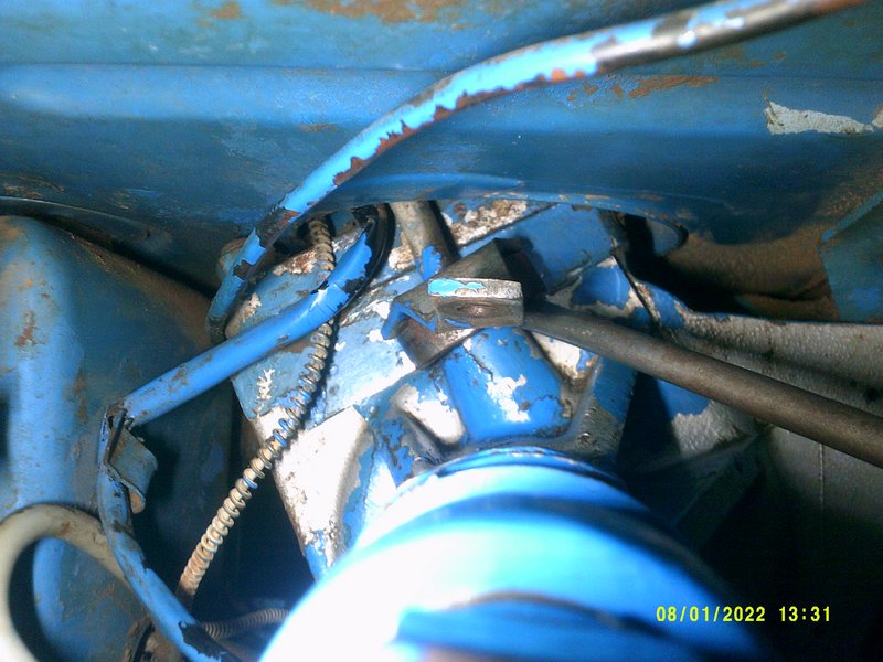

This is a problem Davie has had for ages, the plate brazed on the throttle shaft on the steering column has come loose, meaning that operating the throttle is awkward to say the least. We're about to fix it, but we don't know the correct angle between the plate and lever (later type shaft with Woodruff key, part no. 957E-9807B). Does anyone know the correct angle between the lever (or keyway) and the rear edge of the plate?

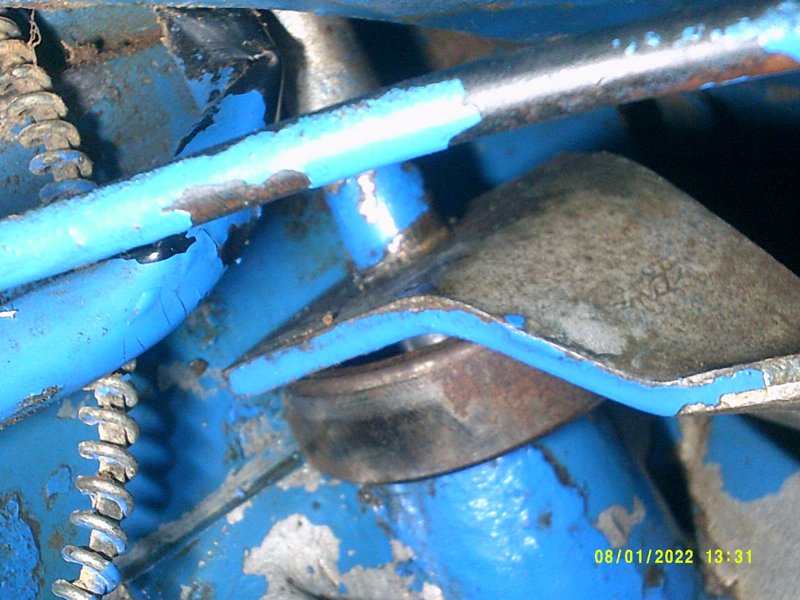

I've ended up finding the answer without seeing another shaft (after a good clean), the break is very clear and the plate only fits properly in the right position. The lever is 2 or 3º anticlockwise from the plate (I need to measure this properly). Pics to come soon.

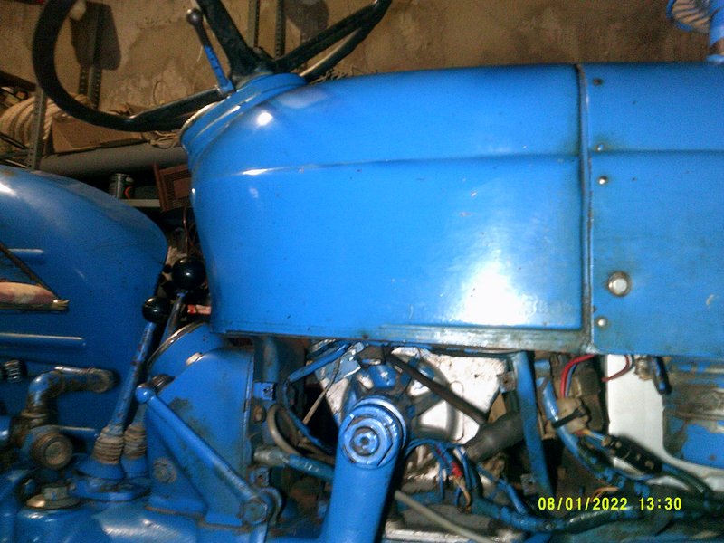

Here are the pics
Thu Jul 28, 2022 11:49 pm
The lever is actually 5º anticlockwise.
