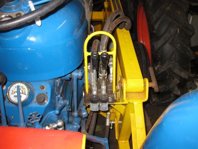

Post by jambug123 »
i run my loader off a spool valve block on them you have oil in from the auxillery service, loader , return to back axle. then you just have the Tractor auxillery service running the valve block and set the lever to constant pumping.
I was thinking of changing mine to a hydraulic but i prefer the trip.
Regards
James
Nevis
Posts: 77
Joined: Sat Sep 20, 2008 1:49 pm
Location: Shropshire UK
Post by Nevis »
My loader is set up in the same way as James - I have 2 spool valves and have added a tip cylinder for the front bucket. I have also welded some brackets to a 3point pallet fork so can use this on the front of the loader. Having the tip cylinder makes these forks extremely useful
Andy

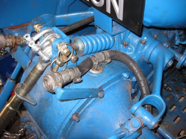

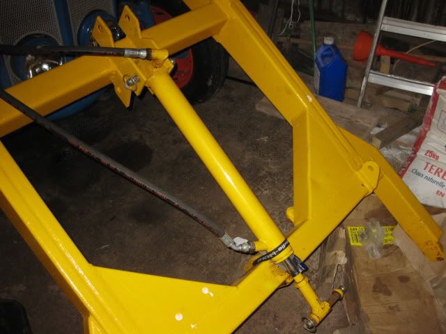

Nevis
Posts: 77
Post by Nevis »
Some photos of my Horndraulic loader piping

Nevis
Posts: 77
Post by Nevis »
I have a log splitter which has its own spool valve and which I use a lot - if you look at the 3rd picture the pressure is coupled to the quick release furthest away and the closest quick release is the return which is T'd into the back axle filler - the other T is the return from the front loader spool valves.
The pressure connection is connected to the auxiliary output which is also T'd to the loader. In order to use the log splitter a I close a valve on the auxiliary output which diverts the fluid to the log splitter. I cannot use the log splitter and loader at the same time.
Andy

Post by Ambidextarous »
Andy, you've got the same set-up i was thinking about. What's the furthest coupling for, a tipping trailer?
Steve.
Nevis
Posts: 77
Post by Nevis »
Originally the furthest fitting was only for a tipping trailer (ie a single acting cylinder on the trailer) but now by putting in the return to the back axle it can provide a continuous flow to a spool valve on, in my case, a log splitter.
