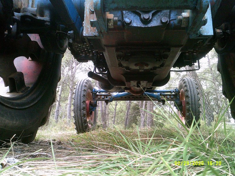

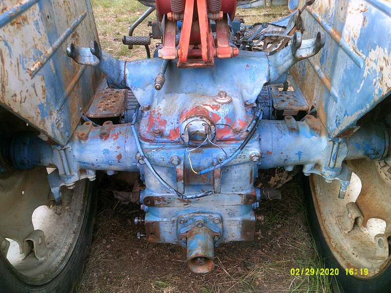

Just found another pic (an old one) of the bracket (Heavy duty type).
Note the bitsa check chain, the location of the rear axle casting code and the wrong lower link (the original one's ball comes out, hence the large washers visible in other pics of Billy).
