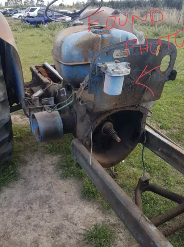

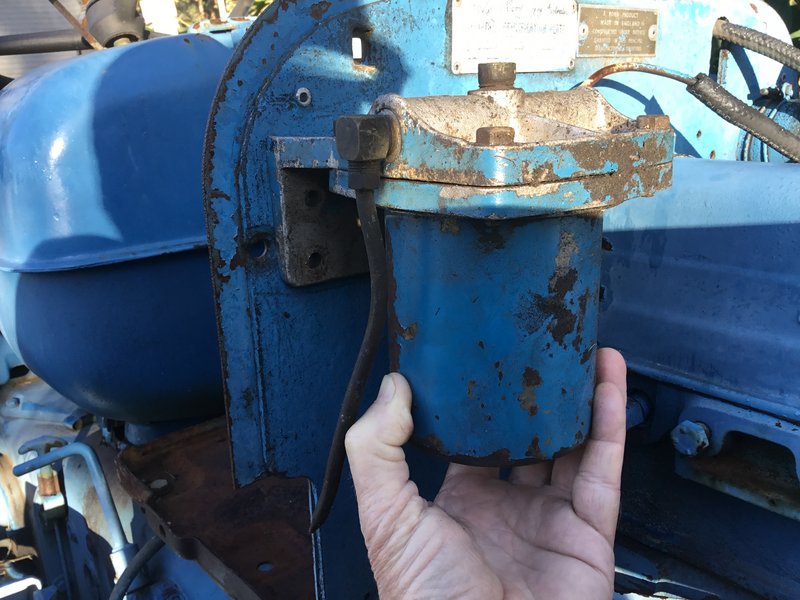

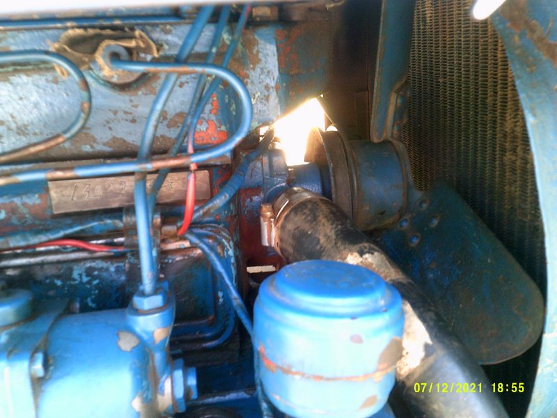

Thanks again. I found another photo for the other oil filter. I put more photos up. I’m not sure where the lines will go too. Any help appreciated. The regulator does mount at back of air filter. Thanks. I’m still waiting for parts to come and still no parts from original owner. I’m thinking I might just buy a new dynamo with pulley. Does anyone have a photo or part number of dynamo? And would this tractor have a 4 or 2 blade fan? And would anyone have a photo o the timing cover breather thing. ( photo of thing with a tin can on top) Or can we buy them as well on line.

The extra filter I think sits between the tank and lift pump, from there on it's the std. arrangement. The dynamo is a Lucas C39 type, but if you look for Fordson dynamo you should find a suitable one. The fan was 17" in diameter, if you're in a hot area I recommend a four bladed one (two two bladed fans bolted one on top of the other), but a two bladed fan will be fine in lower temperatures. Breathers are available, but there are two kinds, yours is the early one and this is what it should look like. (this isn't an original fan)

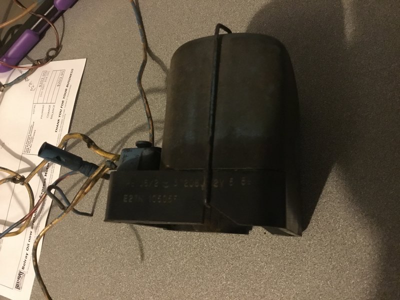

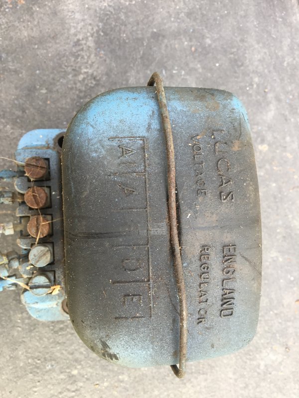

Hi, I’m trying to find out if my regulator is a 11amp or 22amp as apparently there are 2 dynamos. How do you know? The only writing is on the top of cover. I put photo on link. It says. ( LUCUS ENGLAND VOLTAGE REGULATOR )
A1/ A / F / D / E
I’m guessing the letters are for where wires go? It has 5 terminals at bottom.
Thanks in advance

Hi, I found codes on side off regulator: RB106/2 37206J12V 5 59 E27N 10505F. On line says it’s 22amp. Can someone confirm thanks. I put photo up on link.
Dave
Re: 60 farm fordson major diesel
The dynamos up to 1962 were Lucas C39 variants, with screw terminals, from 1962 they used the C40 variants, with spade terminals and a higher output. So you need a C39 with screw terminals, if you can find one sold as a Fordson one you'll ensure it's the right kind. If you need them I'll get pics of ours as we have both kinds. A1 A F D E are the terminals, to get this right we need the early Power Major wiring diagram which is not one I've found so far, but the Diesel Major diagram will do for some of it, as will the later diagram with the sealed regulator (in that instruction book I sent you earlier).

Hi, apparently you can tell the difference in the 2 dynamos. The 11amp is a closed back and the 22amp is a vented back. I sent the numbers on regulator to a tractor place and they also said that it is compatible with the 22amp. Hey Sandy, interested to see if the numbers on your regulator are the same and if back of regulator is sealed or vented.

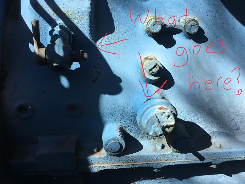

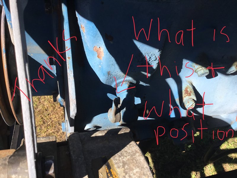

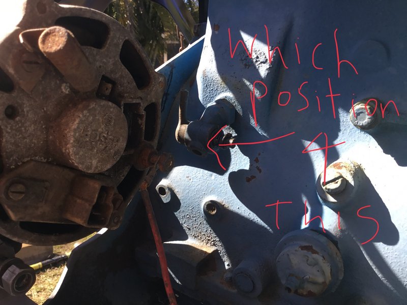

I have put a couple more photos up of things on the left hand side of tractor. Near dynamo. One just looks like a fuel switch ( what position should this be in? And the other behind dynamo looks like it has a thread on it, maybe oil pressure. Any help

The cock below the dynamo is for draining the block coolant, if it's parallel with the outlet it will be closed; and the other one is the oil pressure switch for the green warning light in the temp gauge. The fan belt should deflect 1/2" between the fan and dynamo.
