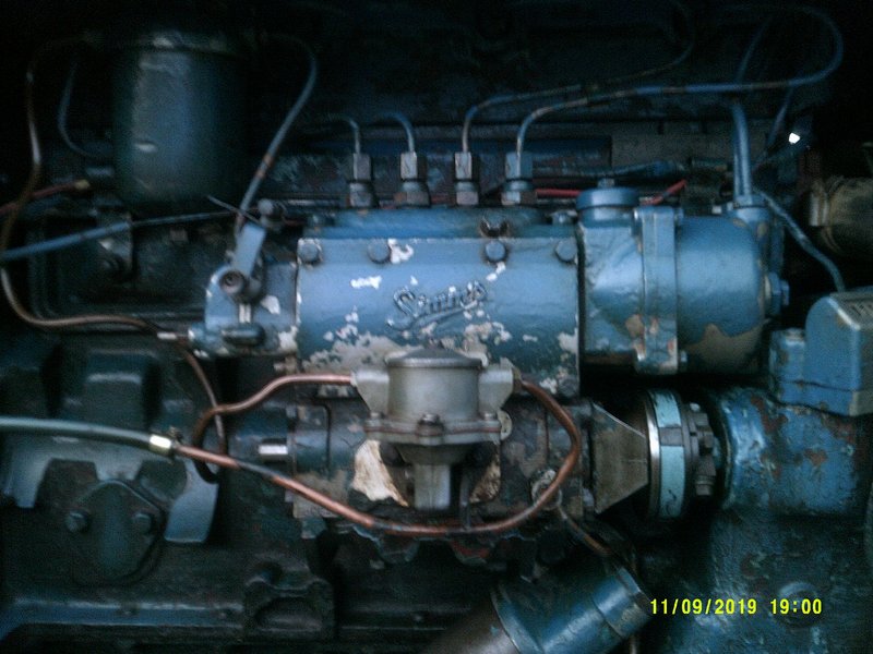

I’m trying to prime diesel filters and pump, but pump with glass bowl doesn’t seem to be pumping. still waiting on 1 pipe. Have you guys put kits in them or just replace with new? And just want to confirm bits on the injector pump. I think the oil fill is to the brass nut halfway up pump. The cap on top is just a breather. And not sure if drain is supposed to go somewhere? I’m going to try wire ignition switch but the switch only turns on so I am removing the horn to put a 19mm push button start switch in its place. I tested the starter but not enough to turn motor over as I didn’t want it to start. It does work. I’m just going to grease bits and pieces and WD40 all moving parts to free up stuff this week. And hopefully parts will come.
Thanks again
Dave
Re: 60 farm fordson major diesel
Hi Dave, if the lift pump (with the glass bowl) isn't pumping it could be the gauze filter inside is blocked, have you stripped it and cleaned it? Or the diaphragm inside could be knackered, you can get kits for them. The cap on top is indeed a breather for the vaccuum throttle. The brass screw looks like it has been added as an oil filler and the pipe on the bottom is the oil level. It should have a 'pig tail' pipe on, a metal pipe with a loop in it to hold enough oil/diesel in the loop to stop dust going back up the pipe into the pump. It should only need oil in the pump when you first get it going (engine oil is fine) when it drips out of the bottom pipe its full, the pump then relies on diesel to lube it which is the leak off from the delivery valves in the pump, although it doesn't hurt to add oil to the pump when you service the engine
Pipe wise you'll be better with copper pipes as per original, they'll be less likely to leak and easier to keep separate from one another. John's talked you through the injector pump, I think some oil will be good too. Your starter isn't original, the original one was lever operated with the solenoid near the battery. I would rig up a loose button for now until you can get an original one, leaving the horn in use.

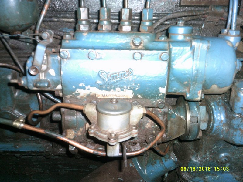

Copper pipes would be good, have you got a pic of the pigtail pipe Sandy? So Dave can see what should be on the bottom of the pump
Here's Billy's pig tail.

I ordered a new pump but I will pull down old pump on the weekend and check it out, I will also see if I can get copper pipe made up for bottom of pump. How high up the coil on bottom pipe should End stop ( I can’t see end in photo)
Thanks again
Dave
I think it's 1 1/2", but I'll check tomorrow. That isn't too important though, as long as there's a coil sufficient to hold fuel and oil there you'll be fine, as that will keep the dirt out.

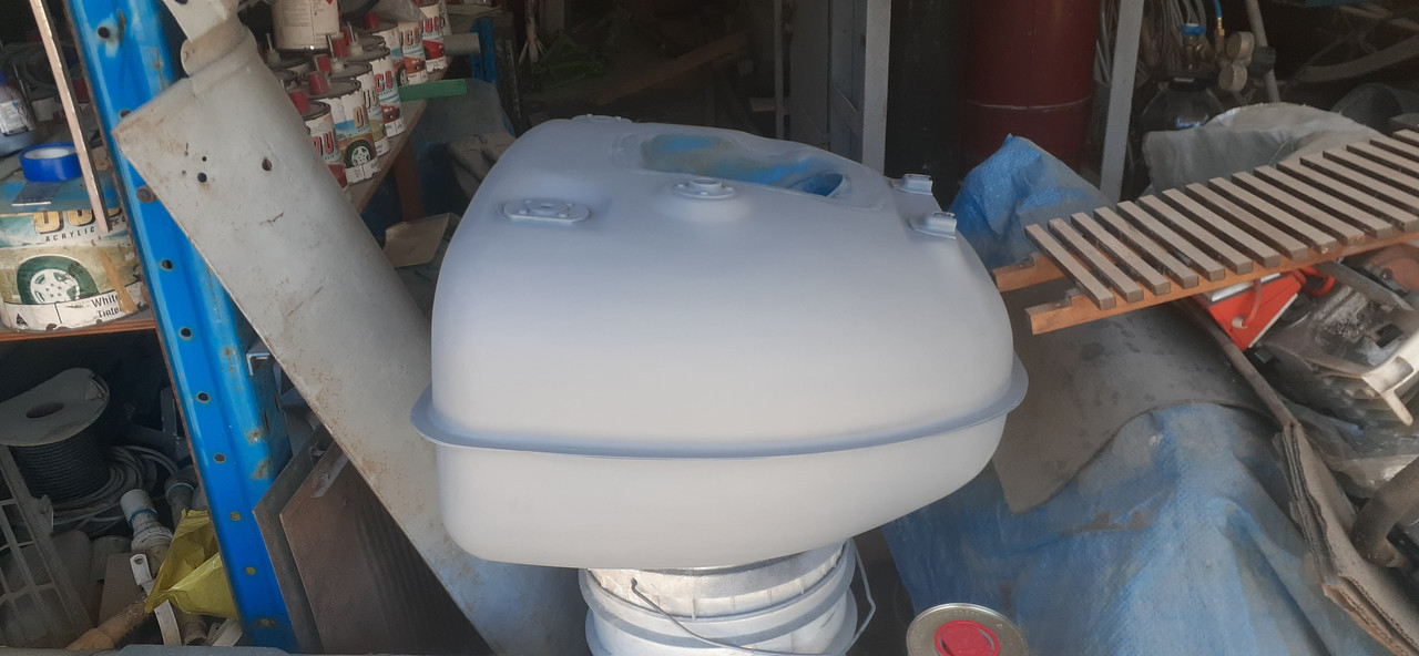

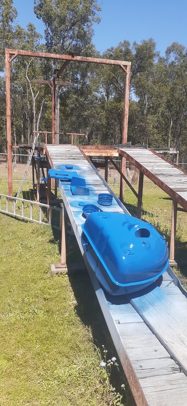

Hi guys. Been busy working on the tractor. I found a couple of leaks in diesel lines. It was leaking air from line that screws in to lift pump. And line that screws into diesel filter. I'm waiting for some new ends. Also found a hole in bottom of tank which had a tec screw screwed into it. I have cleaned the diesel tank out and welded the hole up and at the moment stripping tank and all rusted bits around battery tray and air filter. I have a blue shell bath that I mix 50/50 white vinegar and water and soak the parts over night. Gernie off with high pressure. Removes rust very well. Not so good with paint but if you keep scratching the paint up and put it in multiple times it will also remove most of paint.ill put some photos up shortly.
[![20210906-103205.jpg](https://i.postimg.cc/XqHXTqQg/20210906-103205.jpg)](https://postimg.cc/8fv1vp8F)
Looks good, I would have left the paint on so you still have original paint. Try and find rigid metal pipes, as flexible ones suffer badly from many problems.

I'll try and hunt down the rigid pipes. I'm just trying to use bits I can get or have. I tried to fix a couple of dents in tank but it has been painted over surface rust. I'm a spray painted by trade so for me stripping is better. I repaired a few items and etched them up today. Slowly but surely.

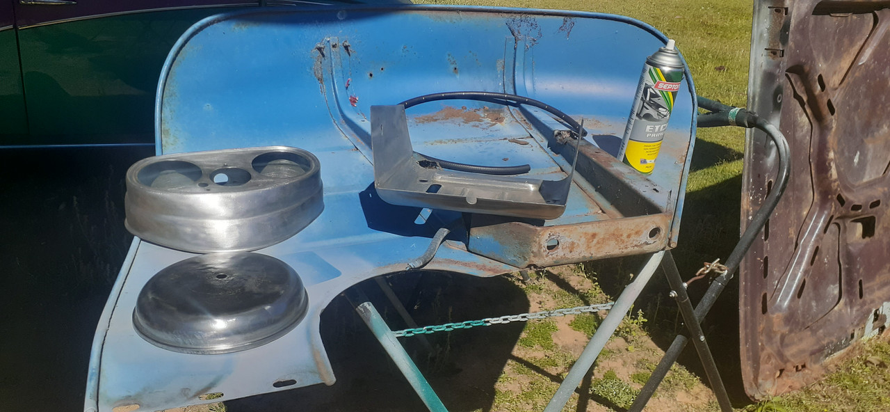

Insides painted on some bits today.
Looking good.

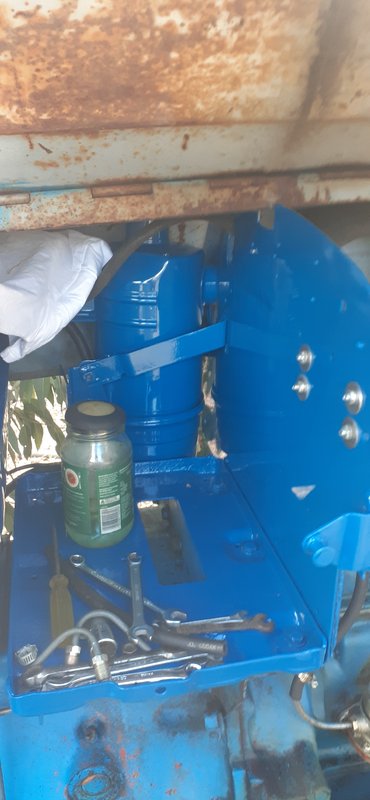

Outside of bits done today. I wasn't going to do too much on it but am taking the opportunity to show my lad how to do some rust repairs on it. Guards and nose cone next. Beer a clock I think. :beer: :beer:
dark souls 2 wallpaper
Looks good.

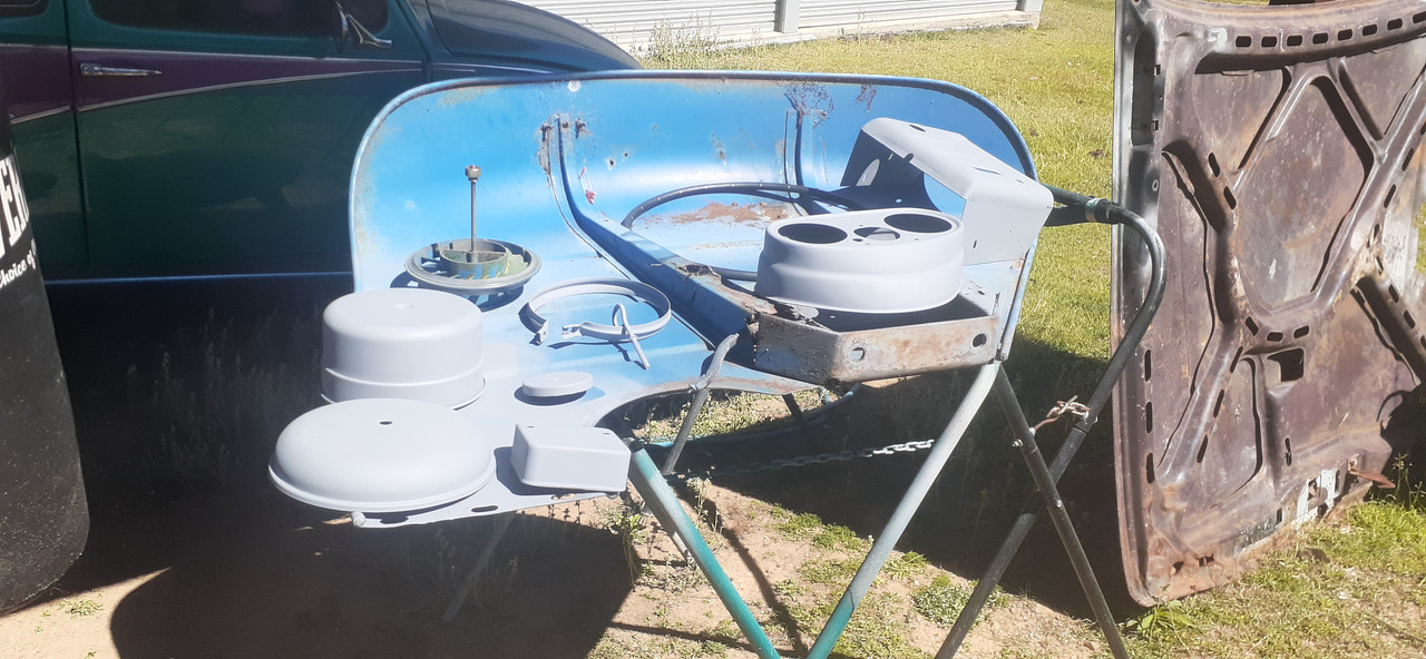

Put a few of the painted parts on.
Looks good, hope you can get running soon.
