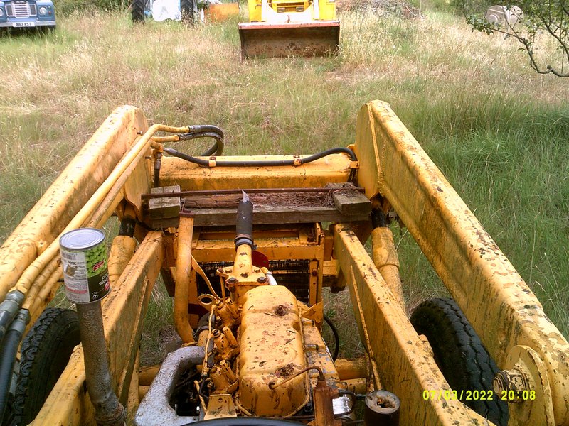

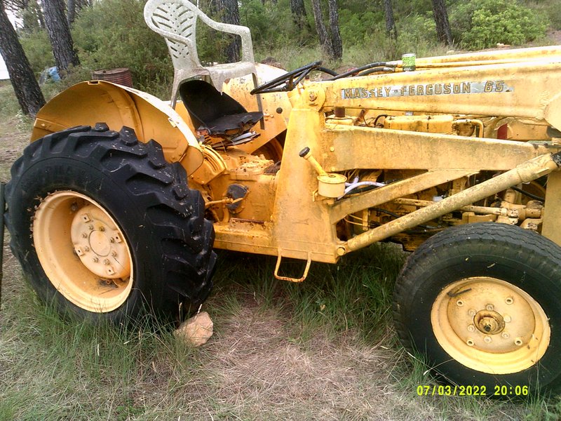

Here is the MF before we removed anything, we fitted the exhaust and covered the intake hose connection to keep dirt out, then tried to shift the injectors before first posting about it.

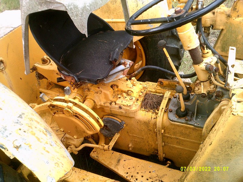

The chair over the seat is to keep resin off the seat. The seat came with the half Super Major.
The jack is a prelude of things to come.

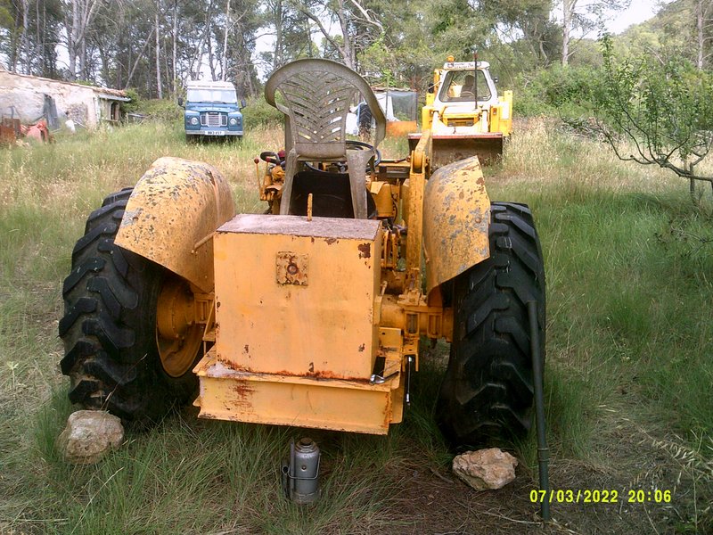

Counterweight off.

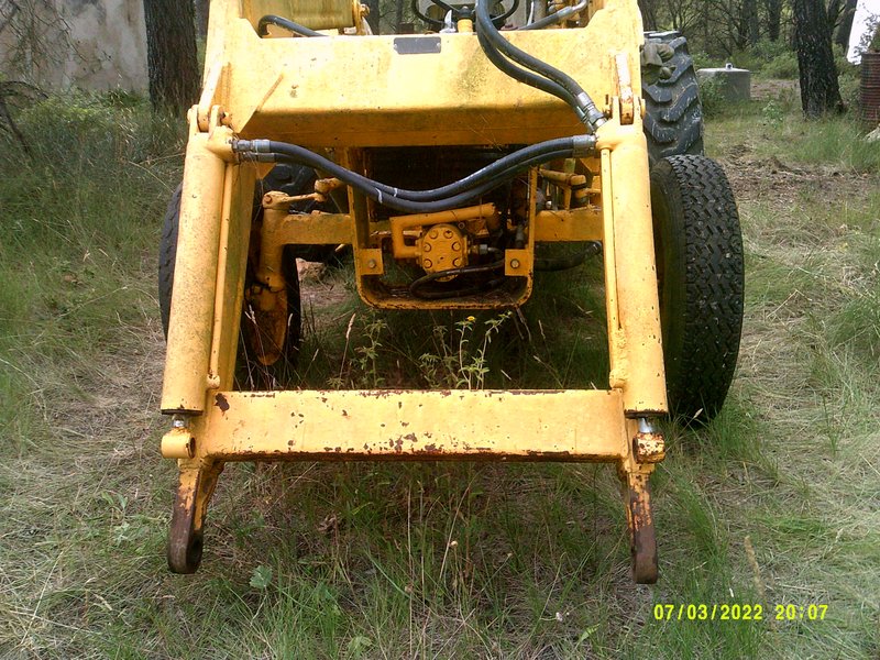

Loader off.
Mr MacGregor holding the loader before putting it where it is now.

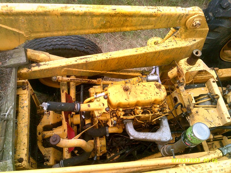

RH frame off.
The only other bits we have are the fuel tank and fan cowl.
