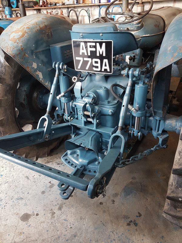

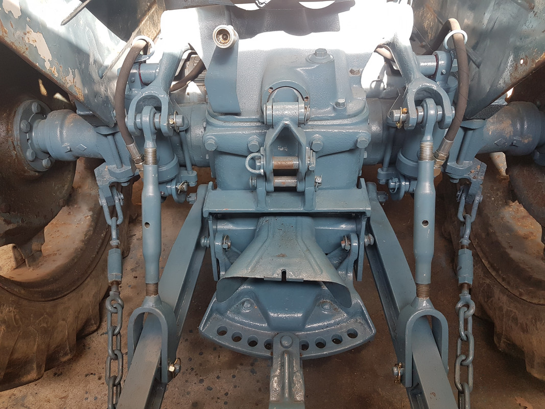

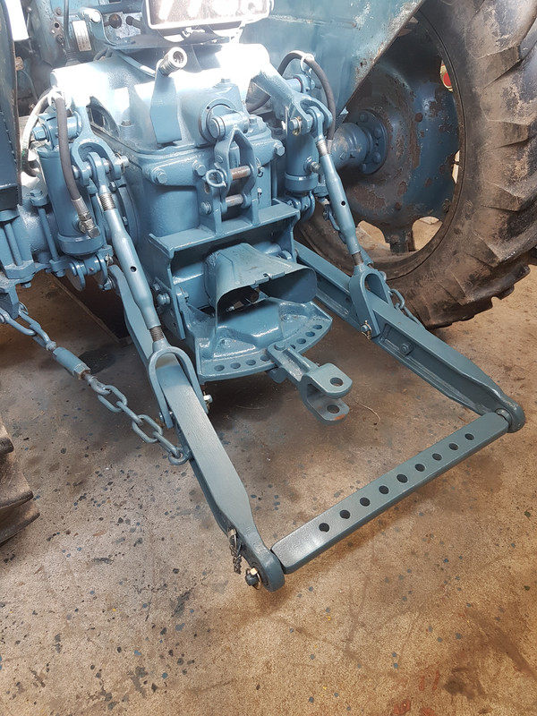

Well finally the least techno minded person on here managed to upload some photos of my Heavy Duty lift linkage I have built up on my Super Six. All based on original lift linkage but modified according to measurements taken from an original kit I was kindly allowed to measure. It is as accurate as you can get including the rams which I had to have made having exhausted the UK in my search for any! A Labour of love
